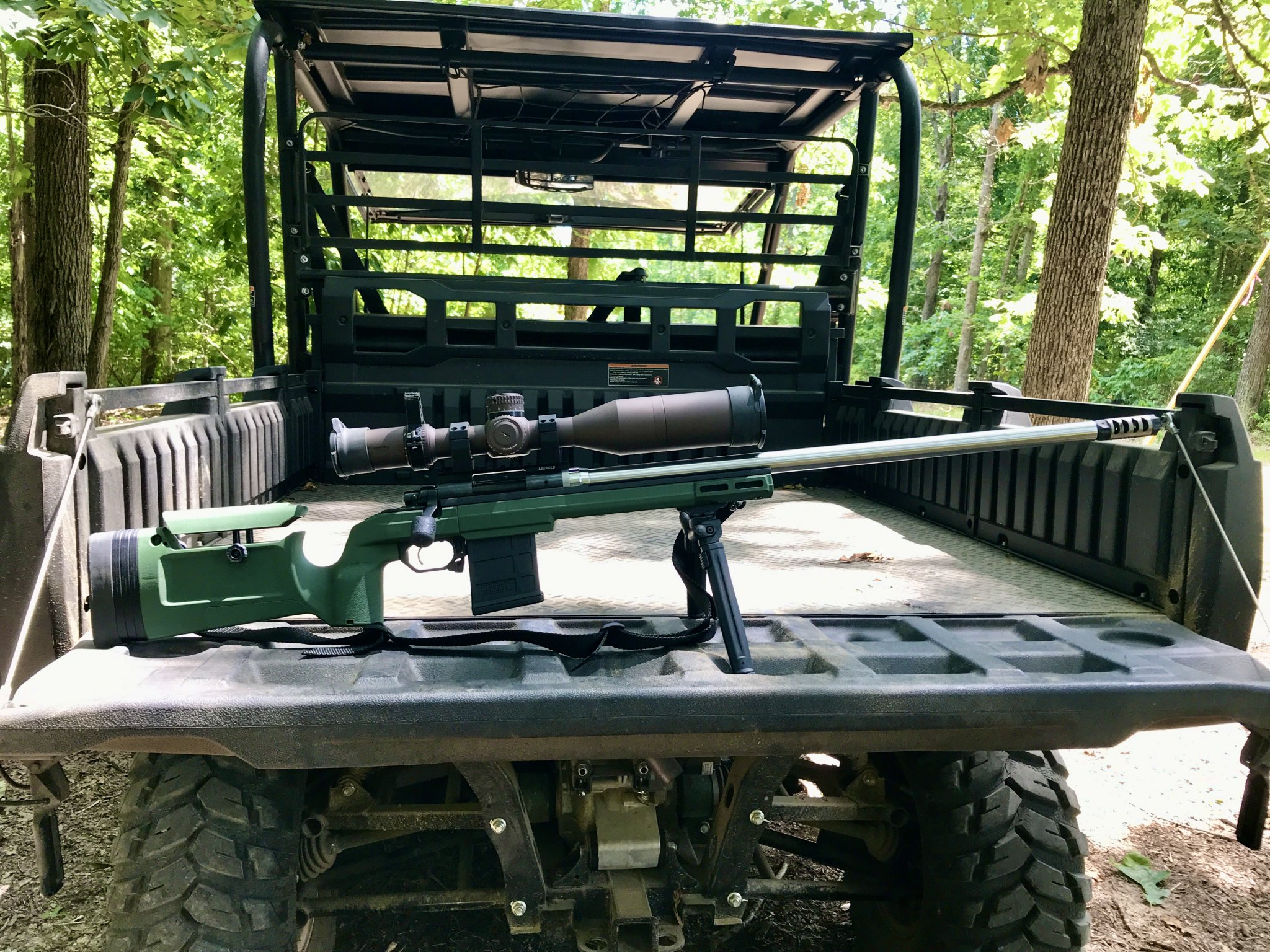

6.5 creed is the easy button . I built one on a 700 short action . dropped it in a krg bravo stock and it runs p-mag aics mags with out incident . I used a remage barrel . 6AC07702-F8FB-4952-8C46-BD36697ABB03_1_201_a.jpeg
Big thanks for the info on 6.5cm. I had initially looked into it because factory ammo as well as brass and projectiles are plentiful, but was worried the cartridge OAL would be a little to long. Now I know it will work I am interested in the 6.5cm
