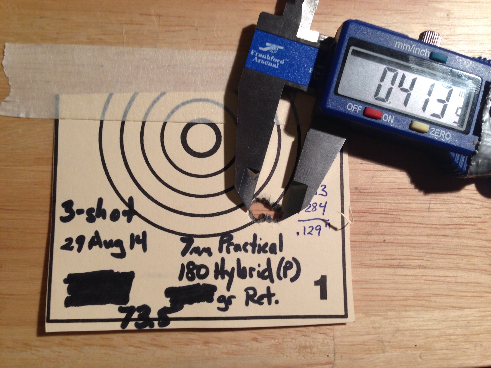

I had about 80 of the cases Josh had worked on in my stash so I started over with a tub of Retumbo trying to find a sweet spot for this beast. I loaded up a pretty good ladder test for these test rounds, but with how much work I've had this summer, I haven't been able to shoot them since I loaded them in June. Well, I finally found a free day to head out to my local range and put my new loads through the paces with the rifle. If I couldn't find a good load, I was ready to re-barrel this project to a 300WM, thereby cutting my losses and the headaches of wildcatting. I was ready to raise the white flag.
Much to my extreme pleasure, I found two solid accuracy nodes with Retumbo and the 180gr pointed hybrids. The load that I finally settled on is easy on my barrel (comparatively speaking for this cartridge), shows no pressure signs, and it's wicked accurate. Below is my best group of the day:
Obviously, I couldn't be happier with this load's potential. It's damn hard to complain about a rifle that shoots in the .1s.

If Ballistic AE is to be trusted, then this load at 3100fps at the altitude I'm shooting, and with the added BC from pointing the bullets, should shoot right around 5.1mils at 1k. That's half what my 308s shoot at 1000, but I haven't field tested this dope so I'll have to let you know once I get a chance to go shoot again with Ed Shell. Needless to say, I can't wait to hit the range out at Central Virginia Tactical.
