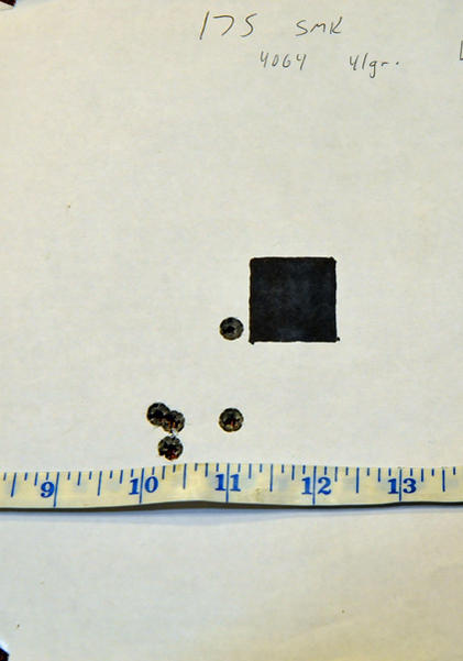

I decided to go with Lake City Brass (2013 variety) 175 gr. Sierra Matchkings and IMR 4064 powder. During load testing I came up with 41 grains of 4064 as my best group. Average velocity was 2606 fps. at sea level (84 deg. F.) IMR 4064 is considered by some to be the slowest burning powder that can be used safely with an M1A. Working up loads to shoot 175 grain bullets long range must be done safely (start low work up gradually) While this is true of any load workup it is especially important with an M1A to avoid damaging the gas system/op-rod of your rifle.
5 shot group size with the one flyer (Hey it happens) was a little over 1.5 MOA . Excluding the flyer was a little under 1 MOA.
Overall I was pretty pleased with this so I loaded them up and went to the long distance range.

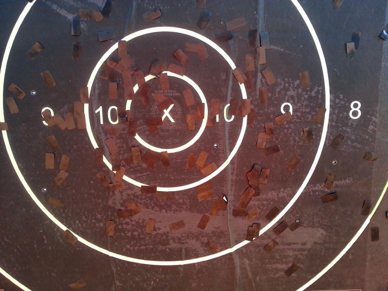

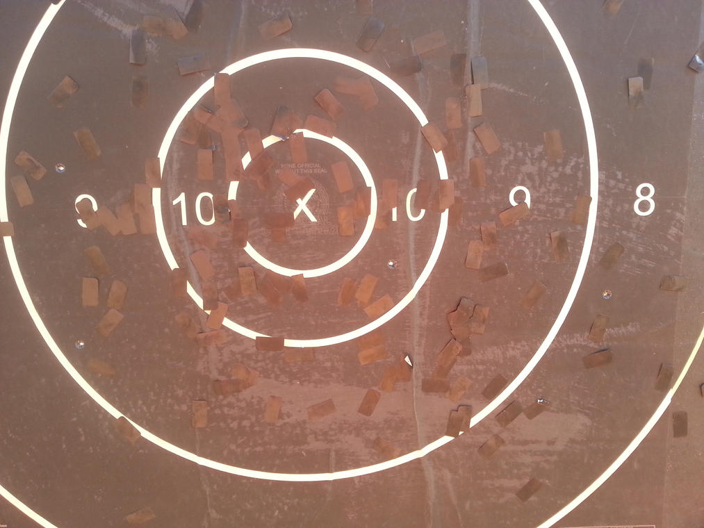

I did some shooting out to 600 yards with some 168 gr loads I already worked up and then went back to 800. This was my 5 shot group at 800 yards on an NRA long range target with the 175 gr SMK's and 41 gr. IMR 4064. I was shooting prone with front and rear sand bags.
roughly 19 inches at 800 yards (about 2.25 MOA). I know its not exactly record setting by any means but I'm somewhat satisfied with this coming out of a semi-auto battle rifle designed in the 1950's. Hey 19 inches is roughly shoulder width with so not terrible I suppose. I know it can be improved with some more consistent shooting skill. I was having a hell of a time establishing a good cheek weld with the high mount Basset scope mount and crummy black hawk lace-on cheek piece.

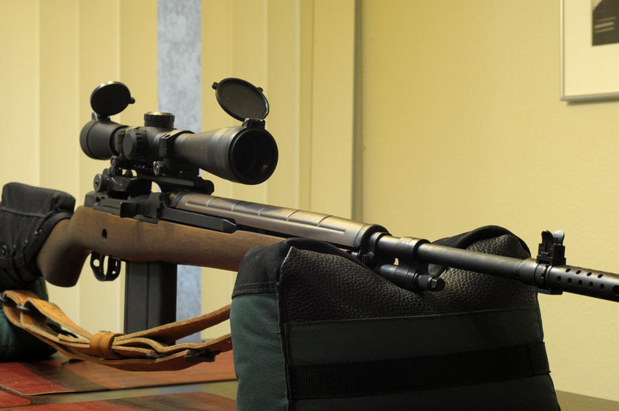

Two things that should help. First is to get a Schuster plug. Not the adjustable one, but the one with a pinhole at the end. It's the one approved for service rifle matches. You can get the adjustable one too, but I found it a nightmare to adjust. The pinhole one comes adjusted for the 175-180 grain range and works flawlessly.
http://www.creedmoorsports.com/shop/Schuster_M14-M1A_Gas_Plug.html
Second. When using a front sandbag, put it as close to the mag as possible. The thing that makes M1As complicated to shoot accurately, is that it needs to be "tuned" like a musical instrument. Everything affects its accuracy since it has so many moving parts. One of the things that affects accuracy is the barrel/gas block movement in the stock. To keep it consistent, you want to keep the sandbag/rest away from the front portion of the stock. One thing that helps improve the barrel always returning to the same position, is adding grease between the stock ferrule and the barrel band lip. That's the small little "U" shaped piece that rests on the metal end piece on the stock.

The flat face of the front ferrule isn't supposed the touch the flat back side of the front band, the curved lip of the front band and the curved part of the ferrule do. The lip of the F/B needs a small smear of grease to help the F/B return too its at rest position after firing. Naturally if your Gas Cylinder isn't unitized this is pointless. Free floating barrels worked on very few rifles and was quickly abandoned.
