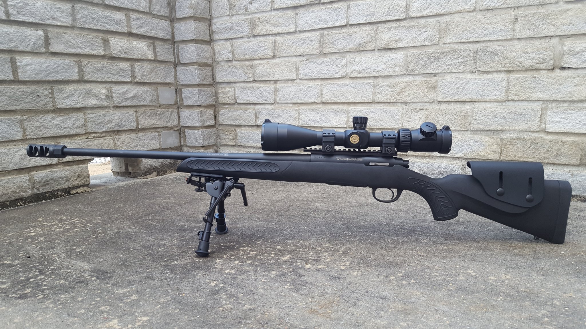

I am a complete newbie, and my goal is to shoot 1000 yards for less than $1000 invested in my rifle system. I just got it together and I have not been to the range yet. I welcome any advice and I have been reading and studying while waiting to get all the pieces together. So my system is as follows.
Rifle: Thompson Center Compass in 6.5 Creedmoor
Optic: Athlon Argos BTR 6x24x50 Mil/Mil bought from Cameraland with Snipers Hide discount
Base: Egw 20 Moa
Rings: Badger Ordnance medium bought off Snipers Hide
Muzzle Brake: MPA 6.5 Bought off Snipers Hide
Bipod: Harris BRM-S with locking lever added
Cheek Rest: Mathews Fabrication
Trigger Spring: Ernie the Gunsmith Winchester Model 70
Total: $928
Looks good. First step if you don't reload is to go out and buy a few different boxes of factory loaded ammo. Shoot some groups with it and find out what she groups tighter with. I would try Prime 130, Hornady Eld-M 140, Hornady black 140 BTHP, and maybe FGMM as a start.
Good luck and have fun.
