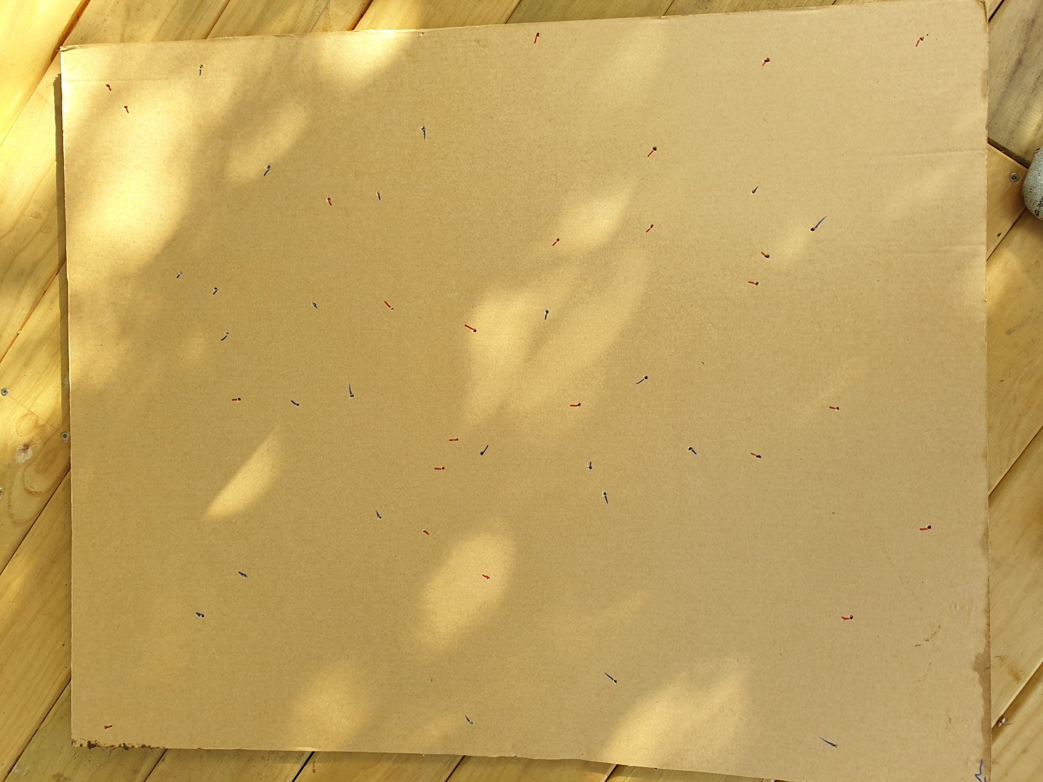

So I patterned my gun at 60meters, with predictable results.
Remington 870 with full choke, cardboard is 32" wide 40" high.
The red marked shot is #2 lead, blue is BB.
You can see there is some pretty big patches with zero shot, definitely not tight enough for a headshot on a turkey, probably just end up with a wounded bird.
#4 shot would be better i guess with more more pellets but can't imagine it'll be much more effective.
Guess I'll try find a tighter choke and see how that goes.
Thats definately not great. You could try a wad stipping non constricting choke. Here in the US its Patternmaster.
