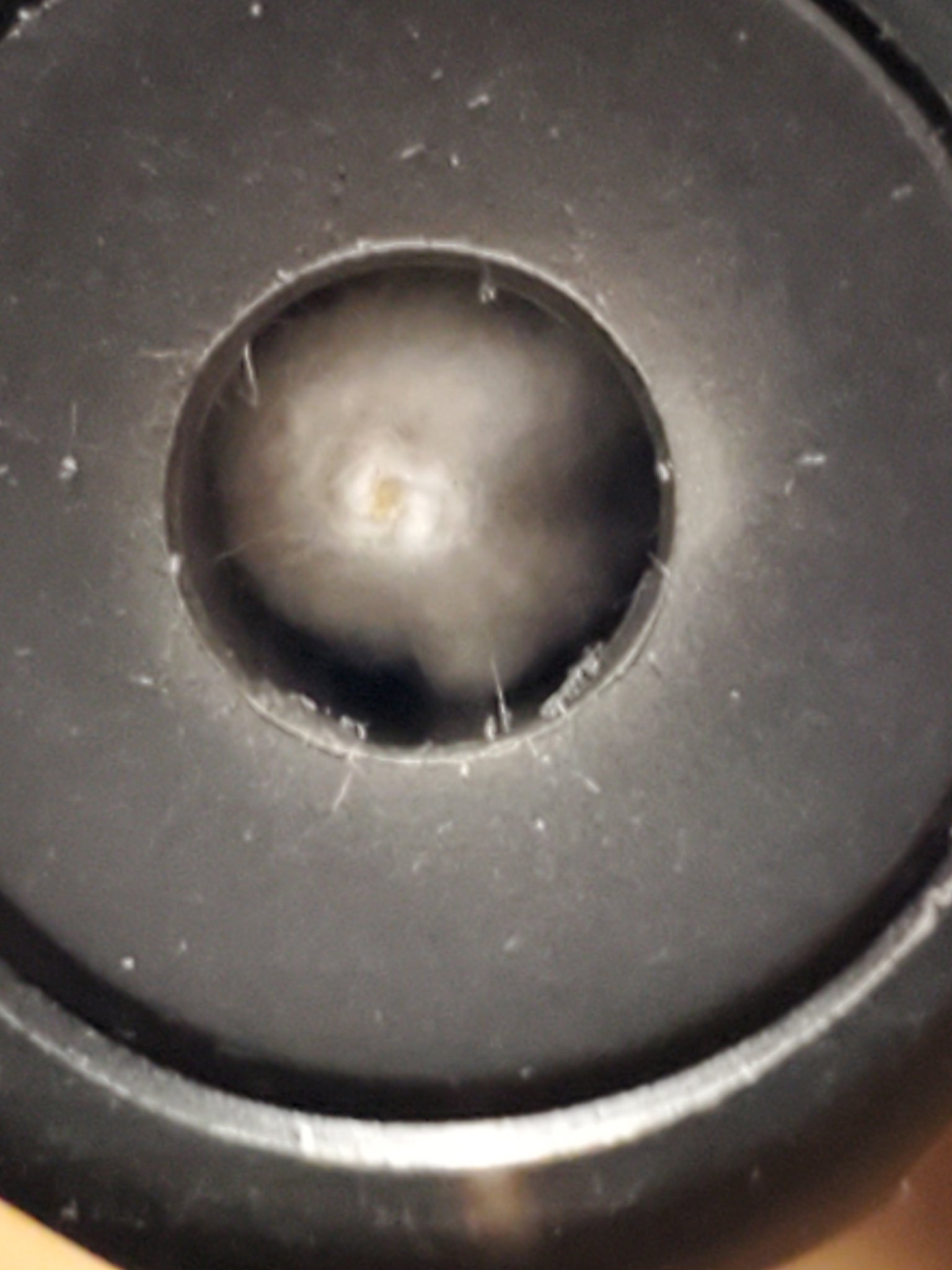

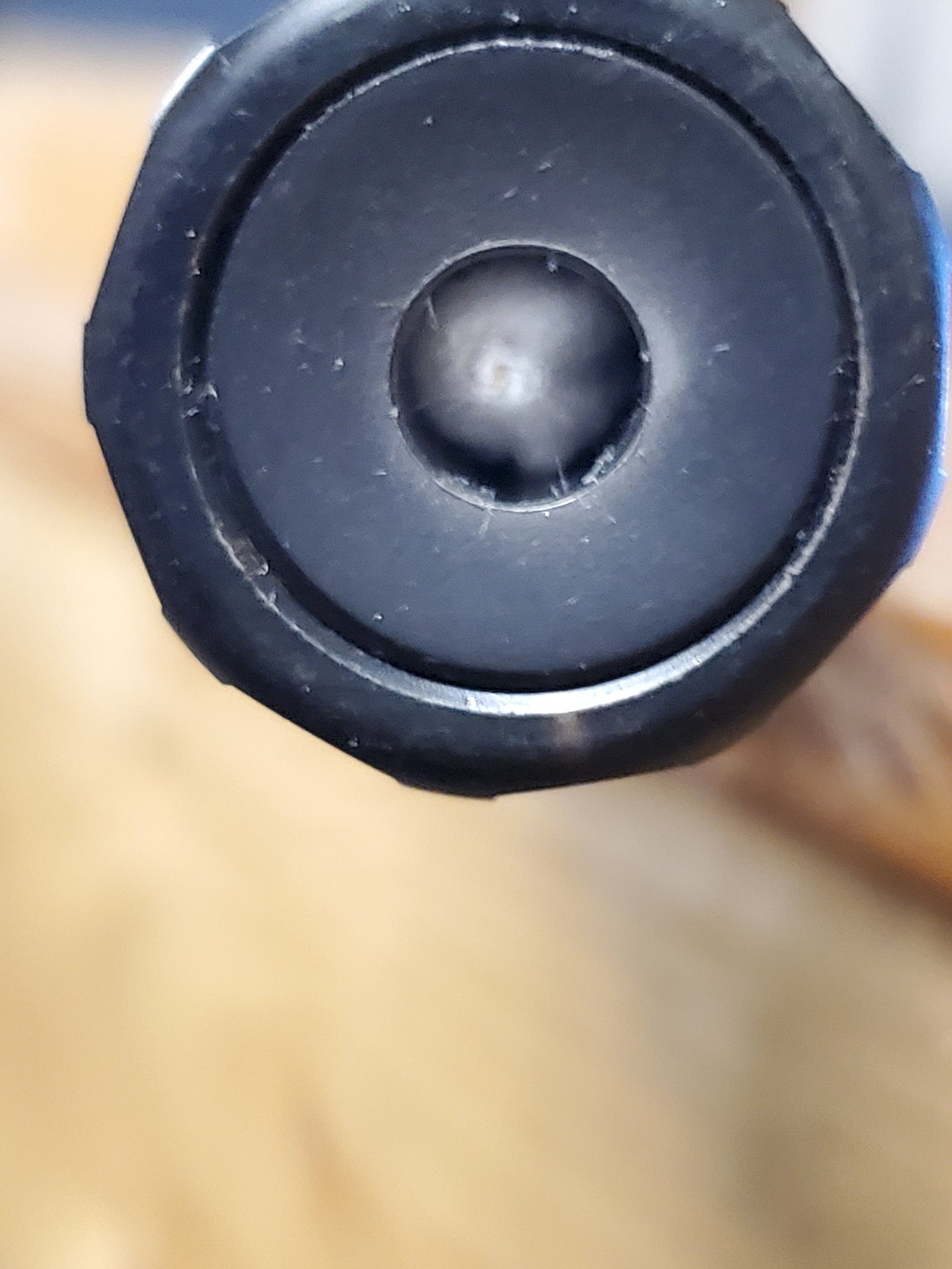

Look at that crown - new crown needed?
Before venturing down the crown path, check your scope base, rings/mount, etc for tightness.
Then check your action screws.
Check the simple stuff first.

My usual way of things would be to try out different ammunition. But since the crown looks the way it does, I thought I would get opinions on that first.
So either crown, scope, or ammunition.
The easiest way will be to try out another type of ammo. Then I can use a different scope and so on...
One can clean up the crown with a tool from Brownells, Numrich, etc. Compare price to gunsmith charge to see if it's a cost effective option. The crown might not be the sole issue to lack of precision, but the condition isn't doing the rifle any favors.

There look to be some burrs and non concentric areas on that crown. I would be suspect that it is causing accuracy problems. I have a McGowan 243 barrel sitting next to me with a similar crown that shoots about 3 MOA. It would not be the reason the groups are moving up and down the paper.
I used the Q-Tip method to check for any burrs and couldn't feel any.
