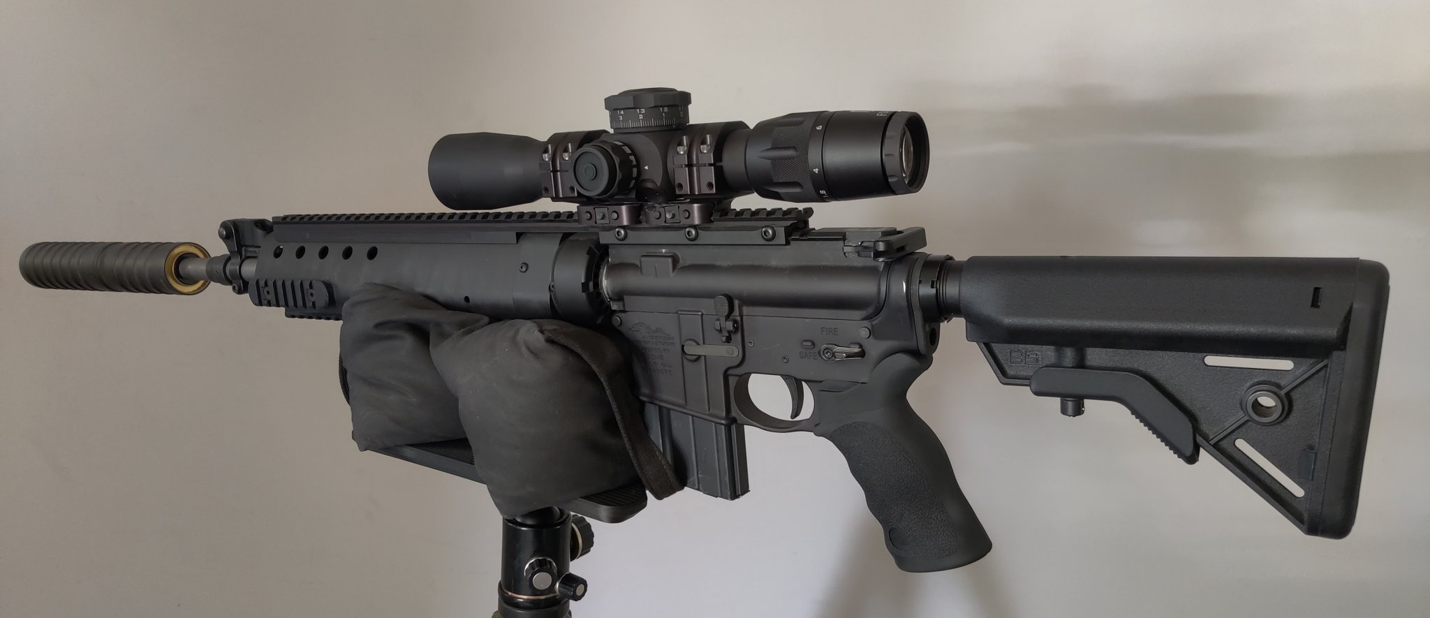

    Picture of the rifle:
    I'm using a standard carbine buffer, I want to say it's a BCM buffer tube, but I'm not certain anymore (it's been a while), b5 Sopmod, Anderson upper and lower, BA 18" SPR profile barrel, Area 419 Maverick, standard MK12 furniture, PRI delta forend, USO FDN 10x in an MPA BA mount, triggertech safety and a Larue MBT. PSA bolt carrier, Brownells 6.5 Grendel bolt.

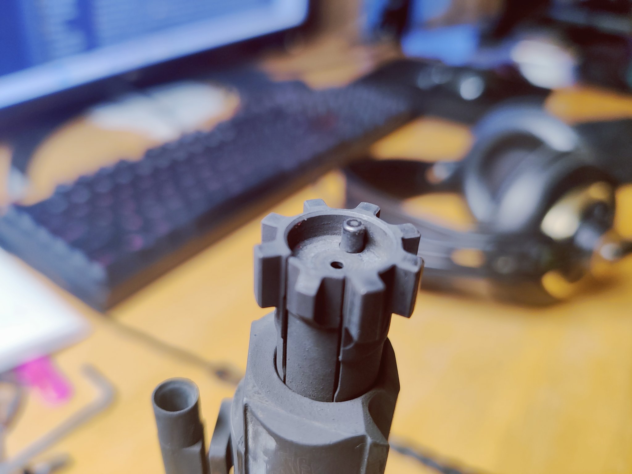

    Just took bcg out to check the ejector, and sure enough, it's pretty squared off:
    Any recommendations on replacement plungers or new bolts?
    I remove the ejector if it needs to be radiused, and spin it in a drill slightly until I reach the desired effect.
    Bill said they addressed this in manufacturing by making sure the ejector was a specific length, not too long so it couldn’t impinge on the side of the case rim.
    Once I’m done tuning the ejector face, I clean it and Cold Blue it so it isn’t left in the white.

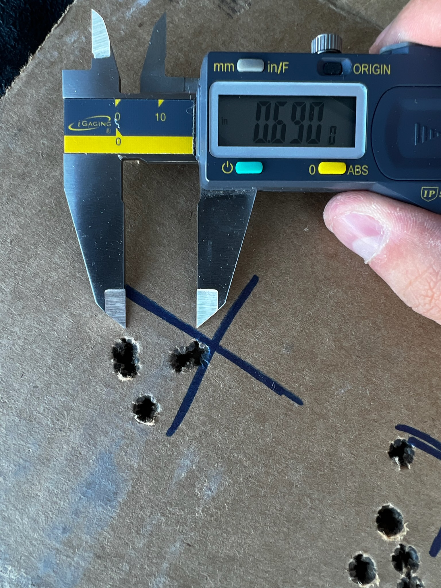

    And as promised, groups size for the 123 Scenars over 27.9gr 8208 XBR, CCI 450s, starline brass. Not as good as my bolt guns with custom barrels, but for a $200 Ballistic Advantage barrel on a gas gun, I'll call it good enough. I still want a Craddock/CLE someday though.
    Who knows, a "better" barrel (more $$ that is) may beat that and it may not.
