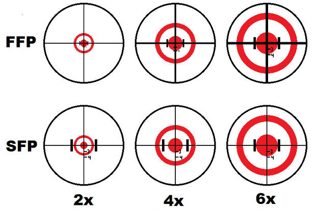

I personally like front focal plane for precision rifle stuff, when you zoom in the amount of area the reticles hash marks display stay true/they scale with the image. If you are off 1.2 mils according to the reticle it will always be 1.2 mils.
Second focal has the hashes stay the same size so when you zoom in the amount of area the dashes covers scales proportionally with your magnification level (if a 1 mil dash correctly subtends at 20x then at 10x it would actually represent 1 mils).

In this below image you can see that the front focal plane at minimum magnification (top left) can be difficult to make out quickly where the second focal plane (top right) is much quicker to find. If youre going to be quick swinging and shooting into the sticks at moving deer under 50 yards then the front focal could be an issue for that reason of it getting small and fine, if its all down your shooting alley from your good comfy shooting base out to 400 then its not really an issue to concern yourself with as you shold have adequate time to situate yourself for the shot.

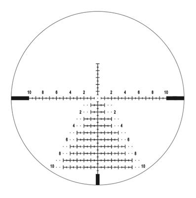

The cabelas has a nice looking reticle, only half mil dashes as opposed to the .2s that many competition shooters favor these days but thats no problem, I dont mind the half dashes myself.
