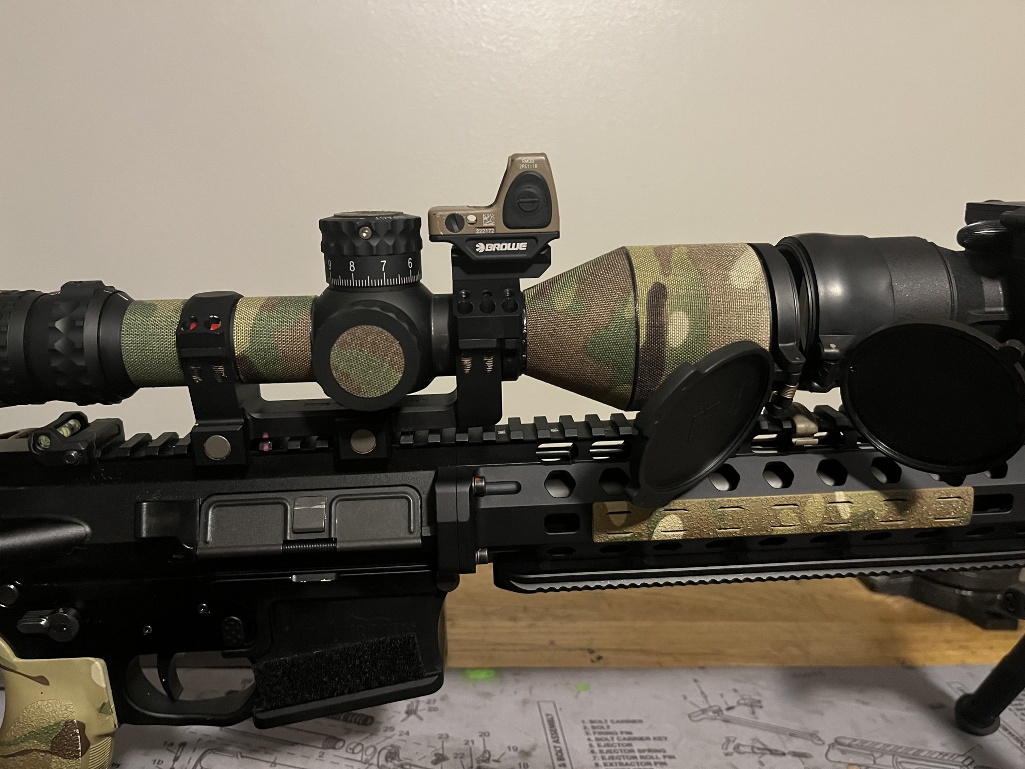

If you’re willing to swap mounts, a NF with their A425 ring up front got me enough clearance to avoid hitting the scope body and turret. I got the lowest RMR mount I could find (Browe) and it worked out pretty well for me. It’s almost only the window showing above the turret.
Reactions: eugevita

Pretty sure it’s an A191, 1.375 height and 20MOA. The Browe mount has held zero so far, but it also hasn’t been out but a handful of times since I put it together.
