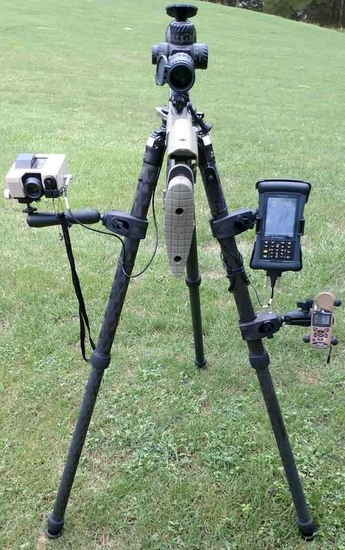

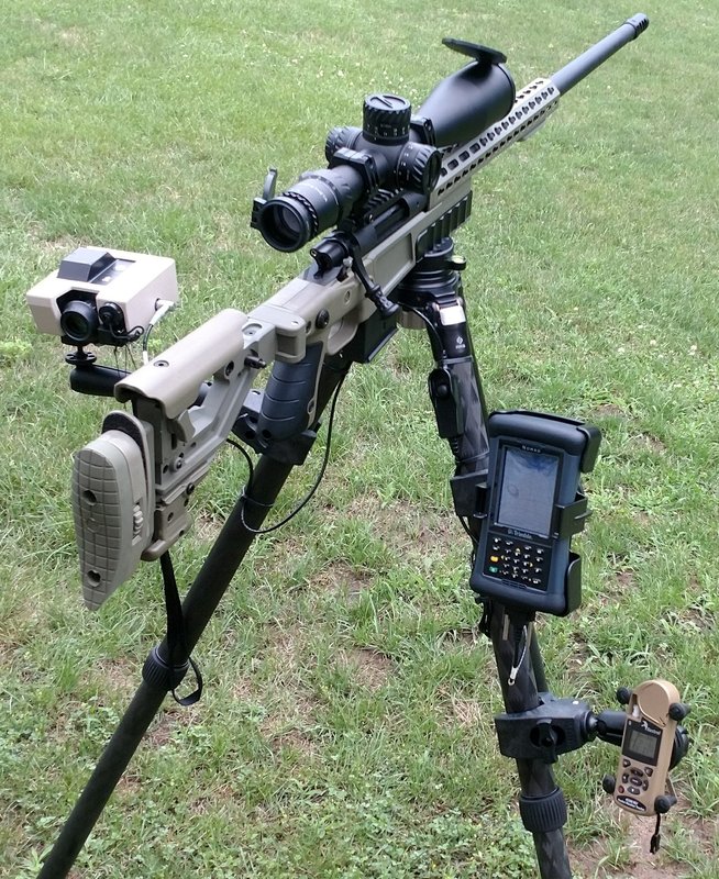

    How's this for multiple uses? I finally got everything mounted on one tripod! The RRS is the way to go.
    Todd
