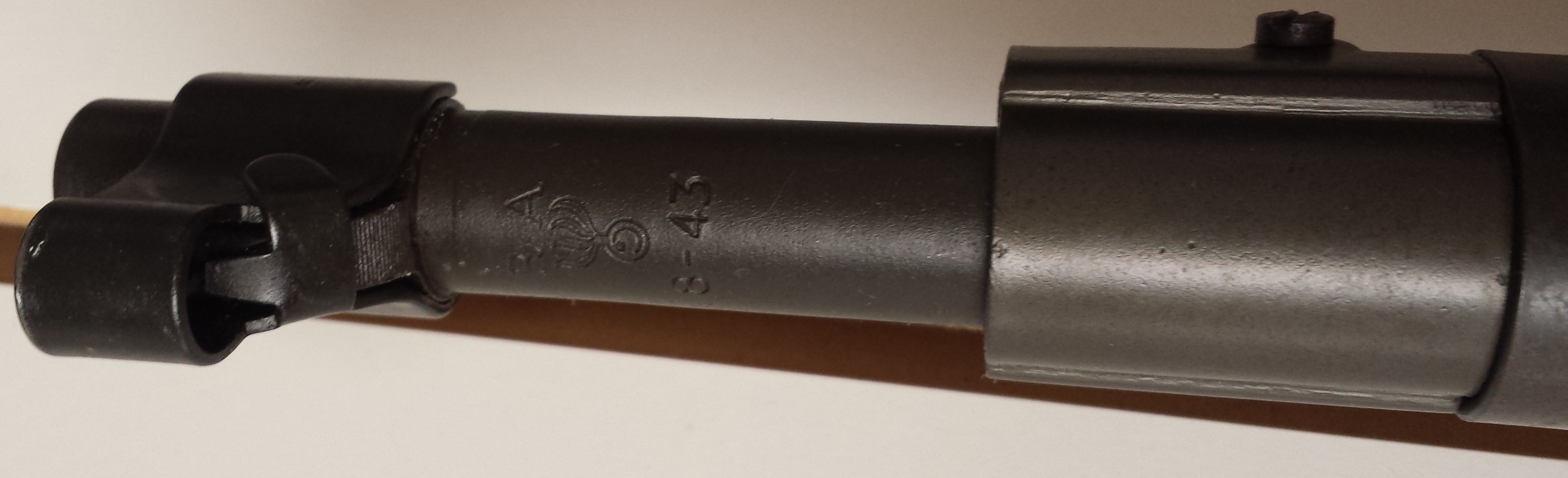

I just don't know anything about what to watch out for. Totally clueless about these rifles. Seems like there are fakes, mods, restorations etc that can shift the value a lot. Aim Surplus has refurbs for 795 but with a new barrel is it still vintage? I'm not looking to have a certificate of authenticity framed on the wall below it, just want something I can pass on to my kid but if I'm going to start upgrading with new parts I can get a Remington 700 that's lighter and shoots better for $500. Or am I missing the point? Are people okay with replicas just to preserve the look and feel of an old classic?
Barrel is marked 43 and the serial number 390XXXX seems to be from around the same time from what I find online. The rifle looks good to me but I don't know what it's supposed to look like. Maybe a little too good for 70 years old, I'm nowhere near that and I look like hell.

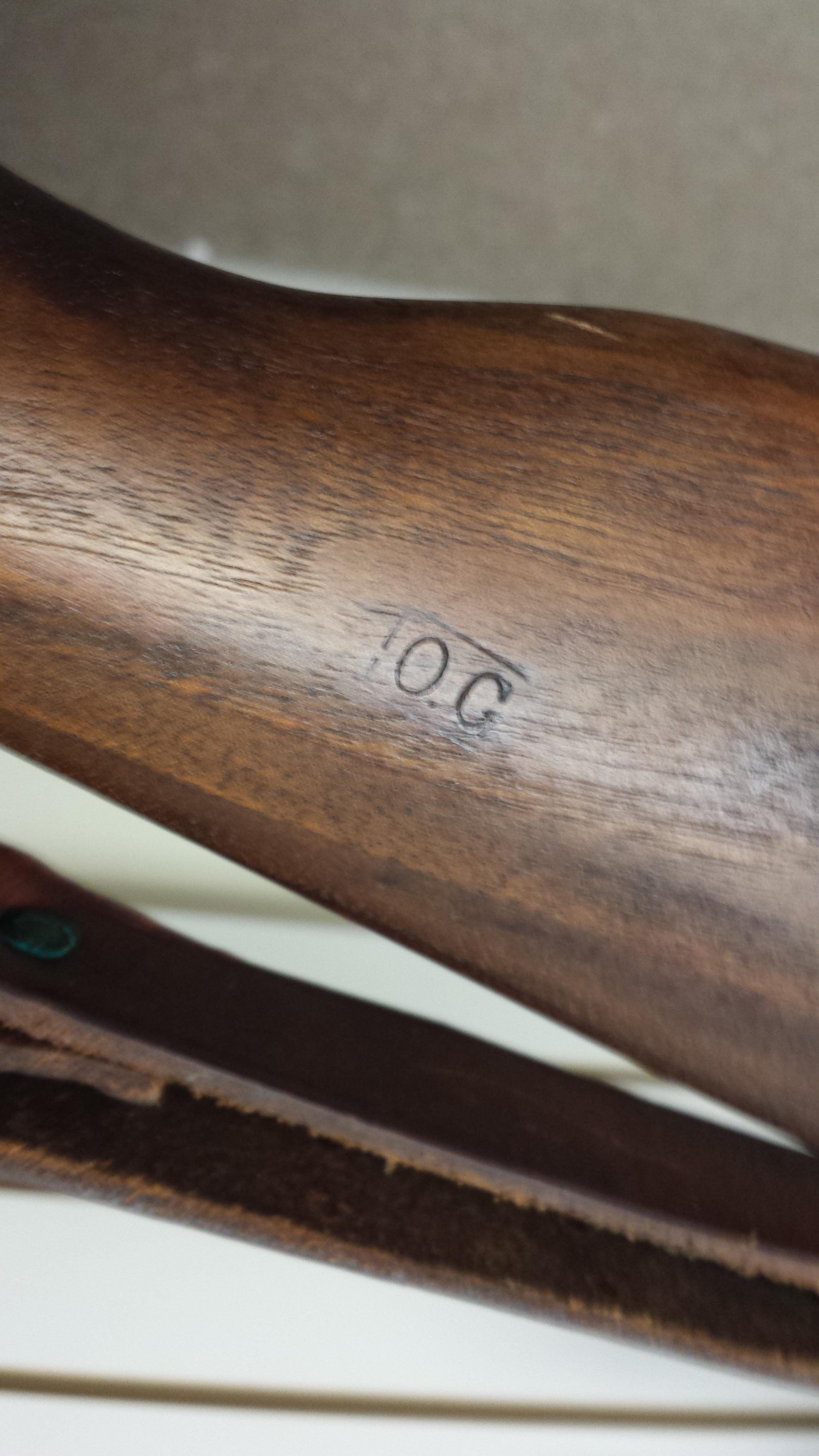

If the bore looks good and there are no obvious problems with that Remington, I would buy it. Try to get it for a bit less but it is worth about what they are asking. The sling may add another $100, if original. That rifle went through Ogden Arsenal and has seem some rebuilding. The bolt and the bands were originally blue along with some other small parts. I think there is a good chance you found what you are looking for. Good luck.
Appreciate the info...so OG means it came from Ogden? And someone did some refinishing?
Ogden rebuilt the rifle, or at least did a complete check out. Either Oden refinished some of the metal parts, of another arsenal(sometimes these were rebuilt more than once) or somebody else refinished and/or replaced some of the parts. From the looks of what I can see the rifle is worth a serious look and probable purchase IMO.

From the few pics posted that rifle looks to be in very good condition. So far it looks like an Ogden arsenal re-inspection, not a rebuild. A few more pics to help evaluate it would be nice though.

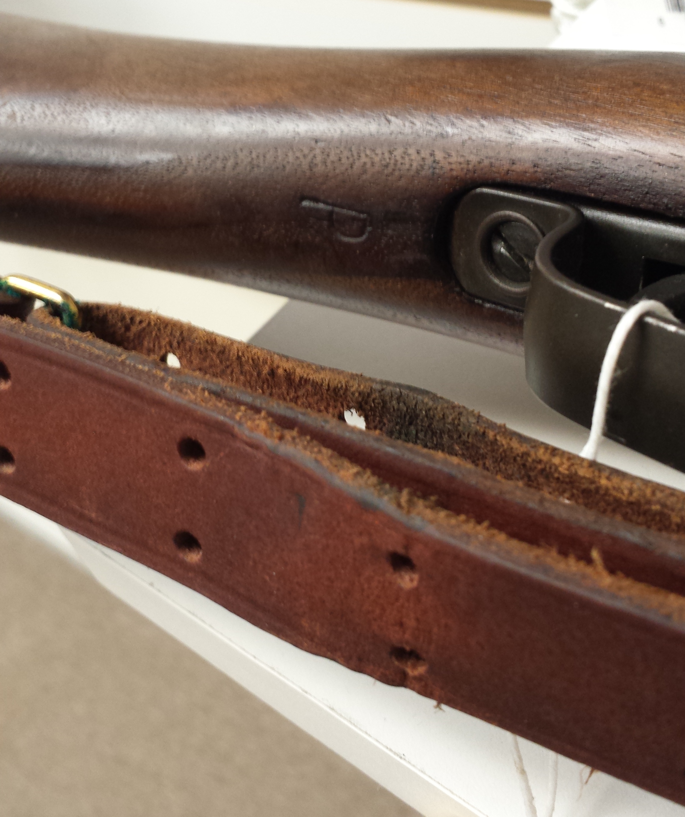

The Ogden cartouche looks sharp the P cartouche less so. Probably wear from use. Imo it was reworked by OG as others have said but the sharp oG cartouche tells me it wasn't messed with afterwards. If the bore checks out then i'd buy out.
Scant stock with a non-circled proof stamp is a rebuild. May have simply been a stock swap, but the rifle is not 100% original as built.
Consistent with post 4 and 8, the gun has had some refinishing/rebuilding/rearsenal work, or even joe blow alterations??. The bolt and bands were originally blue. They are not now. I have said from the get go it has has some rearsenal refinishing and alterations. It still remains a good potential buy.
