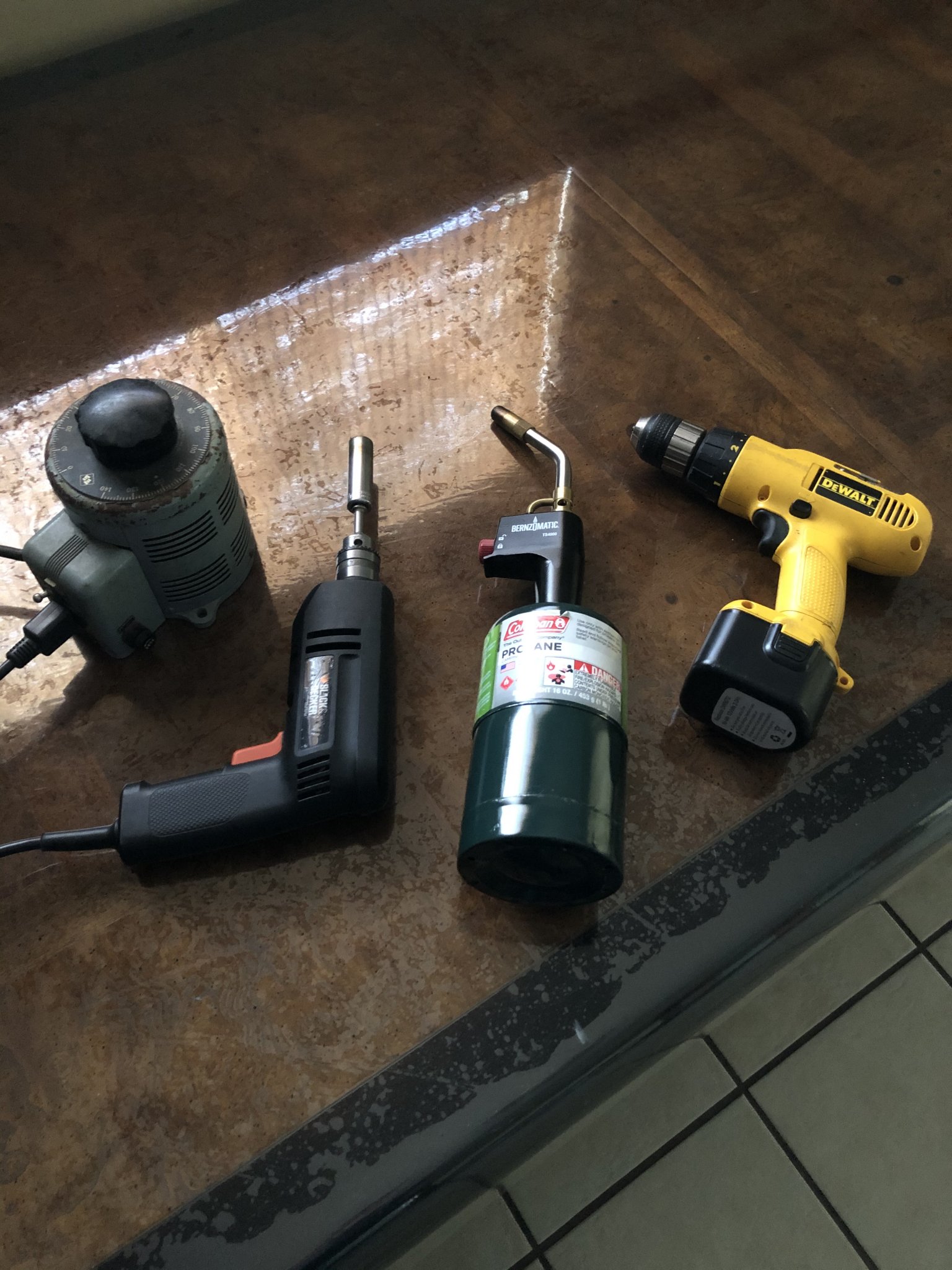

    While a little more "hands on", most folks have a drill, a deep well socket and a torch. The auto transformer is nice for lowering the drill speed and locking it "on". A few seconds of counting, + or - depending on cartridge and Viola, annealing done easily and inexpensively
    I had considered that and have experimented with that method years ago but figured with what I have invested in probably 1000 pieces of Lapua brass I would rather have both automation to a certain extent and better consistency.

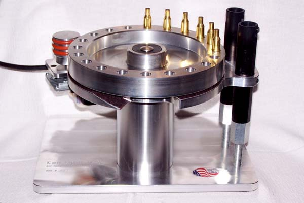

    I've used a Ken Light annealer over ten years. Ken used to sell them, he died I think and Brian Crawford (the guy who manufactured them for Ken) is selling them under his company, now.
