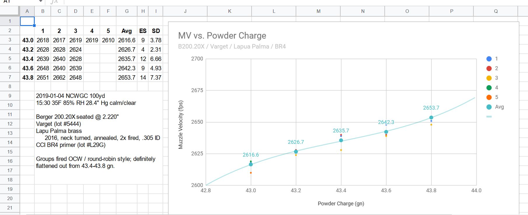

I went thru some similar pains trying to create error bars in Google Sheets (spoiler alert: you can't, unless they've added that feature recently / since I post this). What I ended up doing was kind of cheating, by plotting each velocity for each charge weight as a 'point', but only plotting a *line* for the average MV.
...which actually worked out pretty slick, actually. Not quite the same as error bars, but it gives a good-enough simulation of the same kind of information.
Or nowadays you can just use ChronoPlotter and it'll do it all up for you nice and neat (y)
