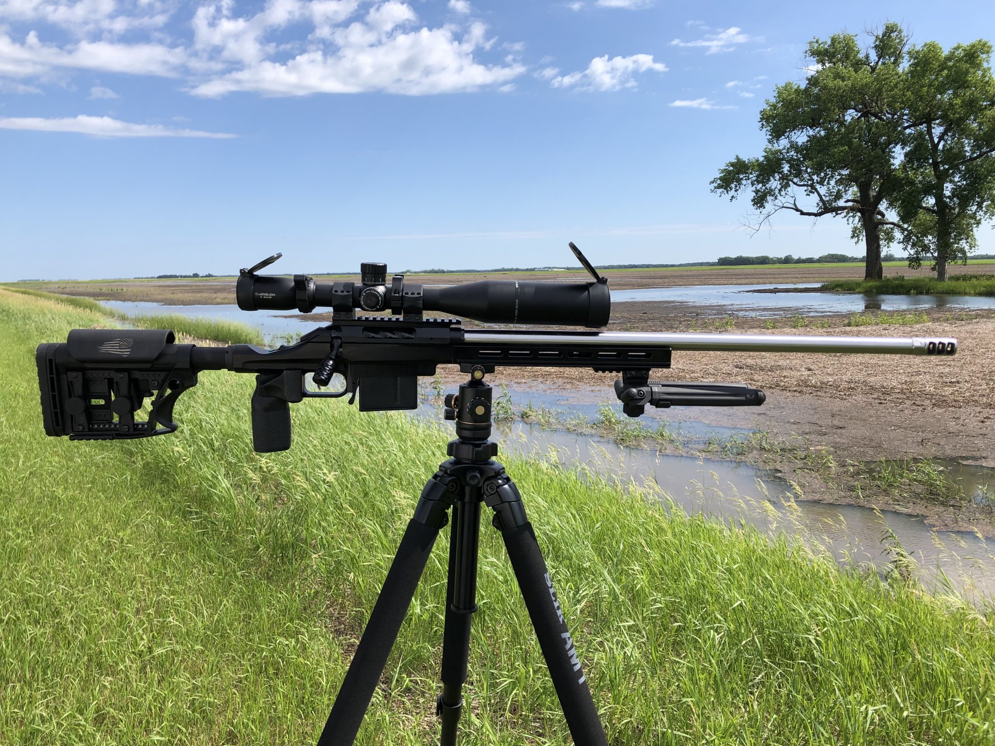

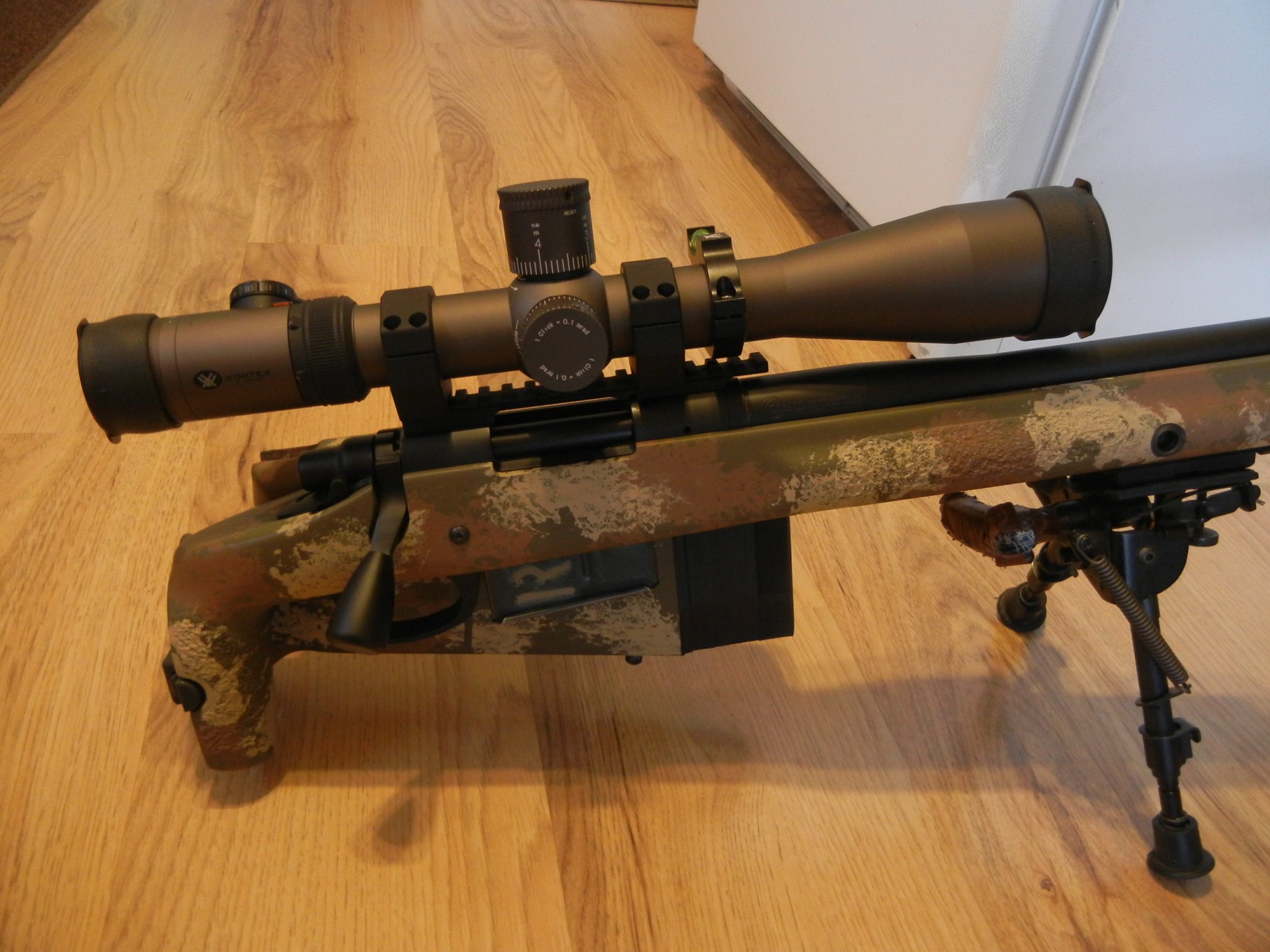

    Indian Creek Design MoFo chassis with their folder. Depending on which buttstock and hand grip you choose it can be under 3.5 pounds. It utilizes a modular fore end system.
    Picture of mine attached. But mine holds a Ruger American. The fore end I’m using is called the Johnny. M-lok on 3 sides and the entire length of the bottom is ARCA Swiss dove tail
