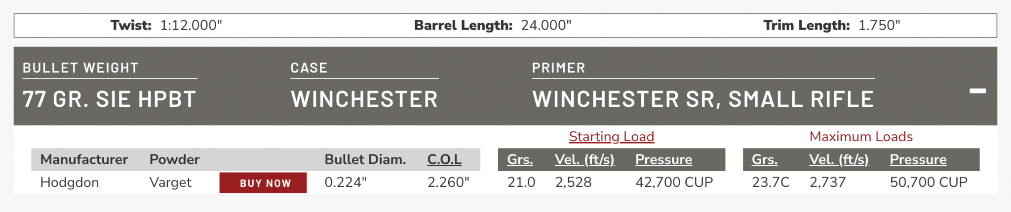

Yes, the very first one I was given out here was 24 gr of Varget and when I looked that up in the Sierra reloading manual it exceeded max load by a long shot. I'm looking to duplicate the PMC 55 gr FMJ BT @ 2900 FPS which was listed as the most accurate loads. Now if I could define what power and primer PMC uses I would be good to go for starters. The manual said 21.5 gr of RE7 will give 2,900 FPS to their 55GR FMJ BT.

Yep, just looked both of these up in the manual and they say 2,900 FPS. Thanks

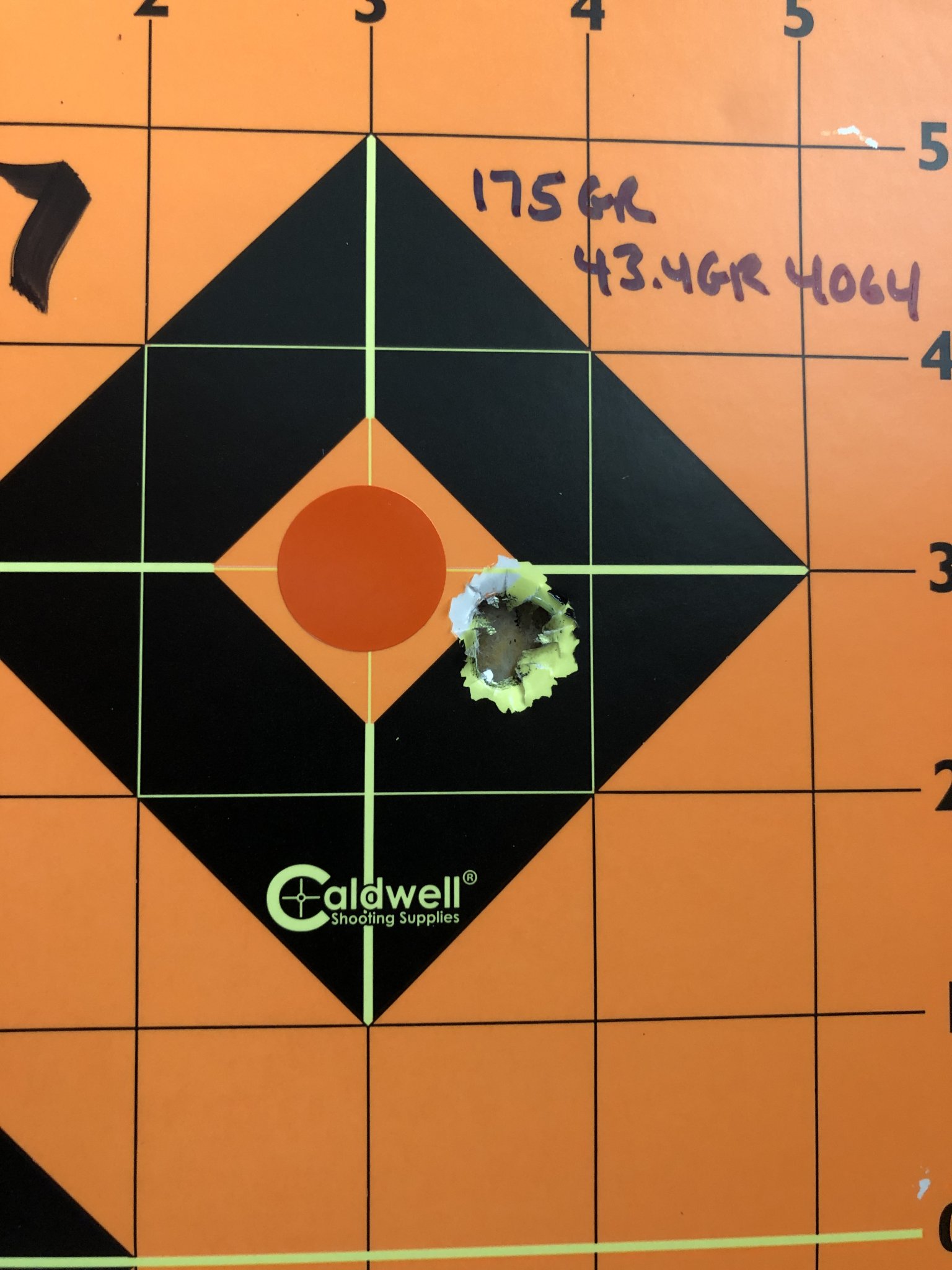

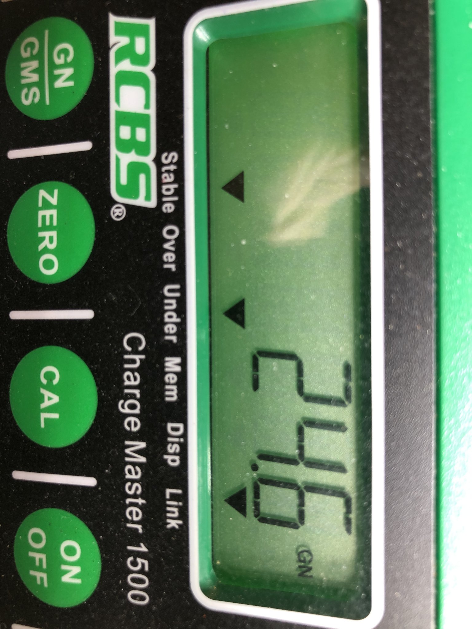

And I don't mean to lecture anyone, I am just telling the guy the truth. Proved it last week, proved it last year, I test AR15's weekly almost, by the dozen, with every single powder you can buy, I have every bullet you can buy probably.
I can tell you without a doubt, the most accurate load data out there is Hodgdon (for real world testing I have done). VV is HOT, and Hornady, Berger is super conservative. Nosler is a mixed bag, some is super hot, some is conservative.
What is funny is that over 1 GRAIN HIGHER Than Hodgdon's book max, which is realistic max, not fantasy, at 24.9 IS NOT EVEN CLOSE to the same FPS as what VV says is their SAAMI Max! That is unbelievable. Because VV's data is not realistic or accurate. The VV data is putting you way high pressure, and the brass supports it. I load 0.8 grains LESS than the VV max, and its STILL HOT with N540 at 2800+ FPS?
I guess you were not expecting, that I just tested this IRL last week, with all same conditions. The brass internal capacity was large too. Not small, because the brass was on light end, not 100+ GRN end.
You really, like for real, do not understand a manufacturer's book maximum MAY not be SAAMI maximum of 55ki in "reality"? LIke for real, you DONT KNOW THAT? Don't you think everyone can read? It says 24.7. But this is way hotter than SAAMI spec. Some guy, LIKE YOU, argued this last week. So I loaded up a bunch of book maximums in the SAME BRASS, using 77 SMK at same OAL as book (powder manufacturer book) and tested it in 20" barrel. And guess what. 24.7 is super hot, and definitly NOT 55k PSI. like 100% not.

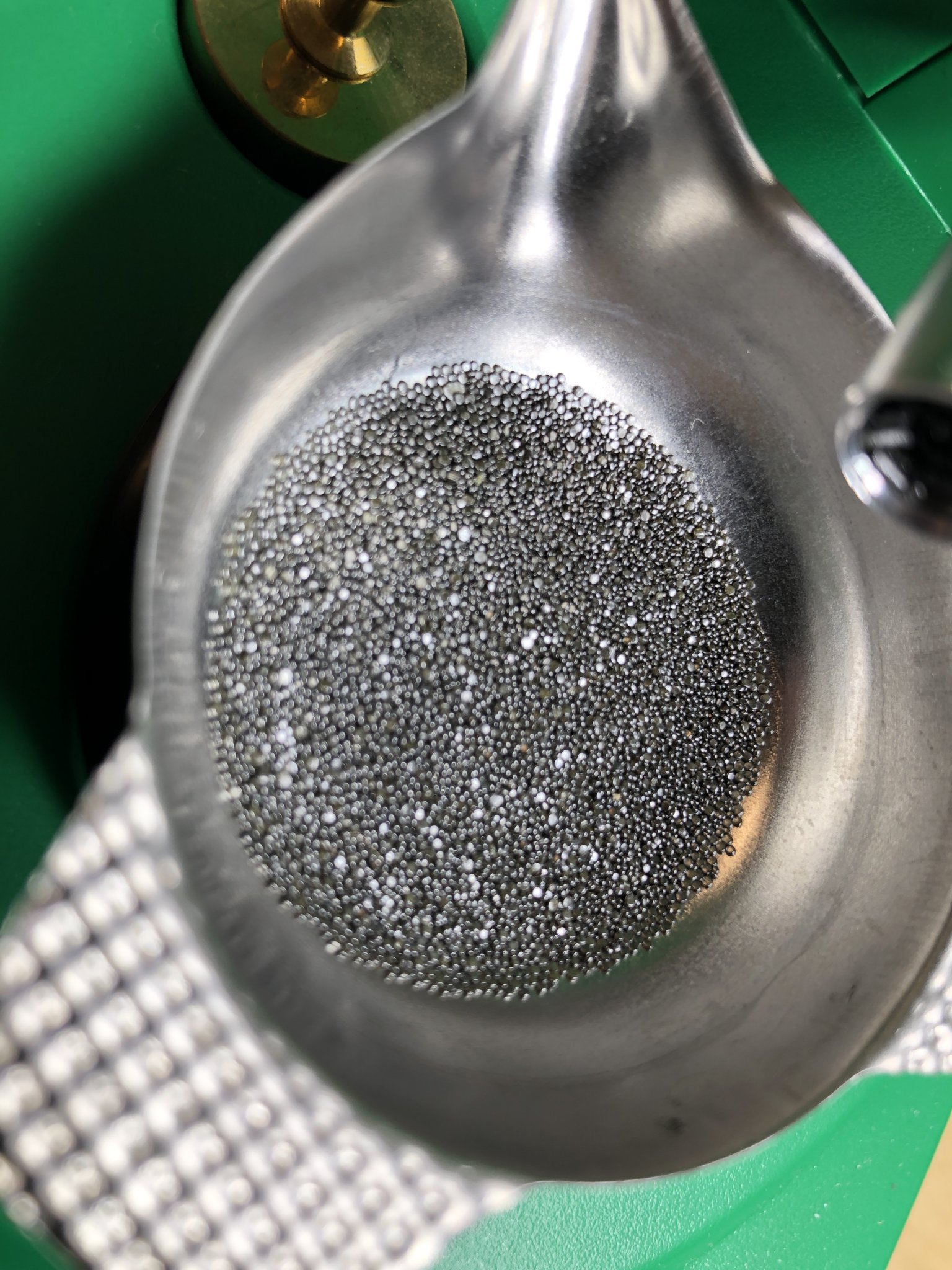

The accuracy is dependent to a degree on powder type.
Varget for example won’t be a good choice for a thrower.

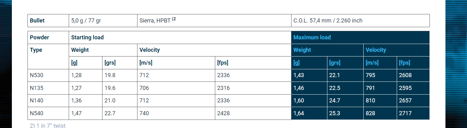

Don't think I'll be going with 24 gr of varget with a 77 gr bullet

Whoo, I did a little looking around and found this - https://www.vihtavuori.com/powder/n133-rifle-powder/ and this - https://www.vihtavuori.com/reloading-data/rifle-reloading/?cartridge=7. Did not find a load for the 55 gr Blitz King but I guessing it close to being like the 55 gr Berger, FB Varmint. Thanks for the heads up on a great powder.

My 77smk loads tend to be 23.9-24.1gr Varget, depending on what brass I’m using.
So, you’re real new to reloading, correct?
Book values tend to be usable, but they also tend to have a pretty decent safety factor built in. Use safe reloading practices for sure.
I think it shows 23.7 gr of Varget is a compressed load so 24.1 must really be compressed. Anyway thanks for the insight. maybe some cases hold more than others. I'll be using PMC, LC and Remington. Don't have any idea which one has the most volume.

Well, I looked at all three powder and each one can get me close to the 3,240 FPS with maybe a few 1/10 over max load. That would get me in the ball park of matching the speed of factory 223 match ammo off the shelf. Now to find out which one if the most stable in all temperatures and burn rate is consistent. Never used any of these powder because I never owned anything less than a 243 Winchester which I regret getting rid of as well as my 7mm mag. Anyway if you have more information please let me know. We are going to give this a try since my understanding is these manuals are on the conservative side and ~ 3,240 FPS is what I am striving for.
