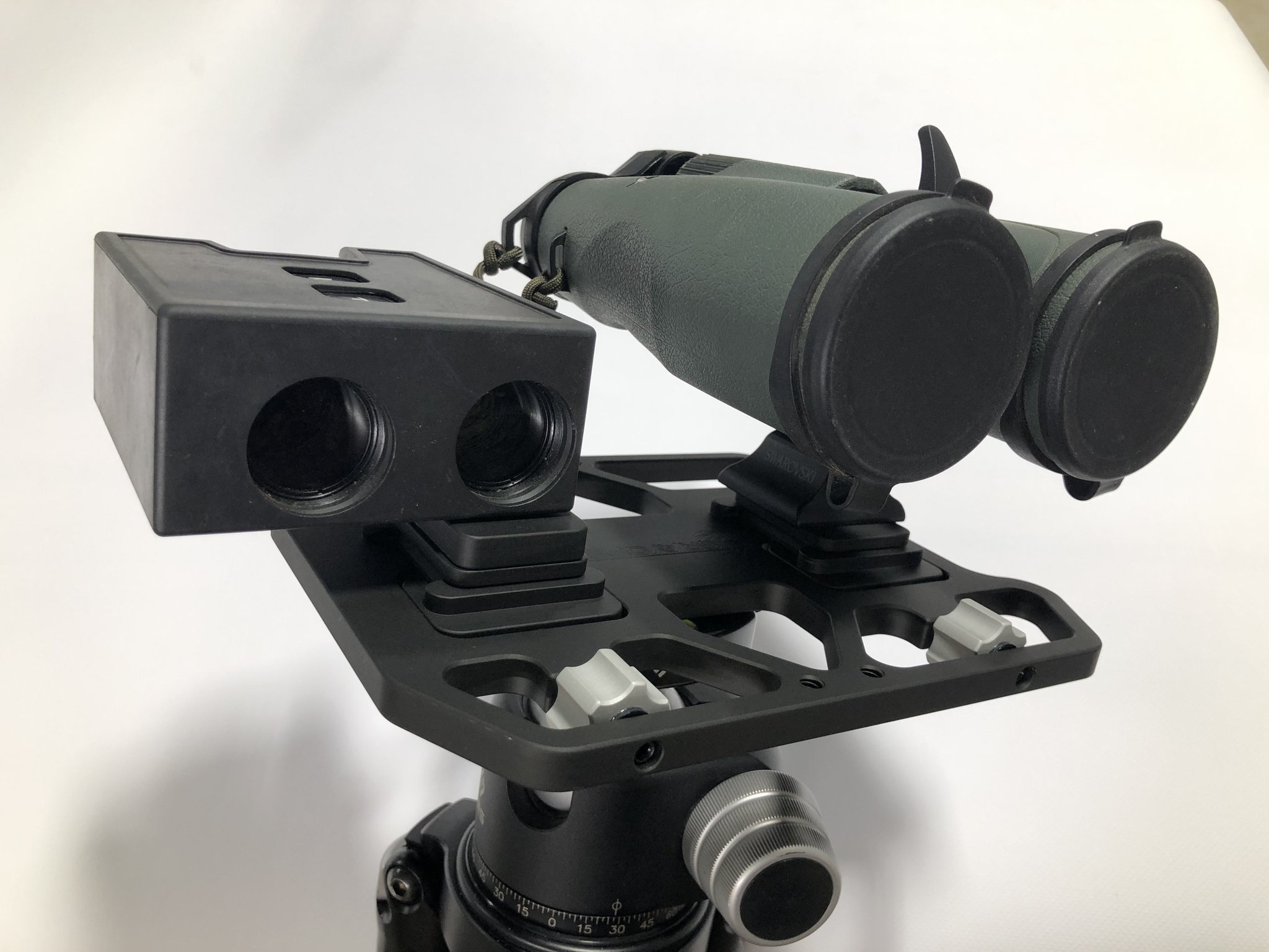

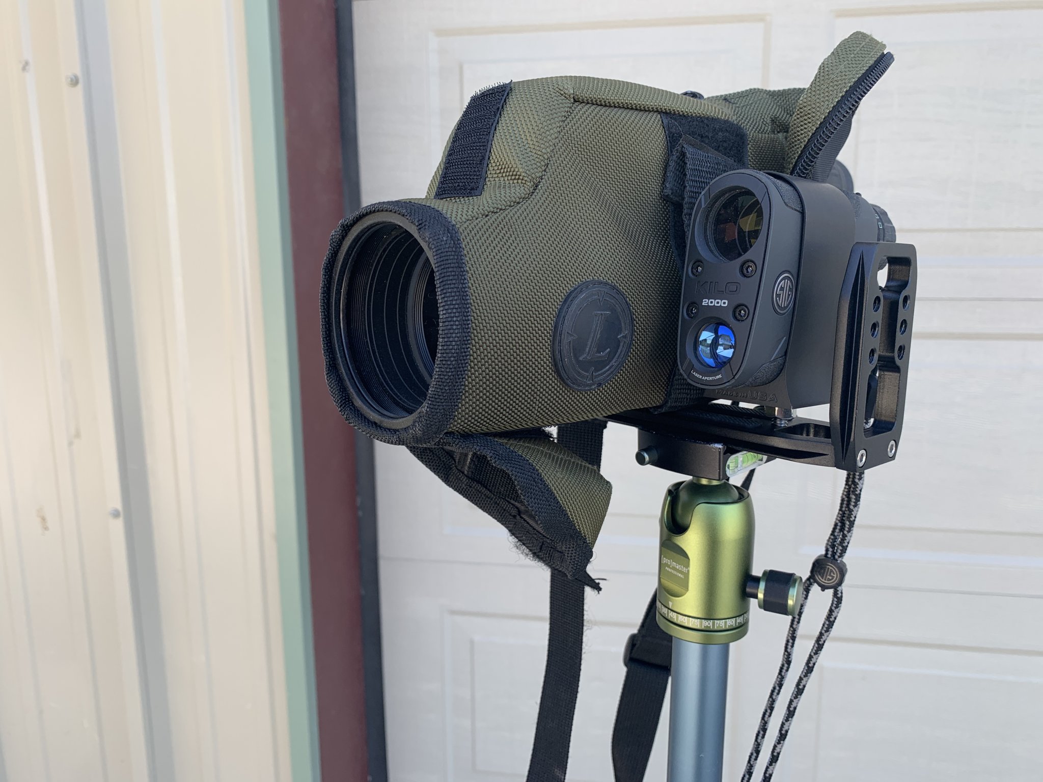

I ended up going with the GrayOps AMP plate. Pretty sweet piece of kit.
It’s just an arca rail 120mm length then the kilo has a screw with a spacer in between the rail and the kilo. This allows for the kilo to be up a bit higher.
Hope that helps!

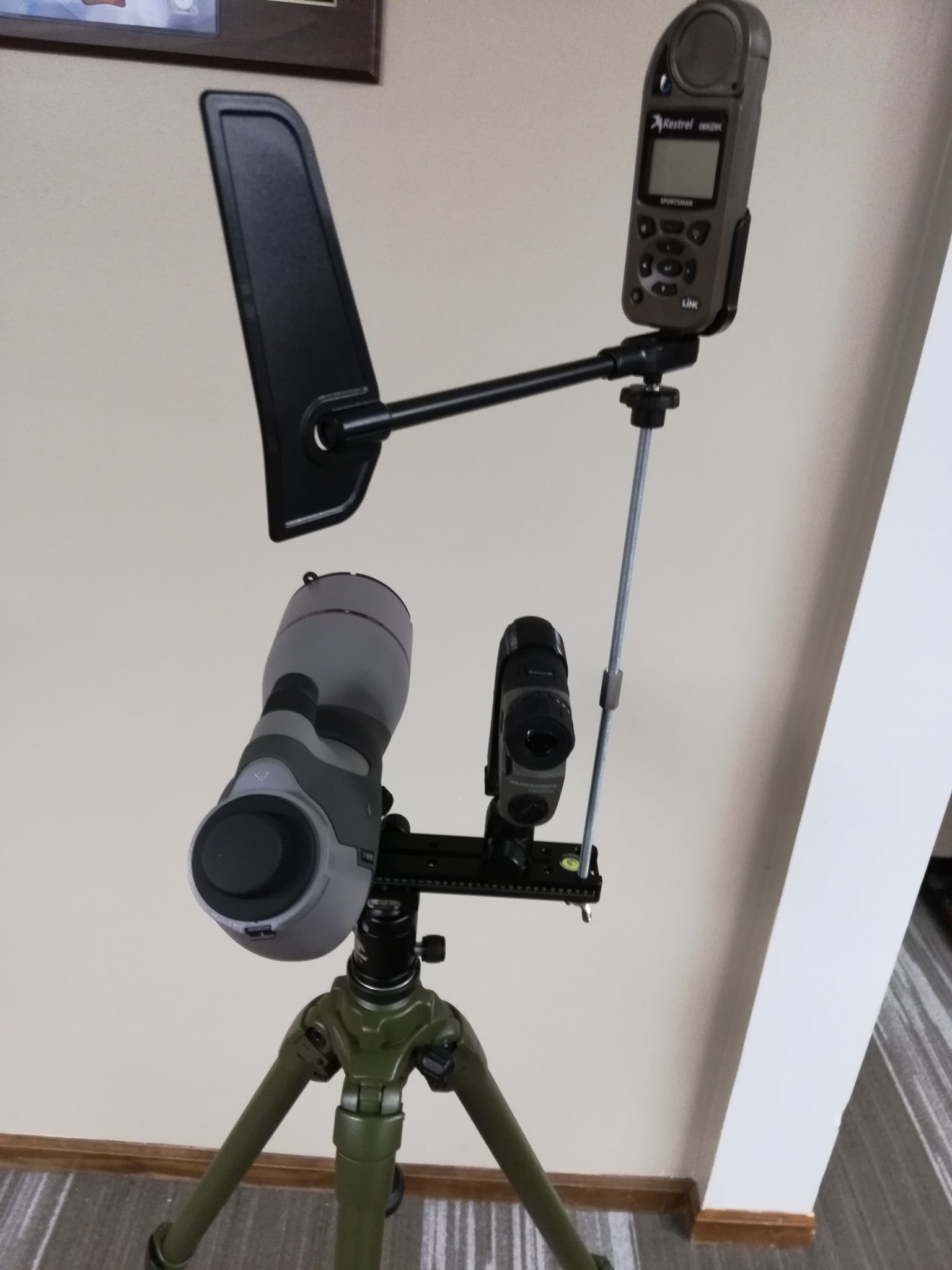

Right now, I'm thinking of going with this one.
If I have my LRF and Spotter on the rail, there wouldn't be enough room to let the Kestrel Vane rotate freely. I plan to get my Kestrel up higher than the Spotter/LFR through use of a threaded rod from Lowe's. 6in or 12in depending on how I can space everything together.
https://www.lowes.com/pd/Hillman-0-25-in-x-6-in-Standard-SAE-Threaded-Rod/50015976
If I've done my HW correctly, this matches the threaded holes in the rail and on the Kestrel. Thread it through a hole in the rail, secure the excess that I've threaded through the rail with a washer/wingnut or something, thread the Kestrel on the other end sticking up in the air, and done!

I have one of those double dovetail ones also. That one is long! I don’t think you need that much space but if that is what you want go for it?
I was thinking of putting the meter just up on a rotating ridiculous not a vane. Something that would have to be manually turned to match wind flags or my best quess.
I like the plentiful threaded holes vs. slots on this one. I thought It'd allow me to play with the spacing for the vane mount then possibly go smaller with Amazon return policy if need be. If I shortened the arm on the vane by a couple inches I may be able to just fit everything.

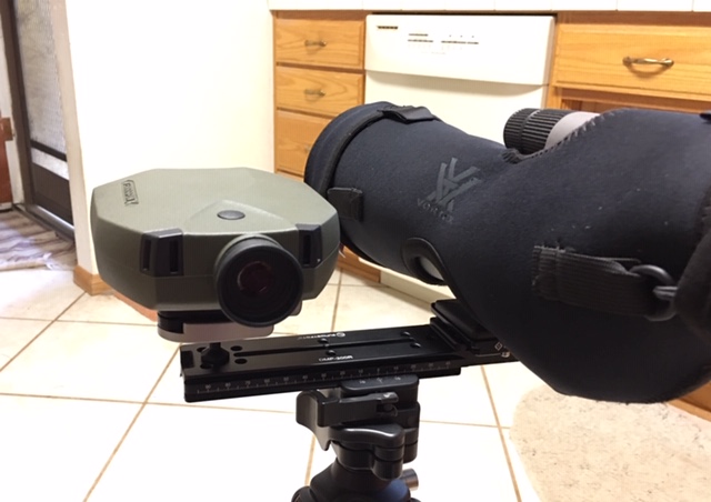

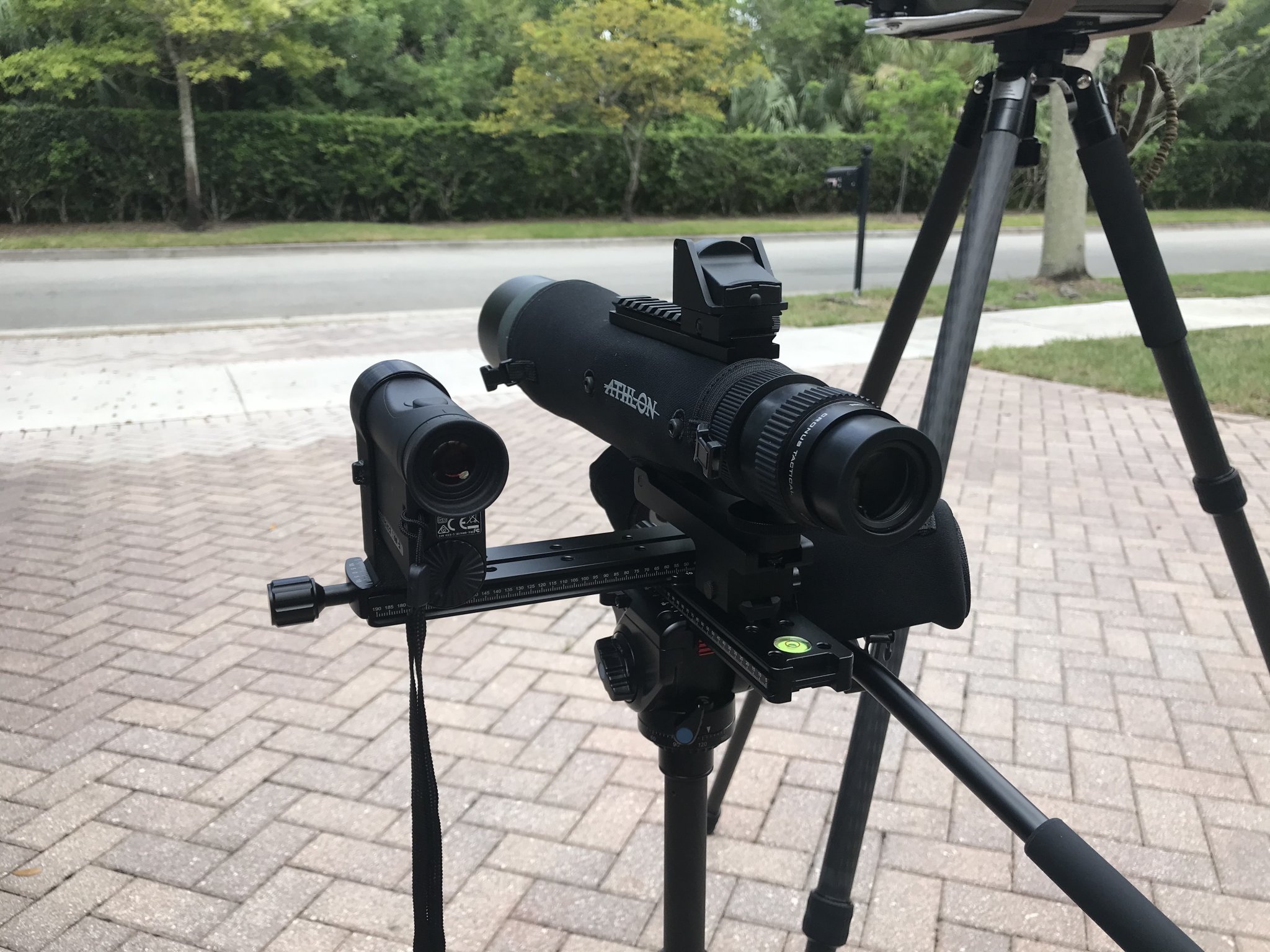

Another option is to use a 200mm rail with clamp on one end for the spotter and then mount a mini-ball on the other for your LRF. By doing this, you can get the spotter on target using the tripod's ball head and then use the mini-ball to get the LRF co-witnessed to the target. After that, just use the tripod's ball head to move your spotter and LRF to the target and everything will still be aligned.

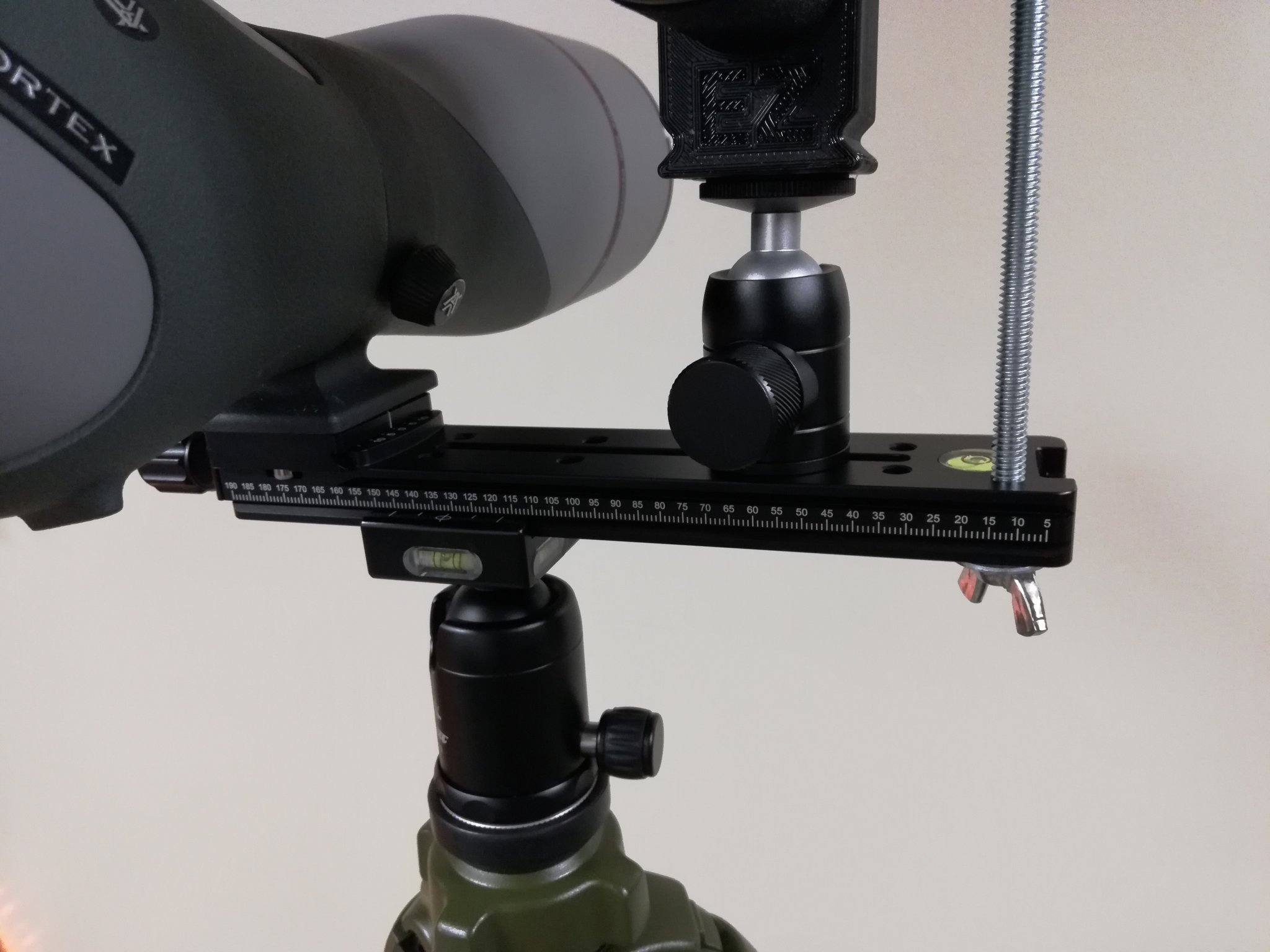

Here's the final product.
Arca rail. 200mm with built in clamp. https://www.amazon.com/dp/B00J7LT4ZK/ref=cm_sw_r_cp_apa_i_.FJoDbGT1NVMW
Mini Ball head to be able to cowitness the LRF mount. https://www.amazon.com/dp/B071GQLJKZ/ref=cm_sw_r_cp_apa_i_rHJoDbRHT8CQ6
2-6in lengths of 1/4-20 threaded rod with a coupler and wingnut from Lowe's for a couple bucks. Kestrel vane mount threads right on. By going with the smaller pieces they fit in the Kestrel pouch.

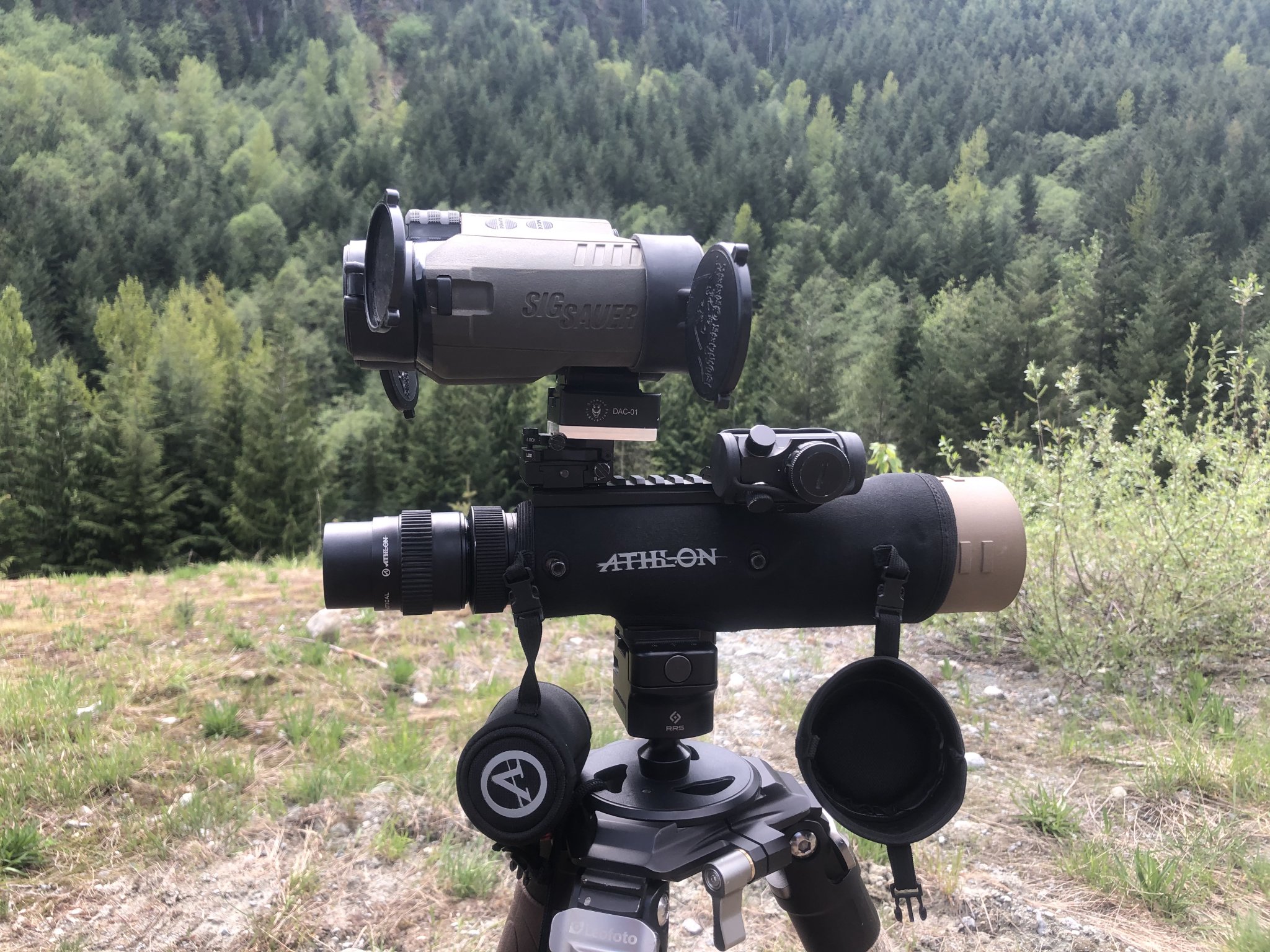

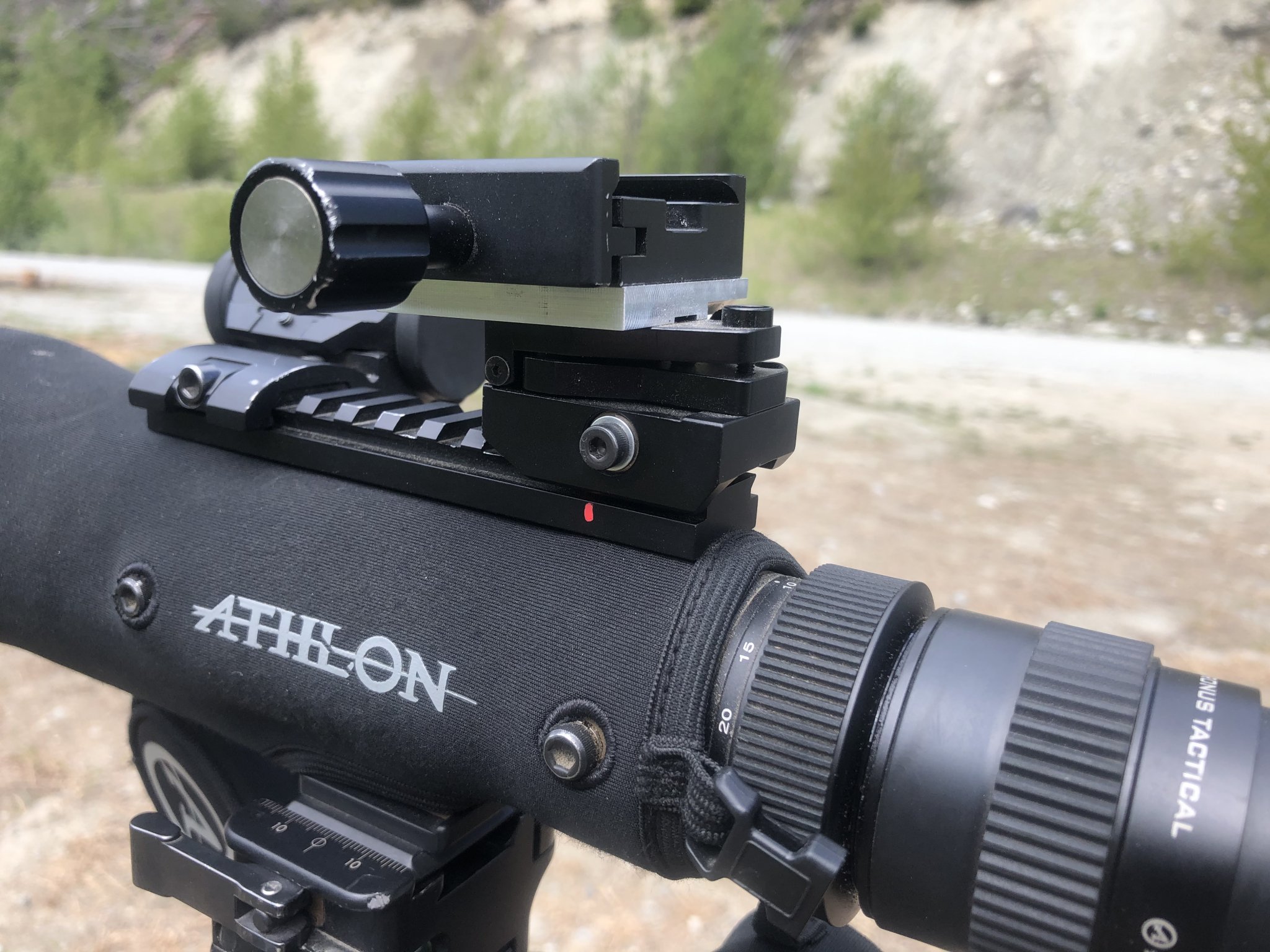

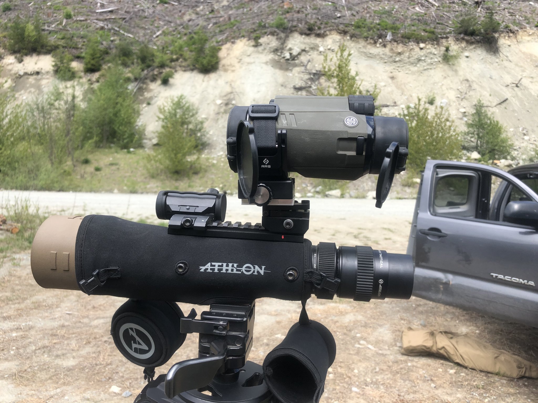

I used a long piece of arca rail before to mount spotter and LRF side by side but I didn't like the form factor. It was too big and I wanted to have a system that was a bit more modular. With most spotters with a reticle either having pic rails or the ability to add them via a "cage" of sorts (Badger Slick, Cadedx, KDG) it seemed to make sense to mount the LRF directly to the spotter. I also wanted to be able to "co-zero" the reticles of the spotter and LRF at whatever distance (I use 1000 yards) and have yet be able to remove the LRF (in my case Sig K3000 binos with the RRS Cinch) and re-install it quickly and with no loss of zero.
This is my setup:

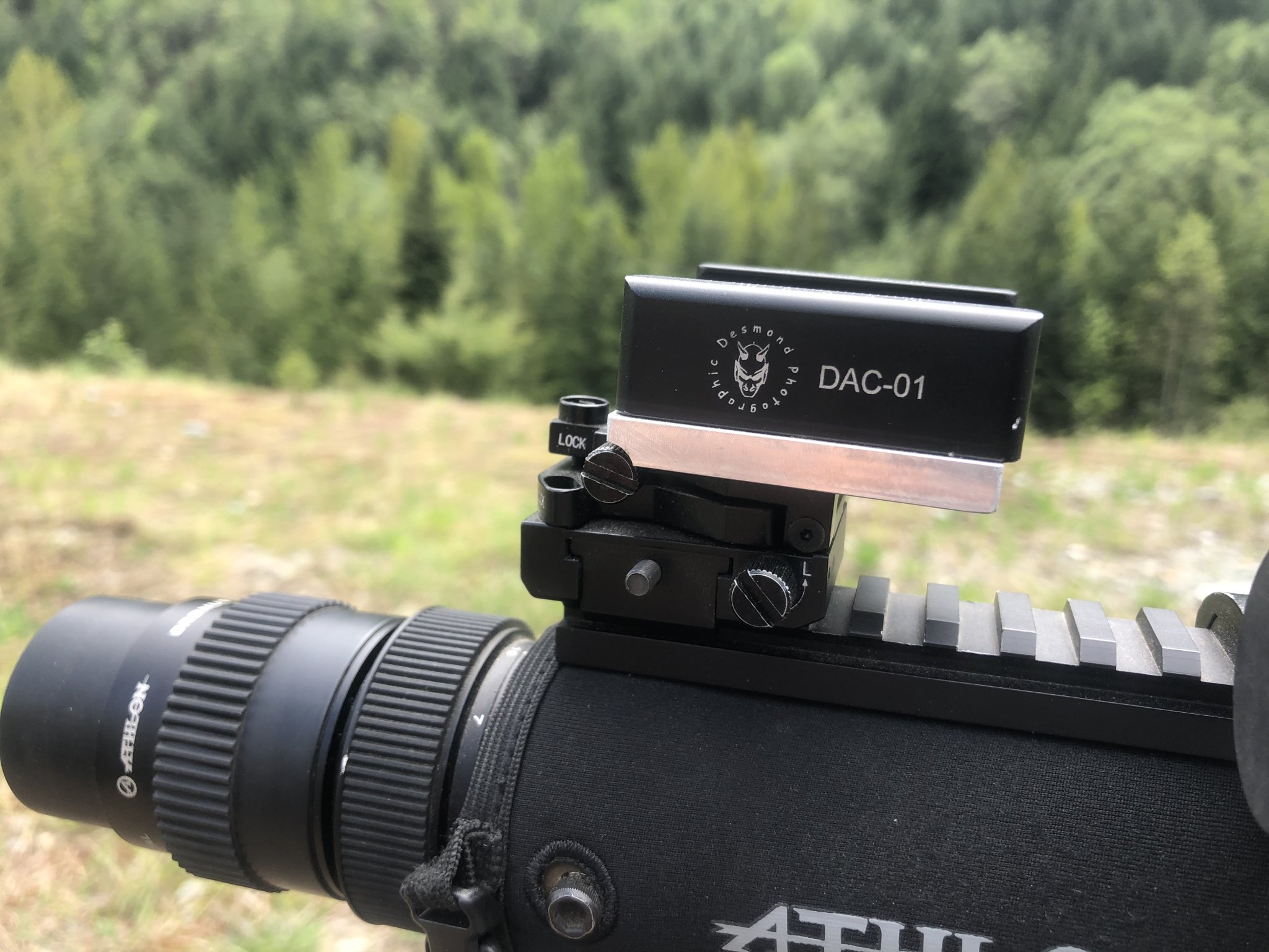

I had a buddy of mine with a machine shop help me make an adapter plate to to be able to mount a generic female arca clamp on top of a chicom "windage and elevation adjustable flashlight mount" I got from Alibaba. I honestly wasn't able to find a domestically manufactured one which is weird cause I figure for sure the chicoms had to be knocking off someone else's product but I digress. As it sits, the mount attaches directly to any pic rail and the "arca" clamp lets me attach anything with a dovetail on it. You can adjust the windage and elevation of the mount via thumbscrews and then lock them down with little Allen bolts. As long as I line up the back of the dovetail on the Cinch with the back of the clamp on the mount, the system maintains zero every time it's re-assembled.
There are a few small improvements I'd like to make: slimming down the thumbscrew so it's more low profile and doesn't protrude as much from the side of the spotter, drilling and threading a hole inside the clamp so that I can screw a bolt in that will act as a hard stop for the cinch so as to nt even have to think of aligning the rear of the plate and clamp and Cerakote or rattle can the adapter to make it "not shiny", haha.
If I had the skills, I'd love to design an adapter like this instead of a modification to an existing mount. I figure designed as an integrated unit, it would be much more low profile. Sadly, that's not really in my wheelhouse, haha.

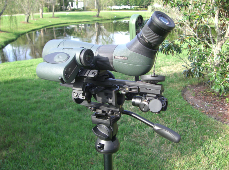

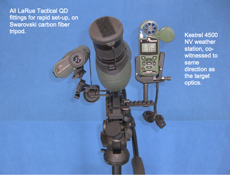

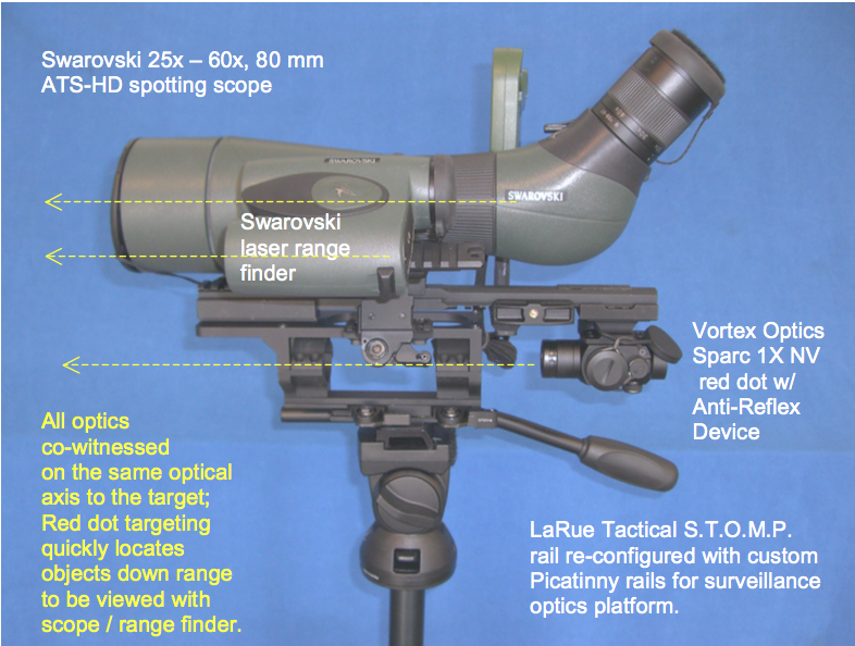

I set mine up with a LaRue STOMP picatinny rail host with a few modifications and QD fittings.
Why didn't you just use the factory LRF mount?
I actually built that mount before I got the Athlon spotter (had a Bushy Legend T) but I like it better than the factory one. The factory one is only adjustable for elevation and you can't lock your adjustment in. Sure you can adjust windage when/if you install an arca clamp but then you either have to loctite/witness mark/jb weld it in place. Also, the factory mount is about twice as big.

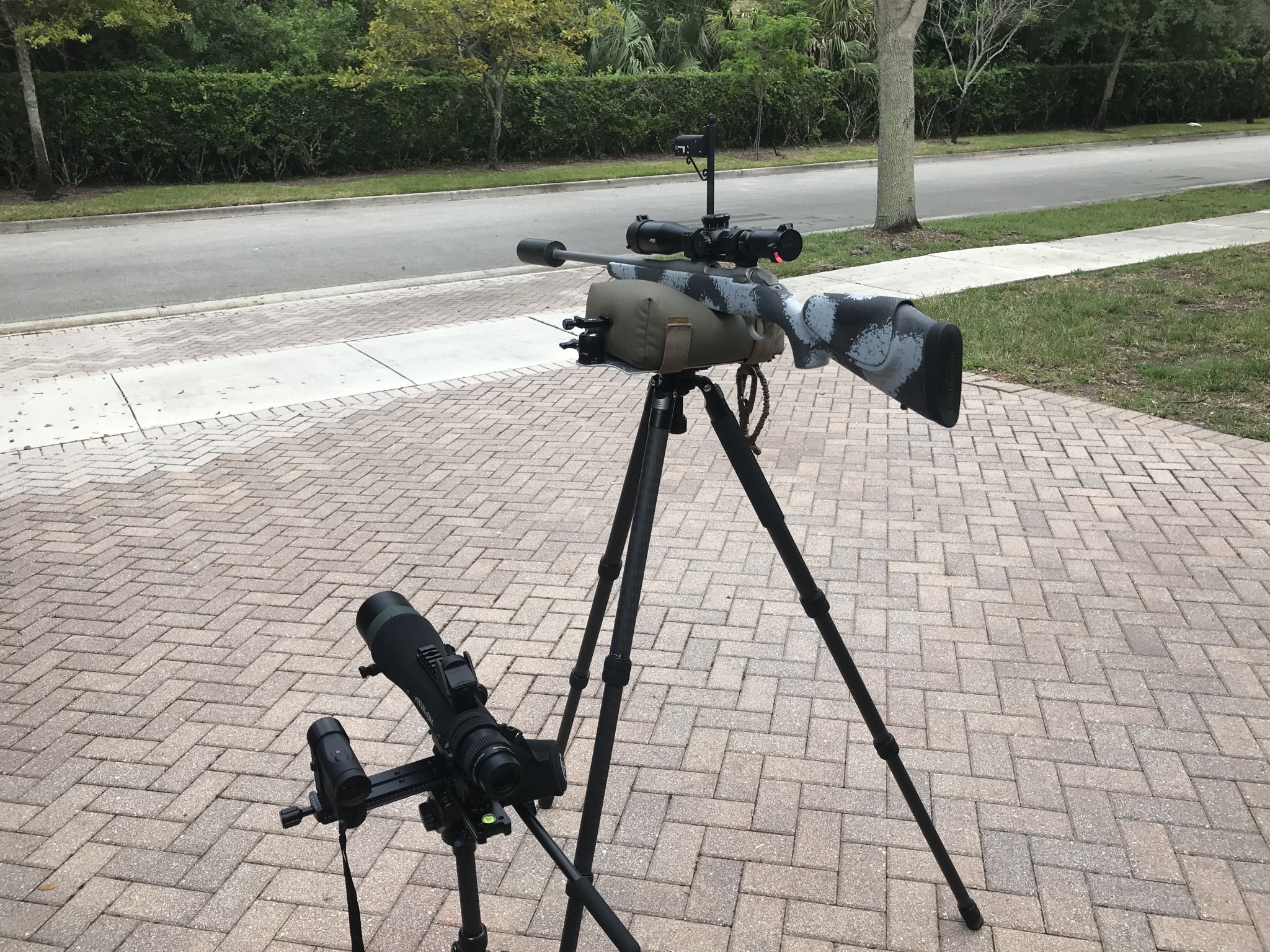

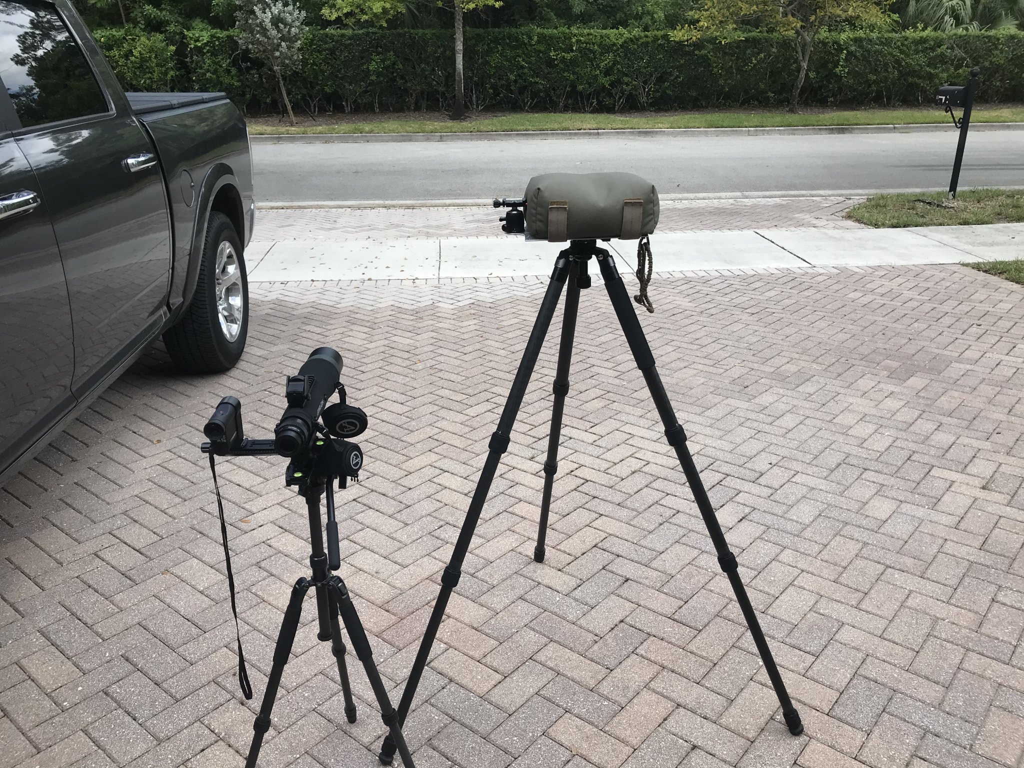

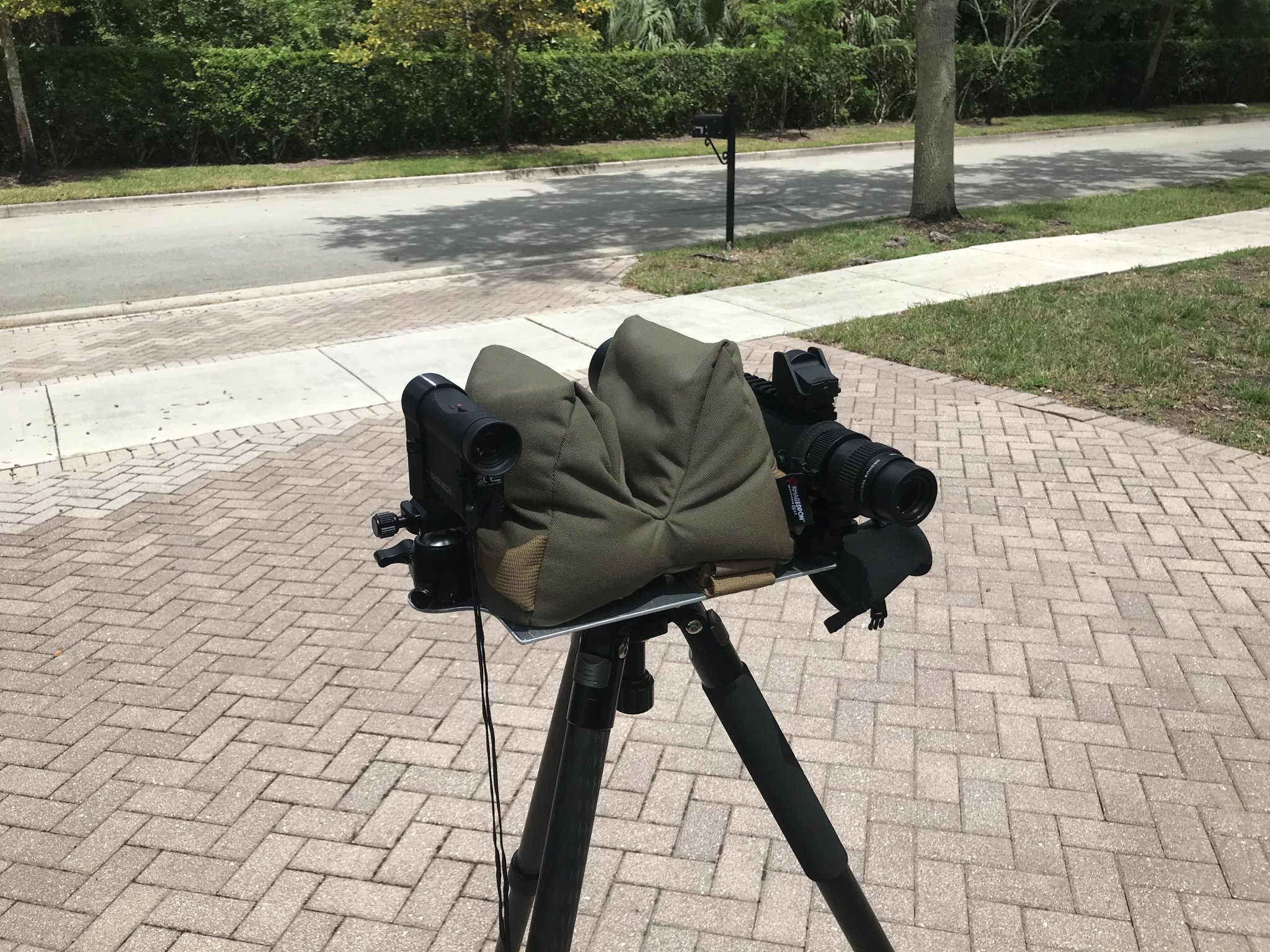

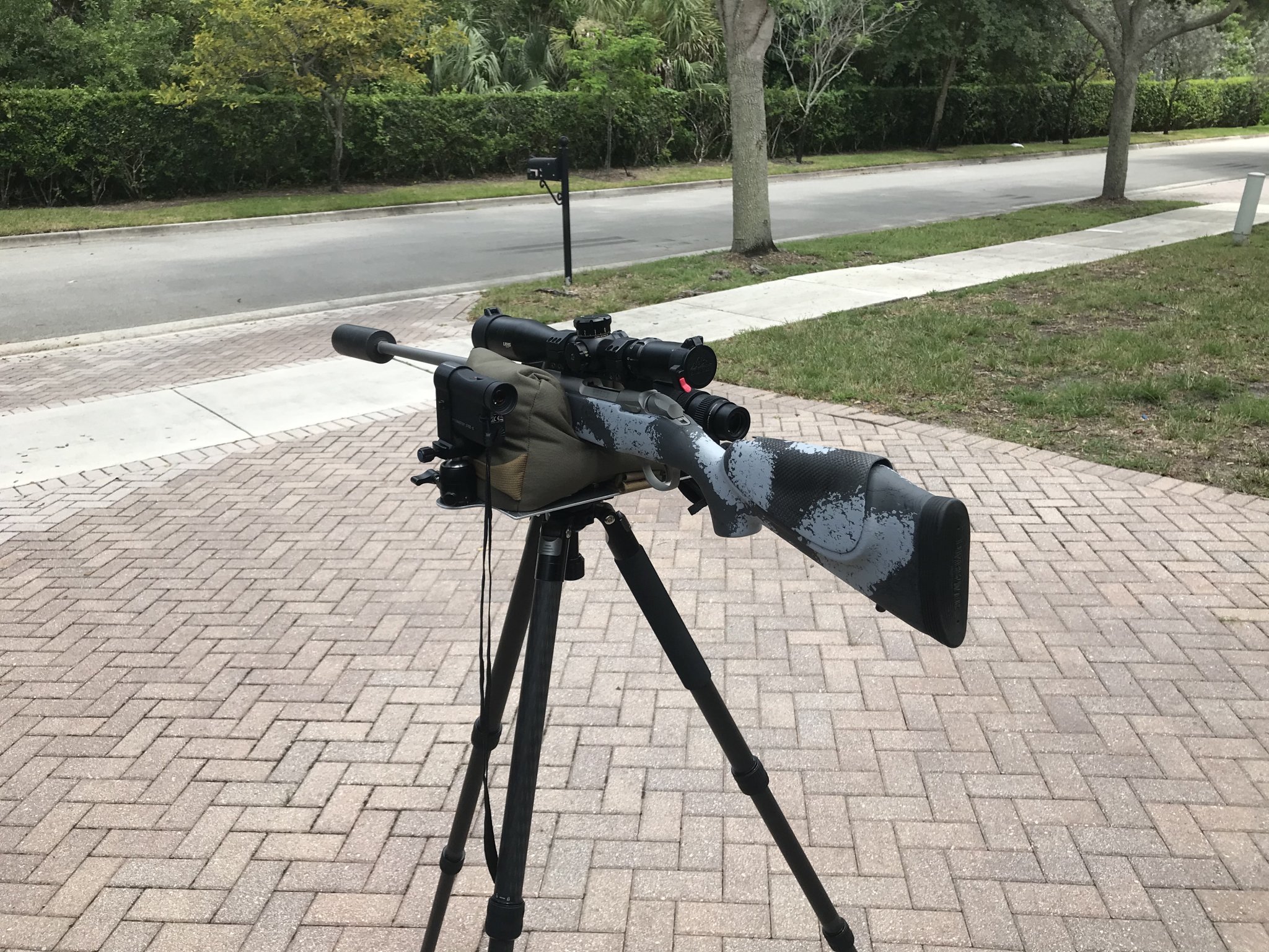

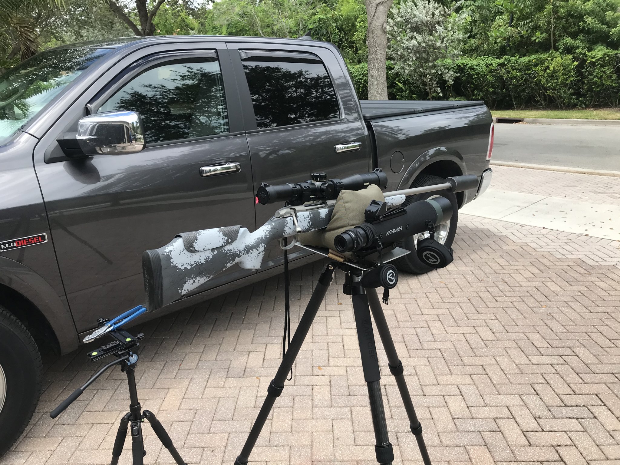

Here's my spotter/LRF and LRF/shooting setup. Atholon Cronus is setup with Trijicon red dot and the shooting table has Sirui micro ball for LFR. I've cut out the table from scrap aluminum plate and have few heavy and light fill bags to use for rifle rest.

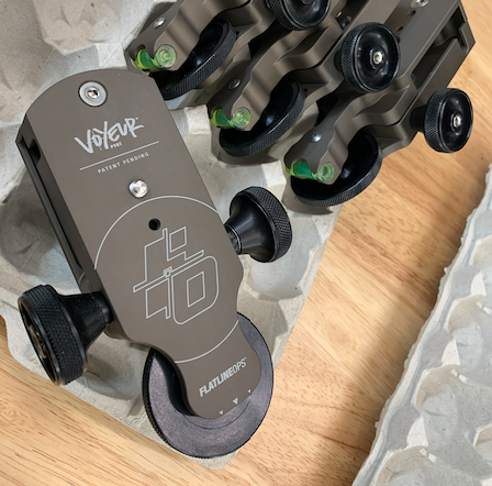

FYI, I was running into the same issue, a hide member pointed me to FlatlineOps. They have a very well made unit called the Voyeur. It is a bit pricey but made in the USA and designed for precision optics. You might want to check it out.
