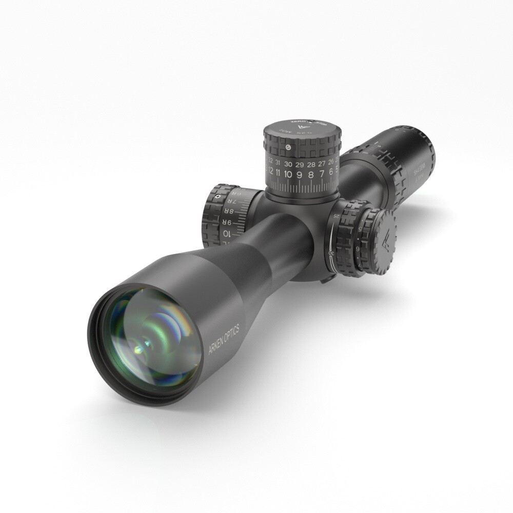

I'm not much into recommending Chinese made scopes, but if you don't mind the wait, this would be an excellent choice, they also have a mil version:

Arken's web site says it's more like a 16 week wait (as in 4 months). So order one now and find something cheap to get you by until it comes in or move on with another brand.
If you can wait the 16 weeks the Arken SH4 is a great buy as well. Testing one on my RPRimfire myself. if you going to order one though and then order another scope to tide you over. It won't be worth it. Just get the Argos Gen 2.
If you can wait the 16 weeks the Arken SH4 is a great buy as well. Testing one on my RPRimfire myself. if you going to order one though and then order another scope to tide you over. It won't be worth it. Kust get the Argos Gen 2. View attachment 7581322
I had an Arken EP-4 on a centerfire rifle. I sold it when I sold that rifle. It is a very good scope for the money. I'm sure the Arken SH4 Gen 2 is a another very good scope for the money. I was unwilling to wait months for one and while considering my options ran across a deal on a Vortex DB. I'll be using the DB until things settle down and other options become available at reasonable prices. The DB has not disappointed though.

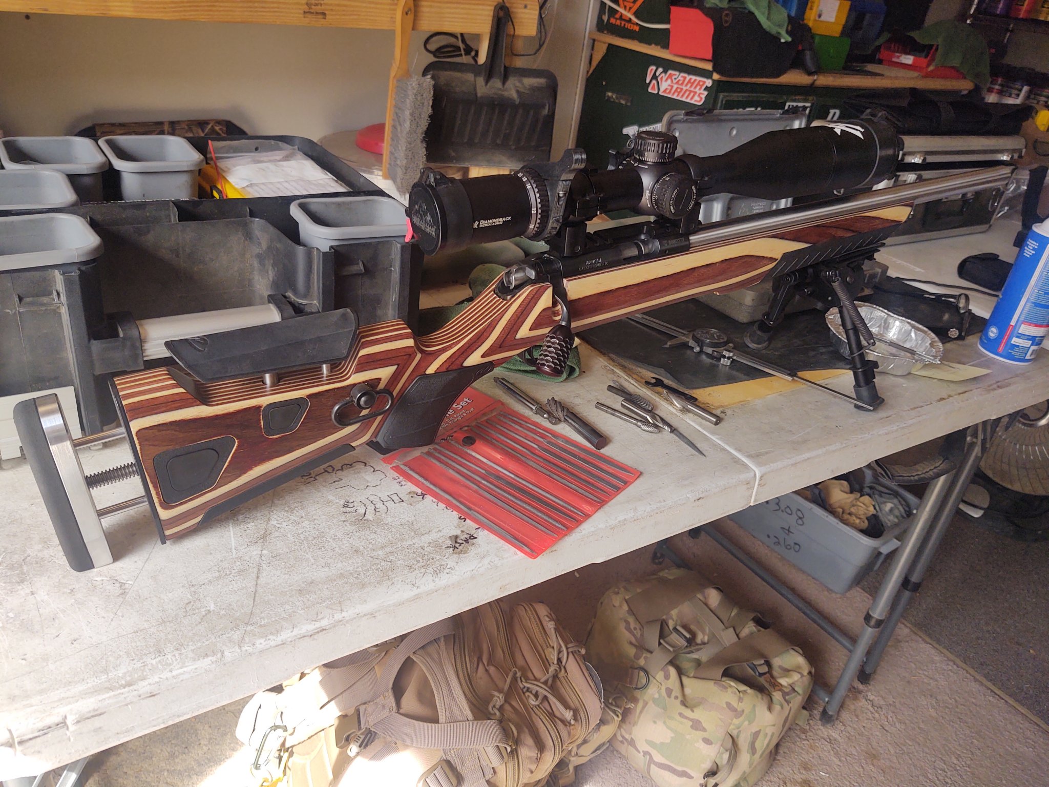

May not be the place to ask ,but anyone have a 34mm scope on a cz455? Cant find any rings high enough for the bolt throw? Any help? Now i know why i shoot a vudoo this is my wifes rifle. Thamks
Are you not running a rail? I’ve only got a 30mm on mine, but it’s on the DIP rail, which is much shorter than the Area 419 that’s so popular. No scope clearance issues on the stock bolt.
I tried the swept bolt handle with aftermarket knob, though, and was a hard No on that. Even with the 419 rail that I bought specifically to run that bolt handle, the knob hits my trigger finger when I have it in my preferred orientation, bent 90 degrees at the middle knuckle. You can even see it in AO’s video, the guy is having to angle his trigger finger under the bolt knob.
So some JB Weld and online ordering later, I have another knob just screwed up against the stock knob, much better grip although it’s not the prettiest. Clears the scope tho :-D
It has a dip 25 moa rail with the anarchy ourdoor swept bolt handle, we ordered a vortex strike eagle 5-25x56 mrad it has a 34mm tube finding the right rings has been a nightmare, at the moment it is sitting in a vortex diamondback tactical mrad with extra high rings... Just cant find high or extra high rings in 34mm and know with confidence it will work.

This was my rifle for awhile then i bought a vudoo, she wanted it in a different stock so i pillar bedded and glas bedded this boyds at one stock for her she liked it, she is trying a bolt gun for awhile before dropping 3k on another vudoo, we both have kidd supergrade 1022s as well then i went vudoo so this is the reason and its turned into a hard find on the rings for the cz and 34mm rings. Thanks

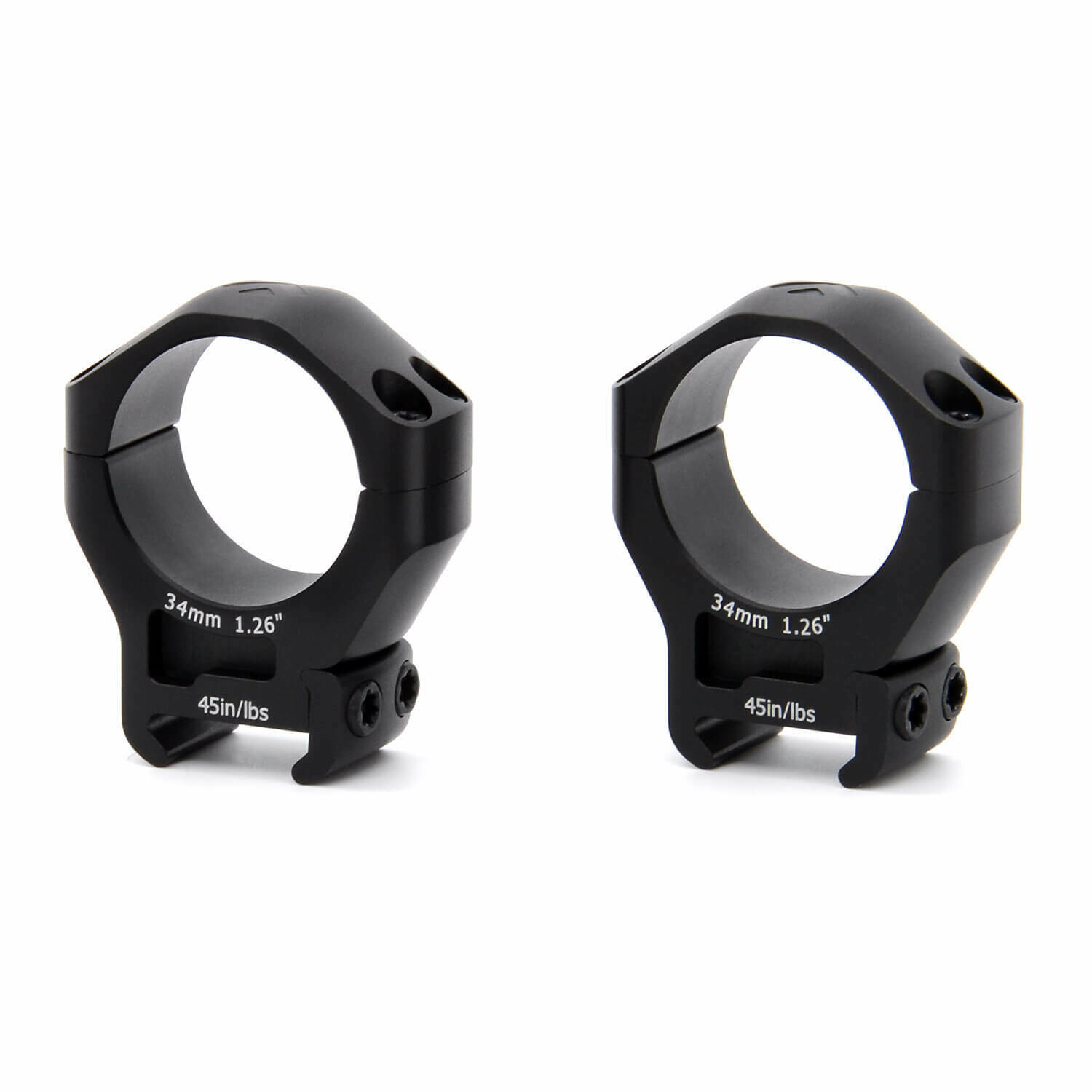

Try Arken Optics for rings. I have a set of their lows and like them. A buddy is running there High and they are High. Its not on a CZ though.
Maybe not exactly what your looking for, but I know of 2 guys that are using the Wheeler brand rings with Strike Eagles on 457's. Maybe worth a look.
I have a set of the wheeler's, couldn't get the level to work worth a fuck, but I really like the rings, especially for the price.
