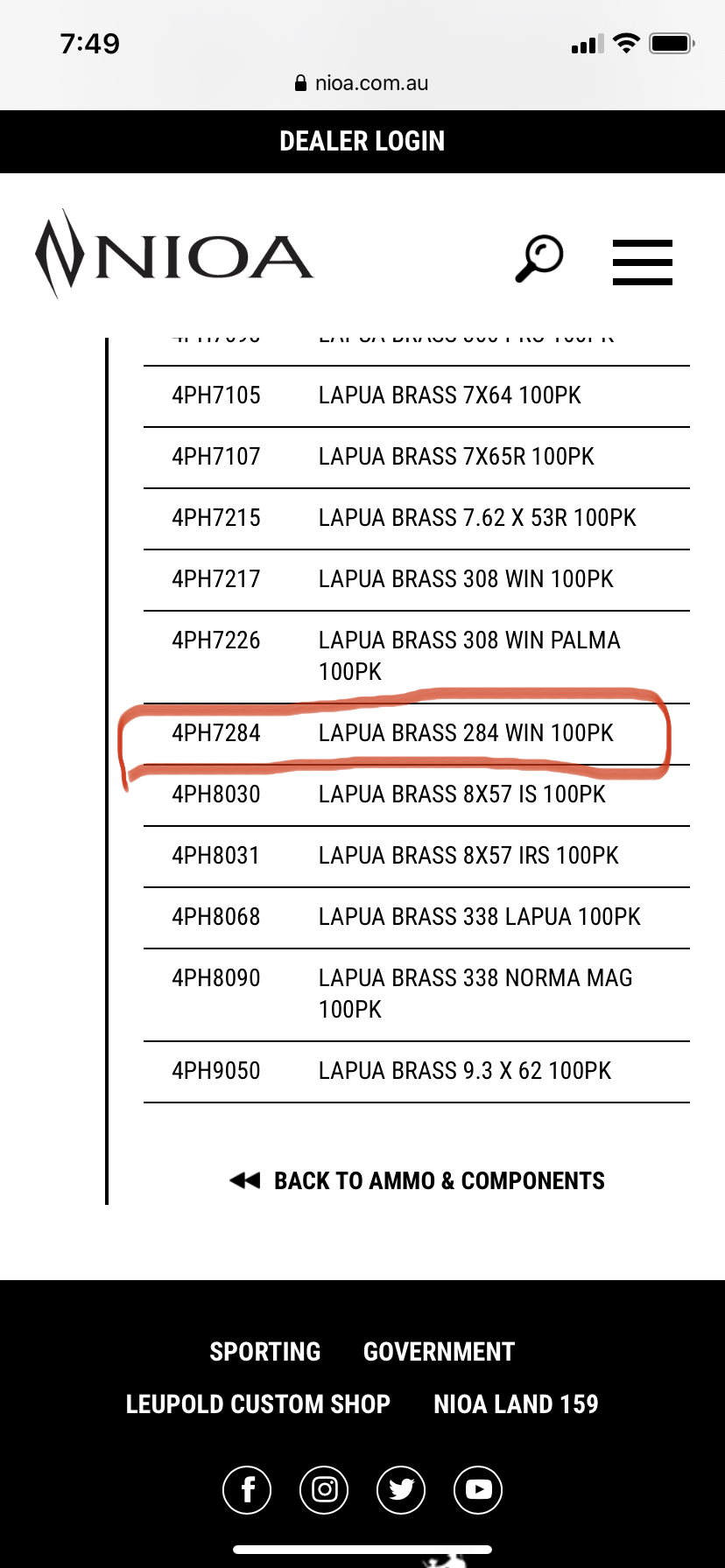

This future release makes the 284 Win even more attractive for you.
Reactions: XLR308
