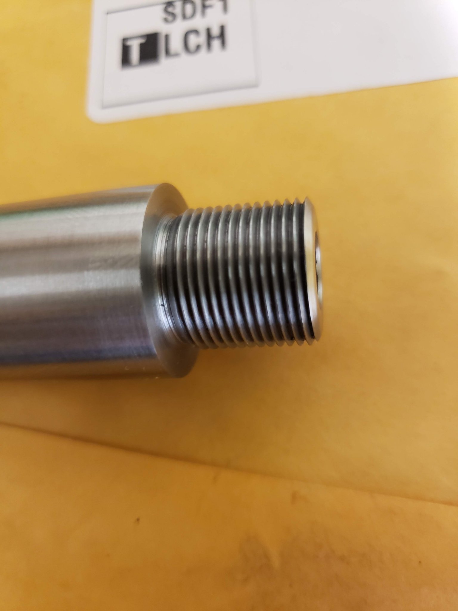

I also have some unknown steel that I cut on yesterday and it was tough and gummy. I thought it was cold rolled but I think I was wrong, was super tough to tap too. Not at all like the stainless barrel I was cutting on.

303/304 is gummy. Gun barrels are typically 416 which machines a lot easier.
What tooling are you using? I mostly use tools with inserts but Harbor freight sells carbide tooling that is great for the money. I use them to make custom shaped tooling.

I have cut on 300 series stainless before and it is a bear, but this tough stuff wasnt stainless tho.
All of my tooling is indexable carbide with the exception of my parting tool. I cut these 5/8-24 threads yesterday afternoon.
