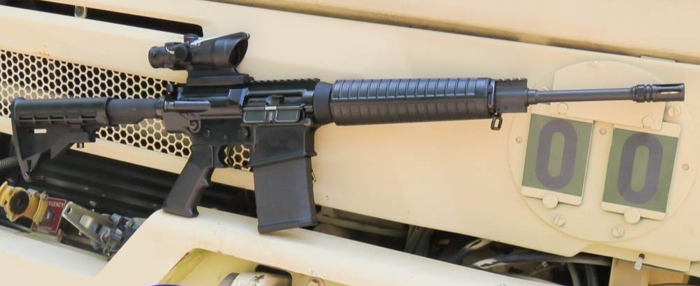

Basic Armalite DEF-10.

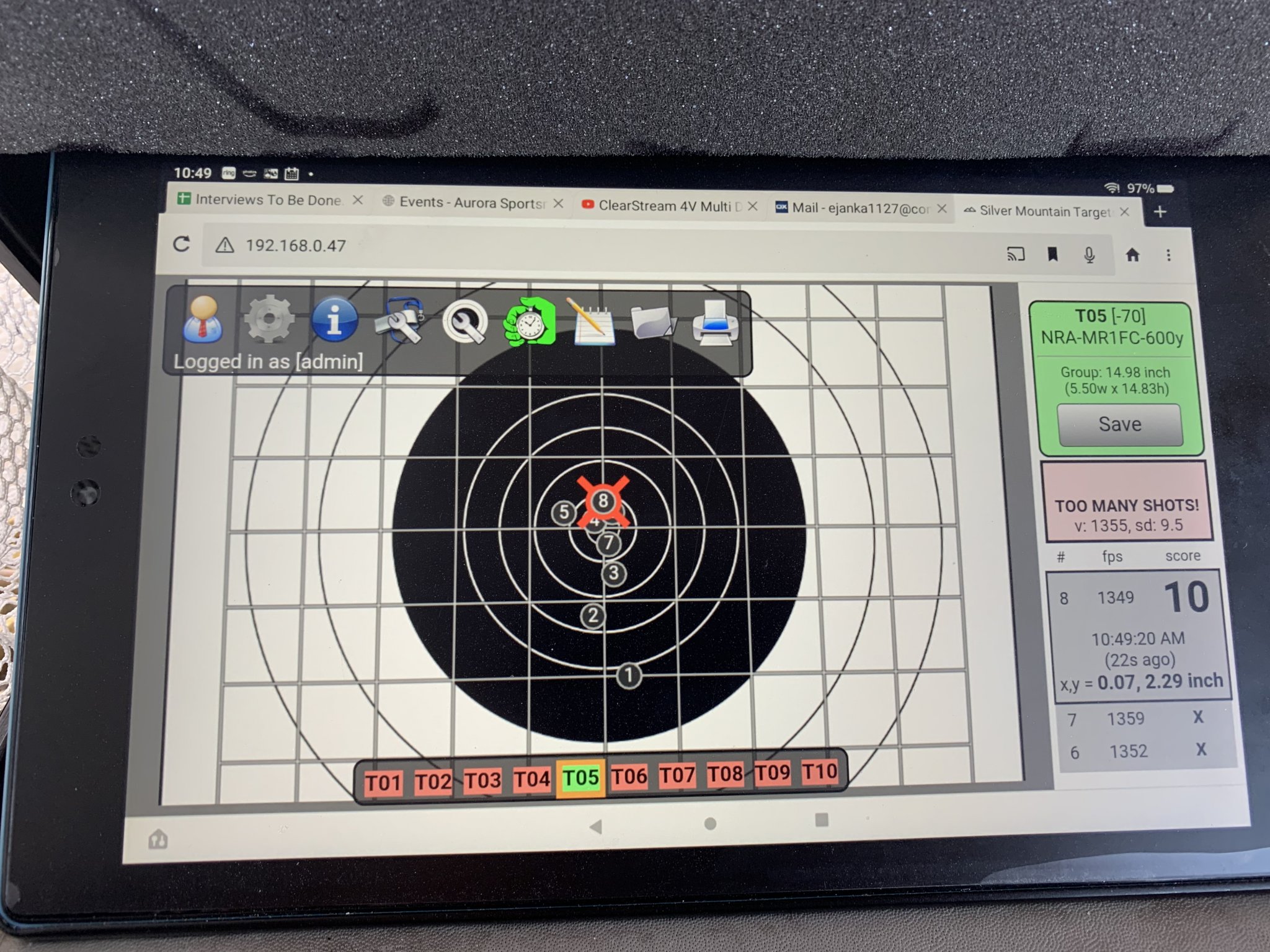

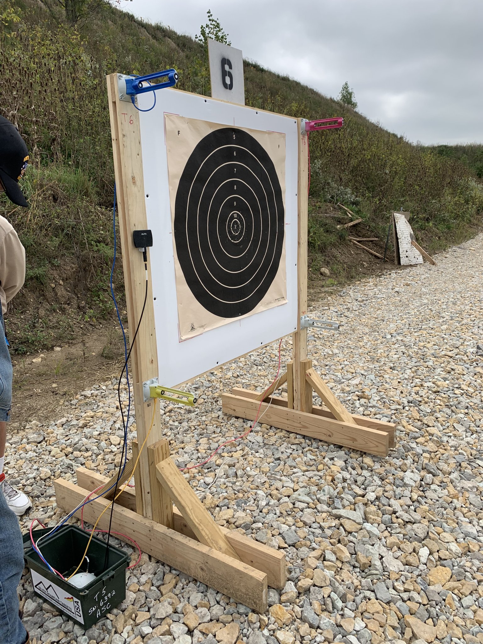

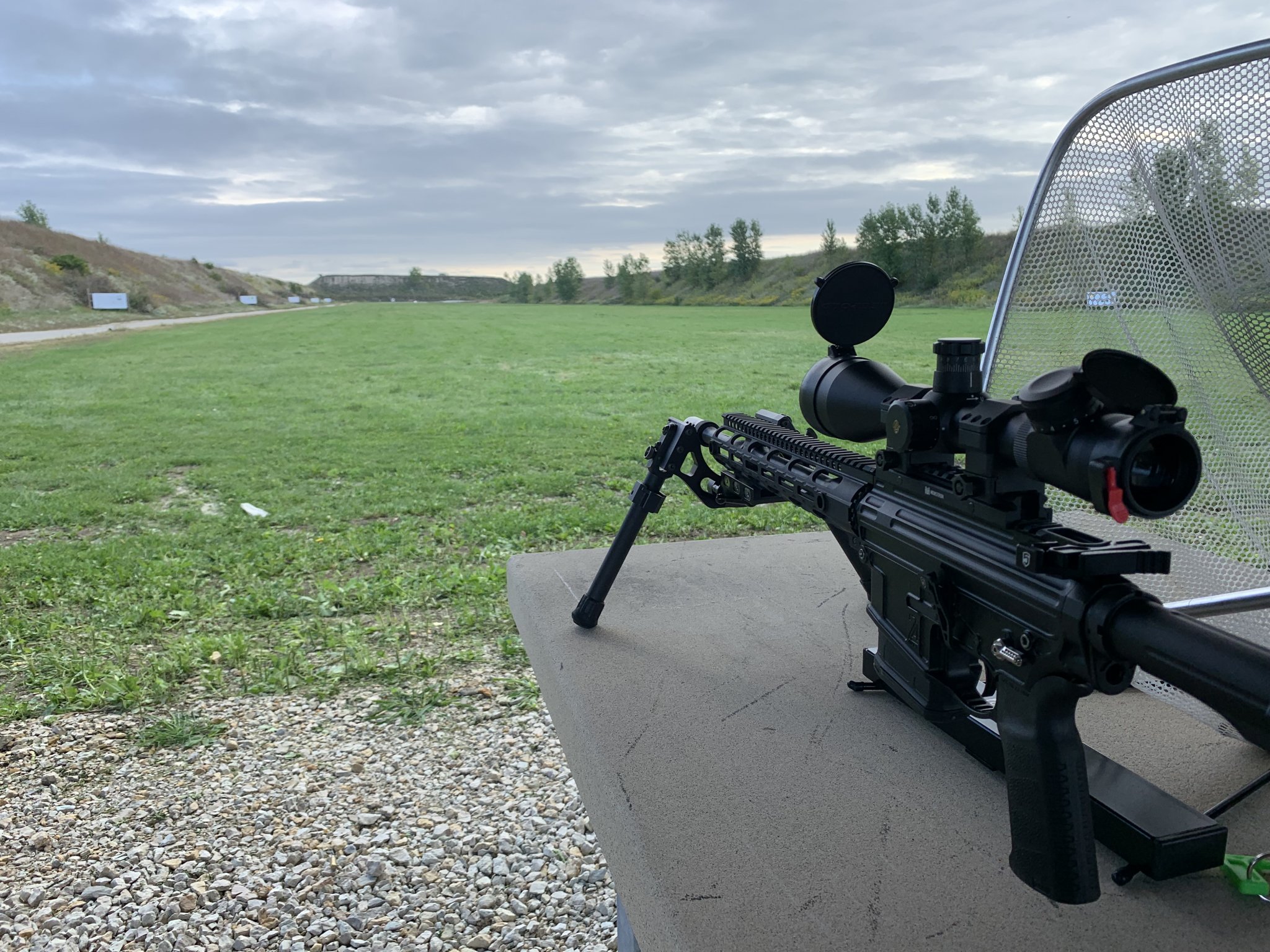

My 16” Faxon Gunner 308 is a 1 moa barrel with good ammo. Here’s a picture at 600 yards with 168 FGMM as I walked my shots into the center. The inner circle is 6”. The gun is a 2A upper and lower set. Without optics, bipod and magazine it weights 5.9#. Lots of titanium parts in it.

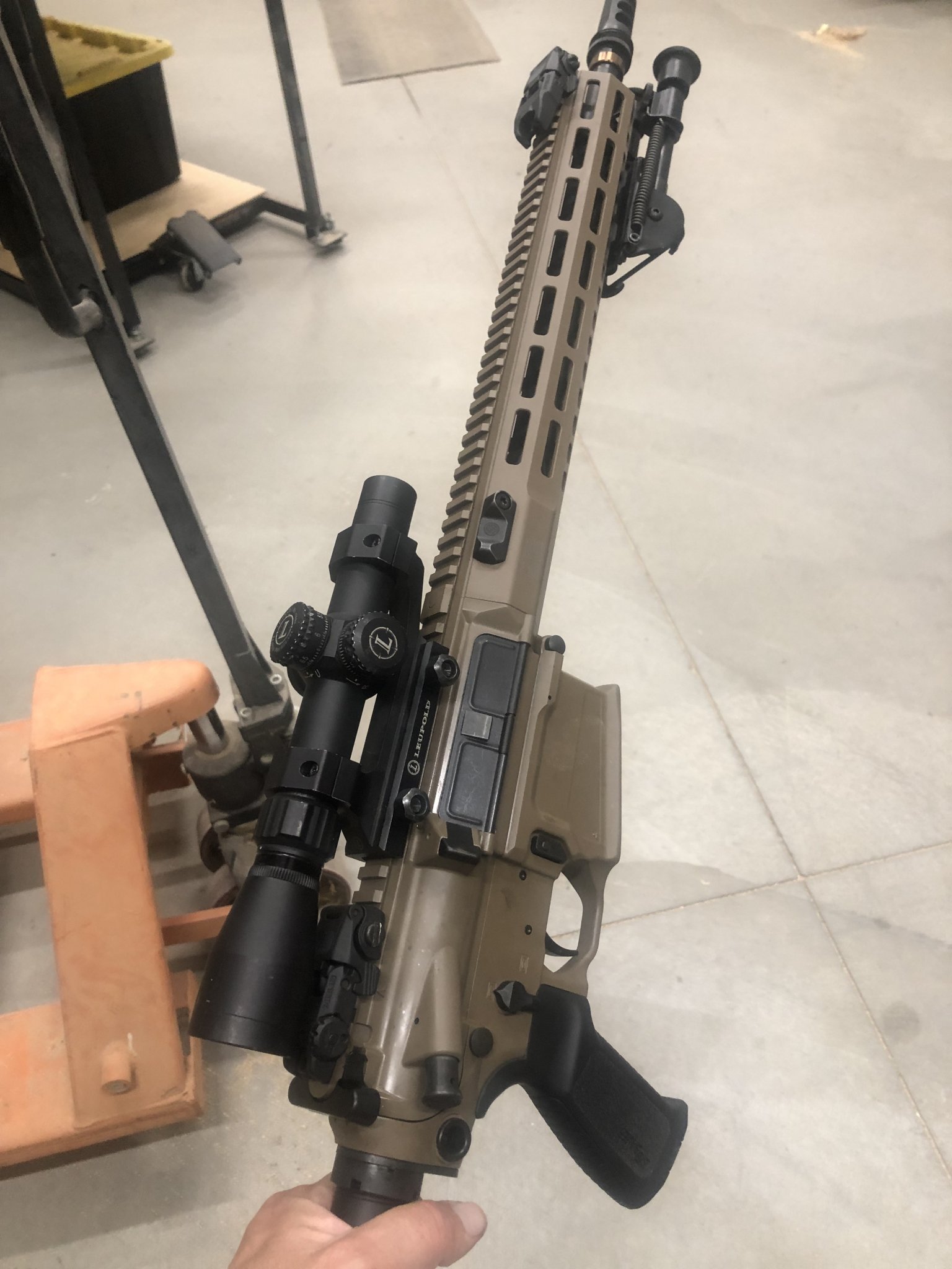

My AR-10 was purpose built to be lightweight (for a 10 anyway), and has a 16” Faxon pencil profile .308 barrel. I haven’t taken it out past 200 or so yards though…no need, at least for the scrub brush hog hunting I use it for here in Texas.
Can’t remember if this was a 50 or 100-yd zero when it had a different scope; probably a 50-yd zero for that kind of grouping…I’m frankly not that good of a shot, at least not usually quite that good at 100. LoL
Edit: Just weighed the BCGs I have for this one, and realize I really need to get this one back to the range and tune it for more reliable/consistent operation with the light(er) weight V7 carrier… Pic above is with the heavier BCG in place; this one:
Runs like a top with that full mass KAK carrier, but 6 ounces is a lot of mass to drop if I can get it to work; would drop my total rifle weight with optic to well under 8#
