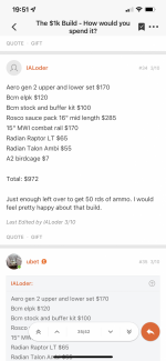

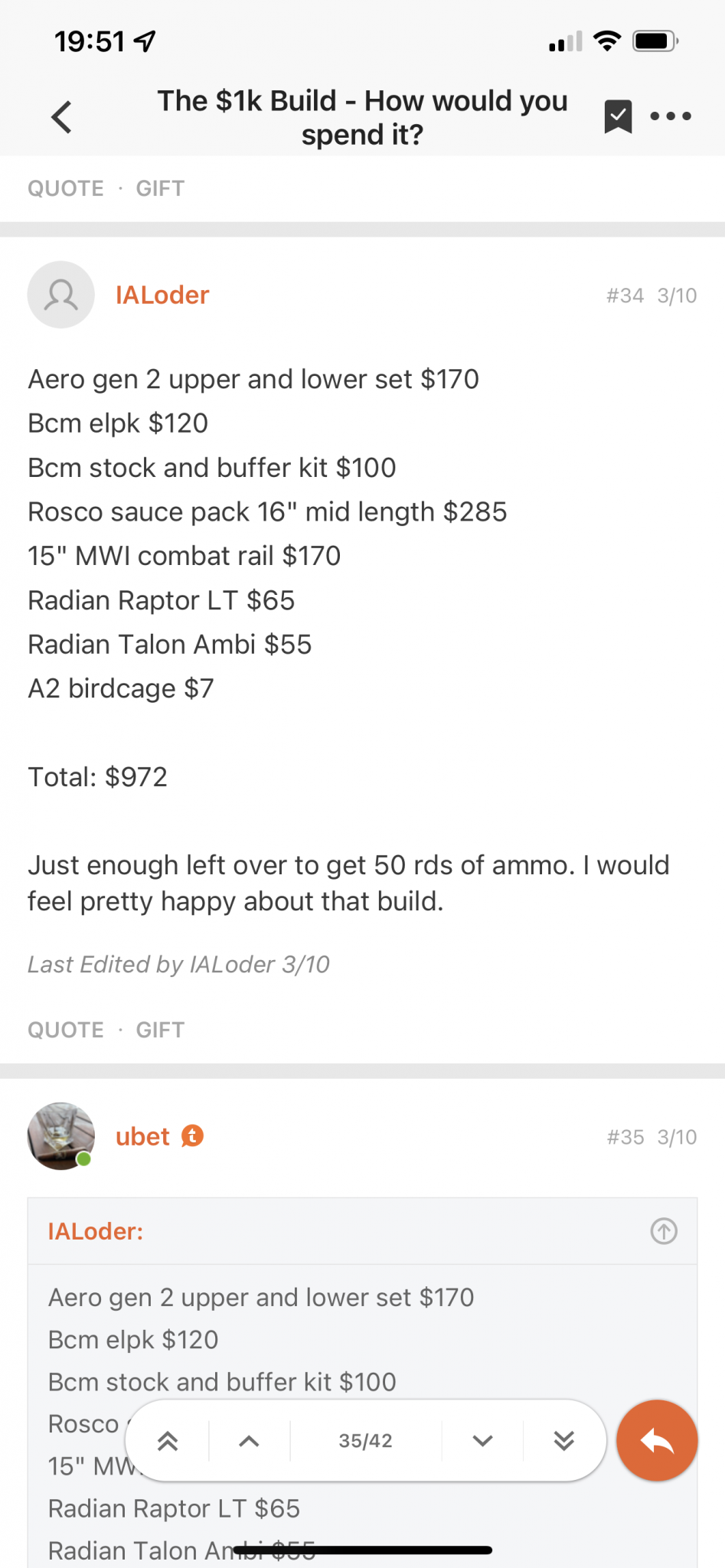

I'm looking for HD and plinking. Budget I'm looking to keep it under 1000 bucks for just the rifle. Found the scope I want to put on it already. Vortex Viper PST Gen II 1-6x24 VMR-2 Moa. What are your guys thoughts on different calibers? I have a 6.5 creedmoor and reload for it already, and planned to reload for this rifle. Or I was looking at the .223 wilde.
This question was just discussed on m4carbine. This is the one I’d go with if I were you, in the screen shot. The parts kits, you can get into a Wilson lpk and an agl trigger too and be under $1000. Bcm has bcg in stock right now too, or go with sionics or colt, all three are good to go. Dont go with psa. If you have $1000 to spend, build a better rifle than psa. And here is the link for the thread. https://www.m4carbine.net/showthread.php?234664-The-1k-Build-How-would-you-spend-it
I have the scope you’re talking about and really like it on my ar.
