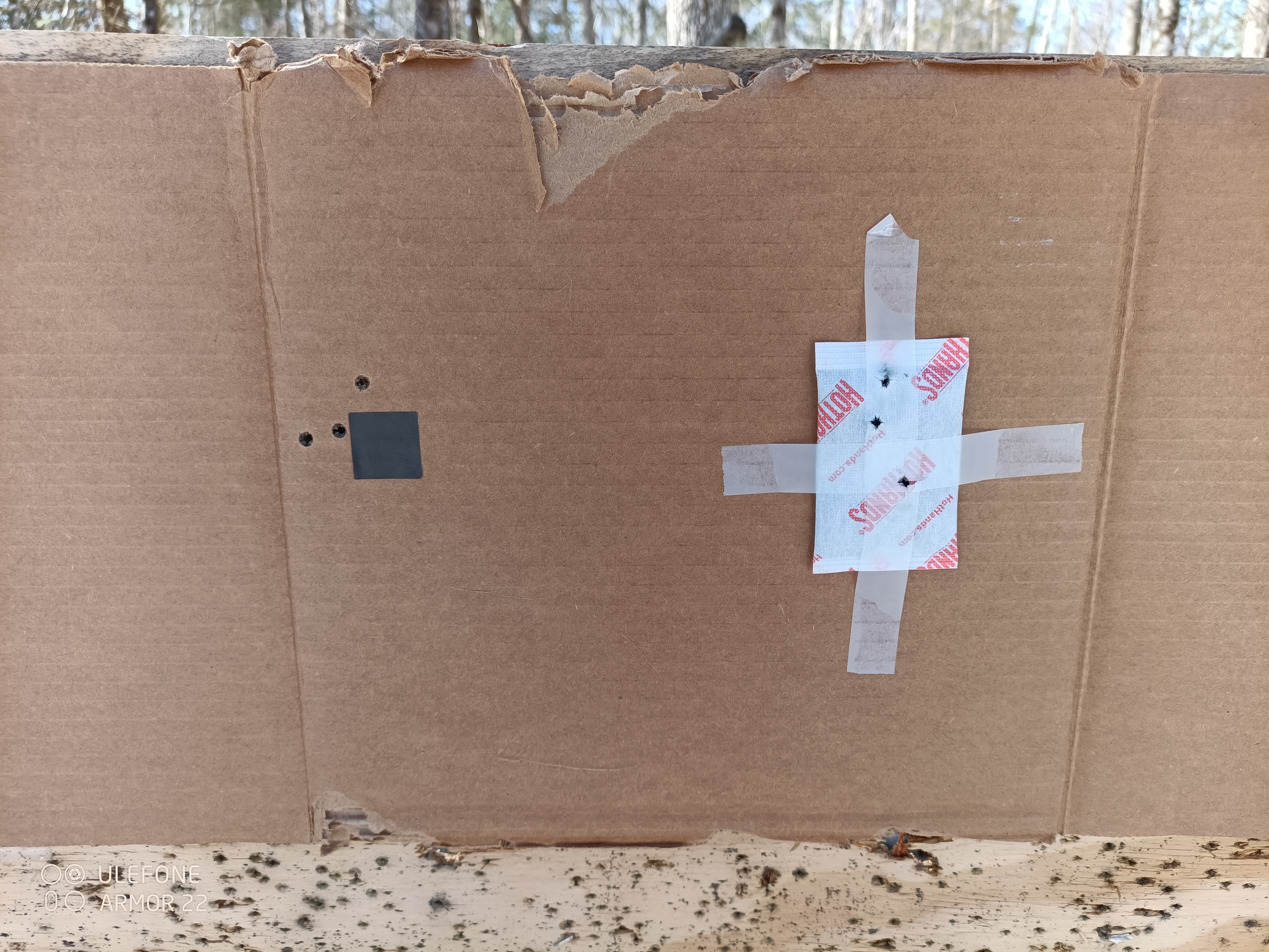

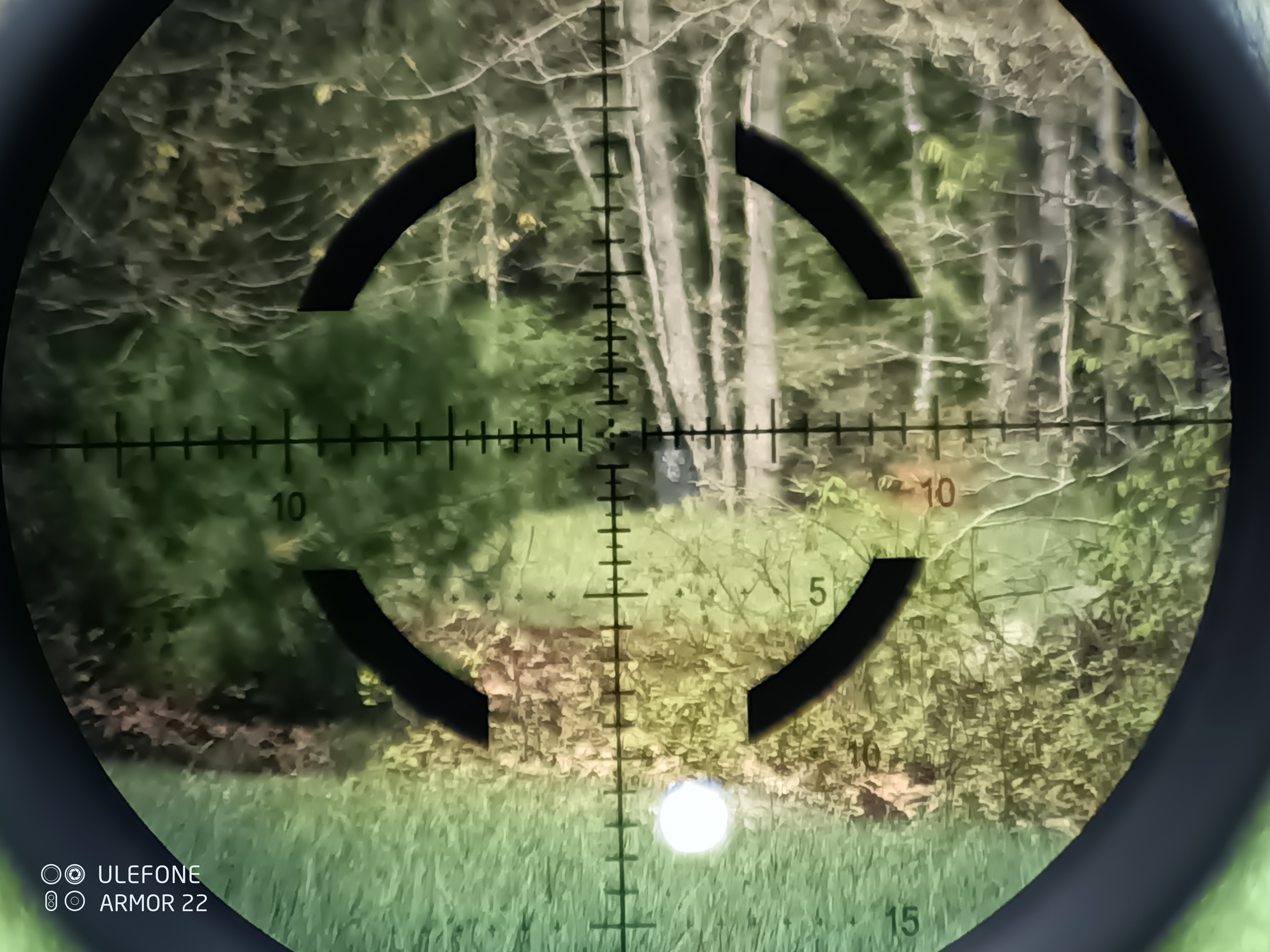

I guess we will have to take your word for it as that vid did nothing to show the POA/POI. ;)
Sorry I don't have a Triggercam yet unfortunately lol. But I was holding 1 mil at 300 and didn't change that between having the thermal on or off. That was my first time shooting it at that distance so I thought I'd just record it. First photo was me testing POI shift at 100 yards, second photo was the target I was shooting at on that day of the video.

Do you get repeatable results with the wilcox mount?
I get repeatable results when clipping it in and out of the mount like I do in the video. As far as flipping it to the side and back I have only tried it one time and it was when I took that picture I posted previously of the POI shift at 100 yards. I shot the group without thermal first and then flipped it over. I don't mind the wilcox mount but I'd certainly prefer an ADM mount attached to the Thermal.
