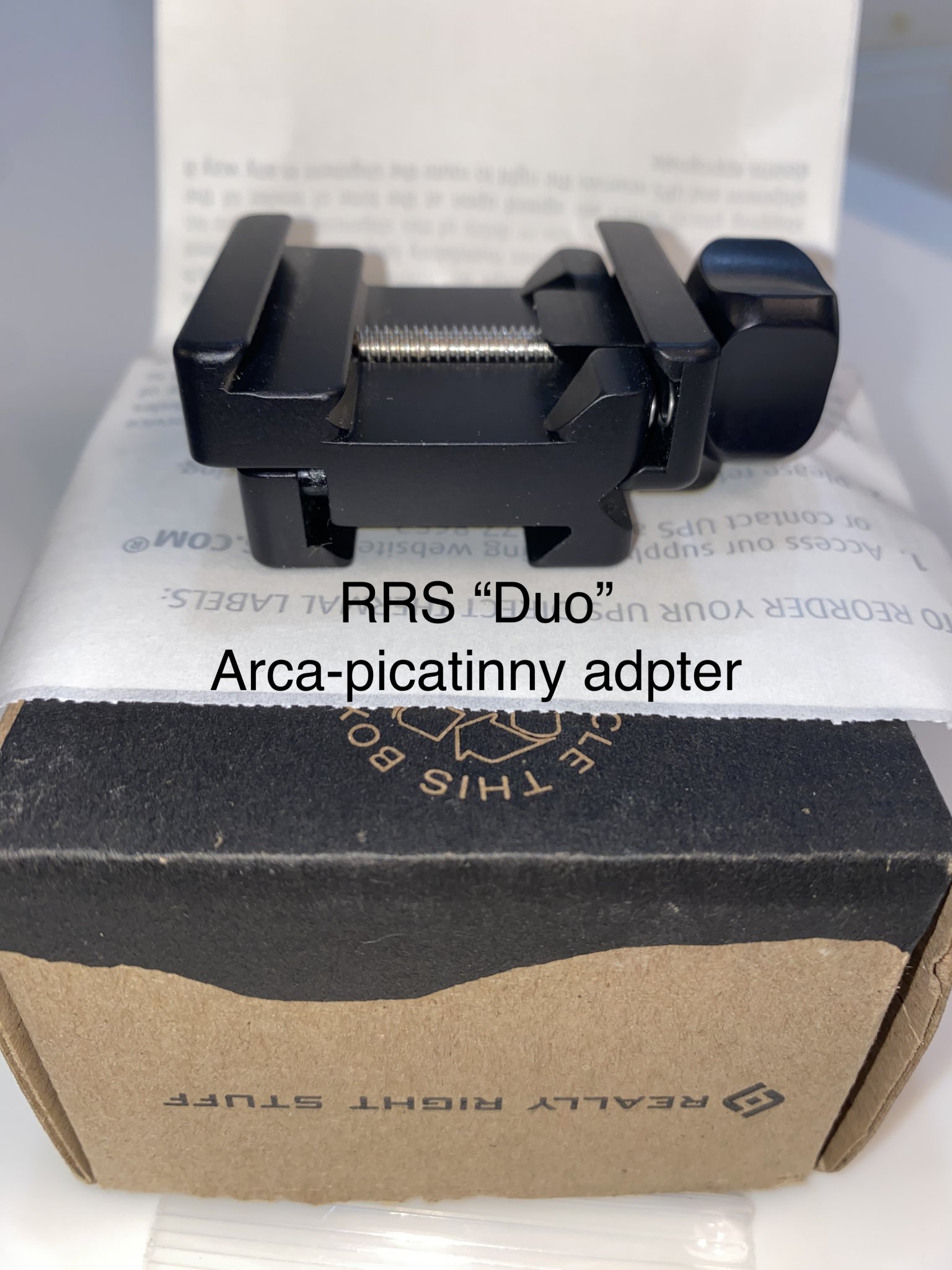

Won't the RRS Duo work you ? Or did I miss the OP's intention?
So, the Atlas bipods have what is called the A.R.M.S 17-S interface to mount your choice of bipod-to-gun clamps. A.R.M.S is a company that created what became the standard.
Anyway, the clamp you posted is a picatinny to picatinny/Arca clamp.
He needs a 17s to Arca or 17s to picatinny/Arca clamp like the RRS BTC-Pro or SC-ARC, or choose from other manufacturer’s similar clamps.
