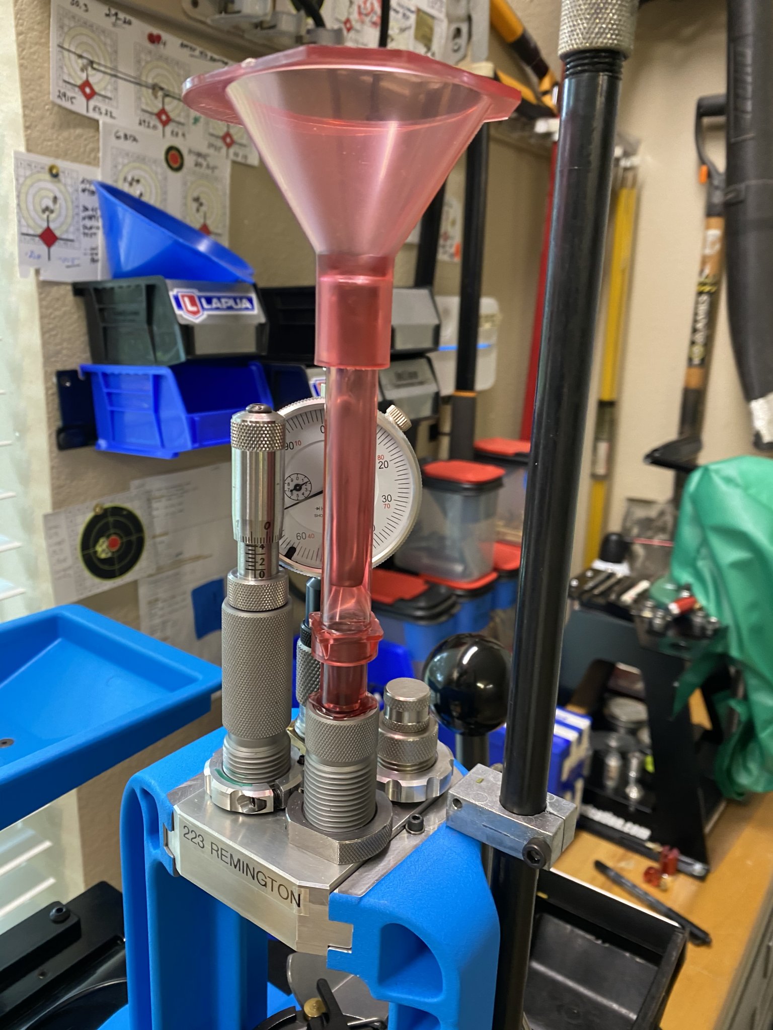

This seems to solve everything that isn't ideal about the Area 419 adapter, though I have to admit, I just ordered it and can't say for sure. But definitely more secure, and looks more forgiving.

Well, two big advantages off the bat are that it secures to the powder die, and that it is usable with the xl powder dies, for things like 300 WSM and SAUM.

Got this in the mail today. It is indeed far better than any other option out there. Necessary? Who knows. But very nice, especially if you switch between powder measure and funnel for different loads with the same cartridge, or, of course, if you use anything that requires the large powder die, with with the 419 funnel is incompatible.
I’ve tied most options and this does look well made. Problem is, it’s about 2” in diameter and will not fit next to most seating dies in the 550.
(Edit: probably better to say *some* dies. I measured with Whidden and Forster, known “fat” dies)

It fits next to a Redding for sure. I will try it with others tomorrow.

As a poors I put my Area419 drop tube from the funnel set in my lathe and turned off the male threads so it just fit in the dillon powder die. I drilled and tapped the top of the powder die for a set screw and wallah secured awesomeness.

The set screw locks the drop tube and prevents the Dillon powder funnel from lifting the drop tube and allows you to flare the case mouth on pistol ammo. Why yes I tested this on .....wait for it..... .40sw ammo, why? Why not..
I’ve found the Hornady powder die with a plastic funnel the most stable. Added bonus is it’s a transparent drop tube and skinny enough to use with fat seating dies.

If anybody has requests for dies to try next to, let me know. I don't have everything, but a lot.
