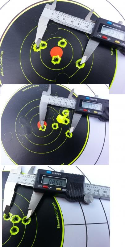

47.5gr of MR2000, 185 Juggernaughts 5 shot groups at 300 yards. Yes there are five shots in each pic! Fooled me too LOL I am hoping to get things even tighter, this was virgin Lapua brass.

What's the difference in the load/conditions for the three targets, if any? If you can consistently shoot groups like the one shown in the 3rd target pic, you'll be giving Steve a run for his money! Are you going to bring this load/setup to Pendleton 1000 yd matches next week, or stick with the 6.5x47?

Greg, top 2 were off the bench, bottom was prone. Light breeze typical SBRG conditions. Yes I am bringing this set up this weekend. Are you shooting both days? I can only shoot one of them.
