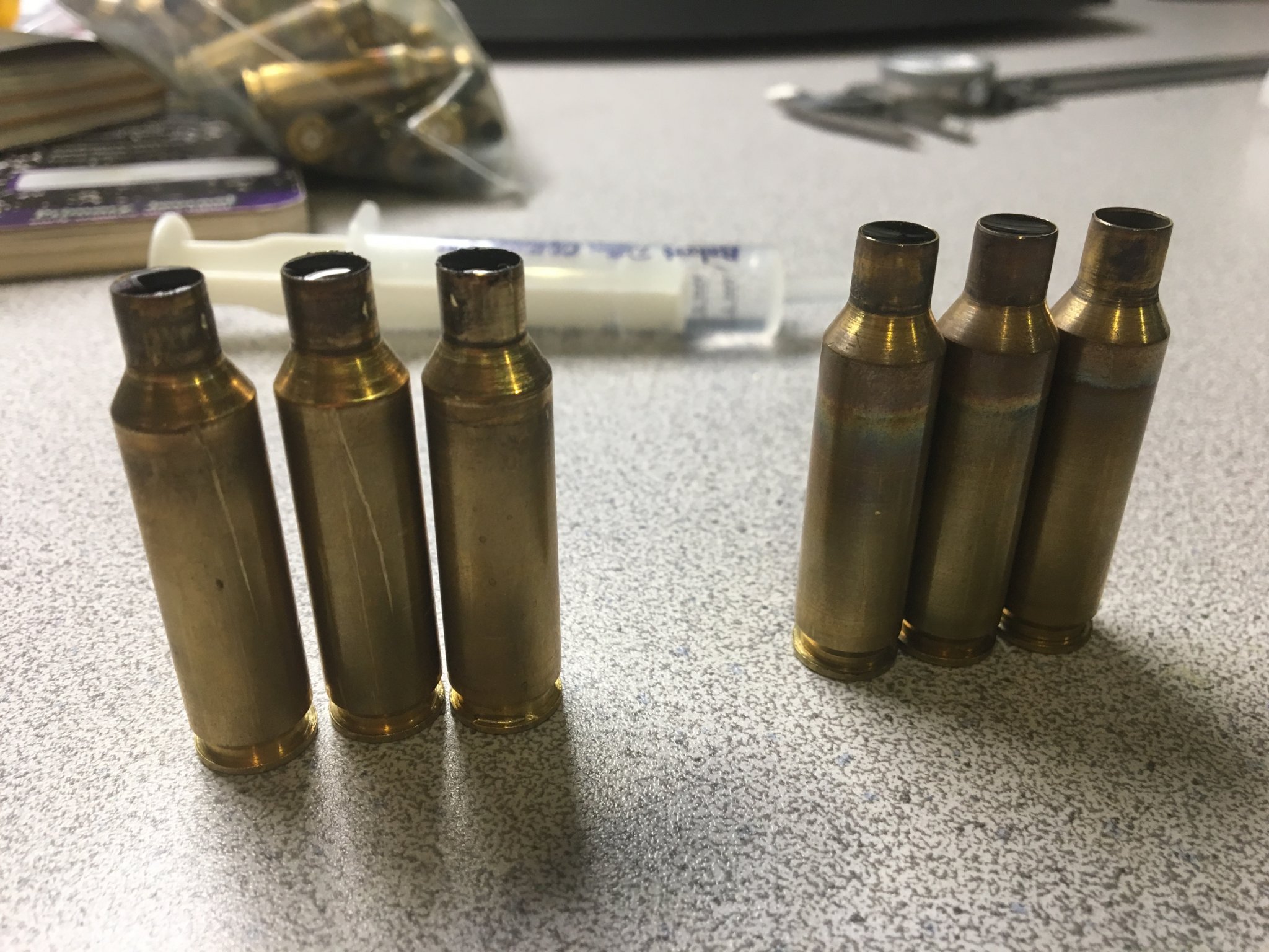

So I measured the case weight volume of the Starline and Hornady brass. The biggest difference was 2.0gr or ~2.5 drops of water difference. I have no idea how much this translates to pressure with the same powder charge but that doesn’t seem like much from an ignorant individual such as myself?
Not sure if this make a difference but
-I weighed 3 pieces of each
-each was trimmed to the same length and filled to the same level
-each case had been previously fired and not cleaned
-each case had a primer
Below are the actual weights.
Starline = 52.1, 52.3, 52.4
Hornady = 53.9, 53.9, 54.1
In 308 2 grains water capacity translates to a 1.5gr powder charge reduction
Holyshit I never would have figured. I am curious if that is close with the 6.5CM, H4350 and 140ELD?

3.6% difference in water capacity = 1.5 grains of powder. If primer pockets are getting loose, there is pressure. Have you miked the case heads to see how much expansion you are getting?
The Starline case has room for 1.5 gr less of powder but that doesn’t mean that you get the same pressure as if you actually used 1.5 gr more right? Are you saying that if I use 40.2 gr of RL16 in Starline brass with a 143 gr ELD-X it would be the same pressure as using 41.7 gr in Hornady brass?
Pretty much yeah.
