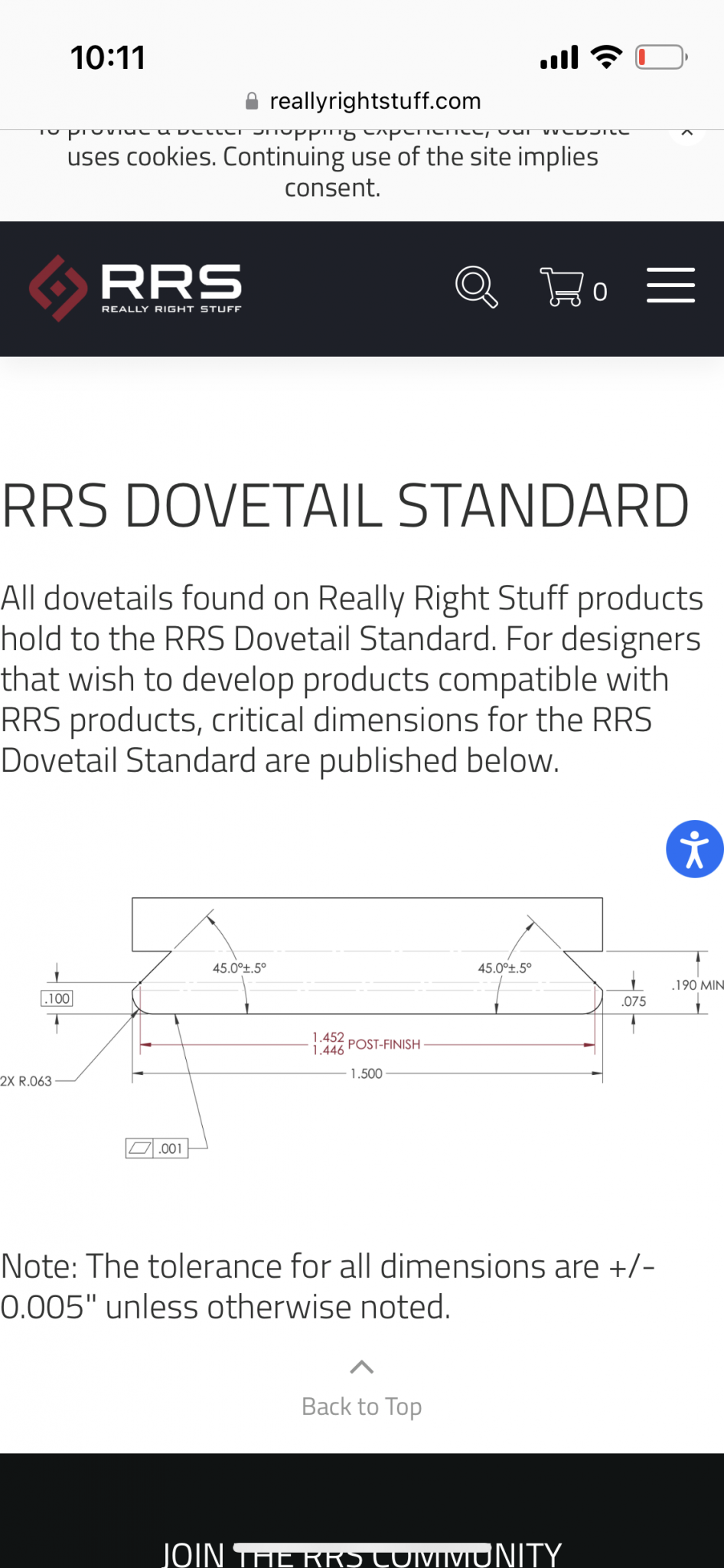

    This is what I’d refer to as the standard
    Not sure how many ways I can say it. THAT is RRS’s spec for a dovetail interface which they released relatively recently.
    It is NOT ARCA Swiss which is an actual company and what is called ATCA is their dove tail interface . These interfaces originally were for the photographic industry.
    The simple fact remains that ARCA Swiss does not publish a detailed spec (which by needs is more than just the 38mm width).
    So, RRS decided to generate and release a spec for THEIR 38mm dovetail interface.. But their competitors in the wider industry do not seem all be racing to embrace it and hence elevate a competitor.
    As a result, it’s possible to have slight incompatibilities between dovetail parts from different manufactures

    Scope mounts that attach to MIL-STD 1913 rails all have adjustable tension for that exact same reason. It's more important a clamp holds a rail that's .005" undersized vs pretending dozens of manufacturers will get it perfect every time. Mil figured that out. Every scope mount mfg figured that out. RRS figured that out.
    Well yeah, that’s RRS spec for their dovetail interface but it ain’t ARCA SWISS….who originated the interface but failed to spec it as far as I can see
    Agree. I was talking about the standard to which the OPs ballhead was made to.
