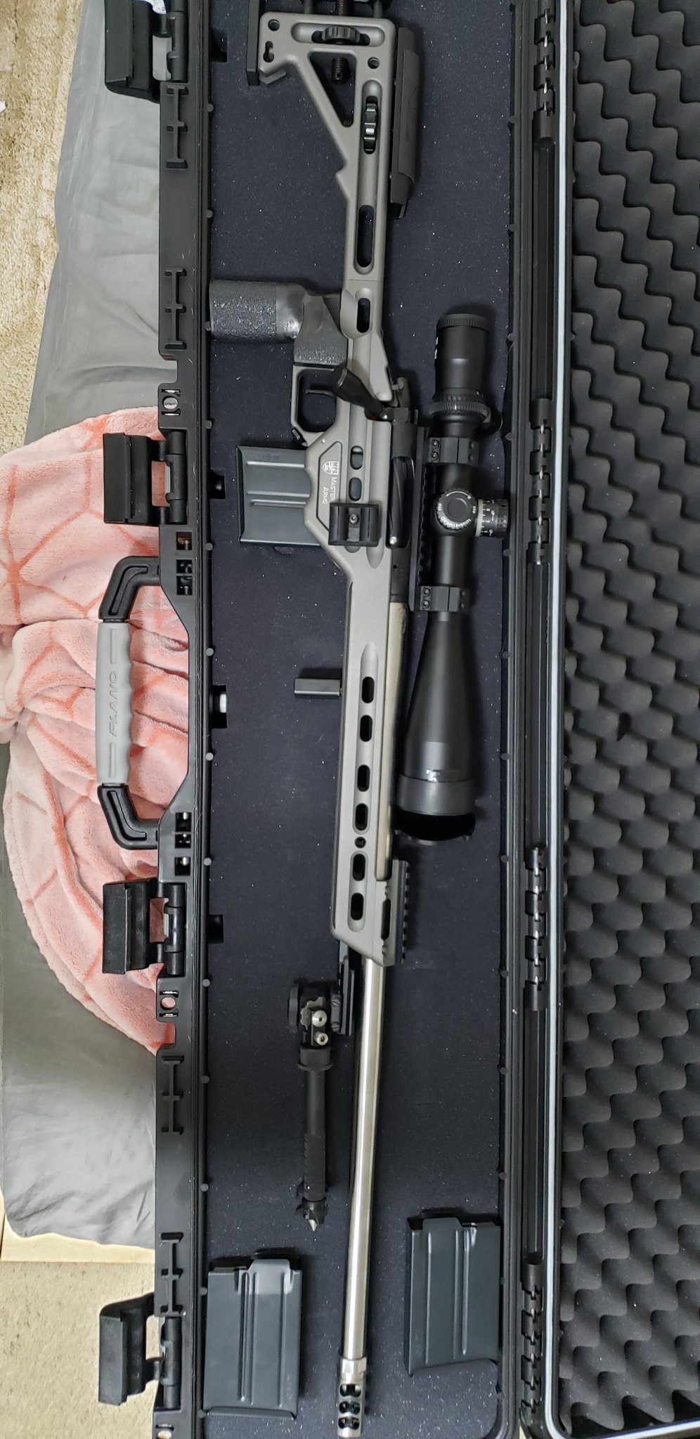

I'm actually running an origin with a PVA barrel and its hammer in a MPA chassis
