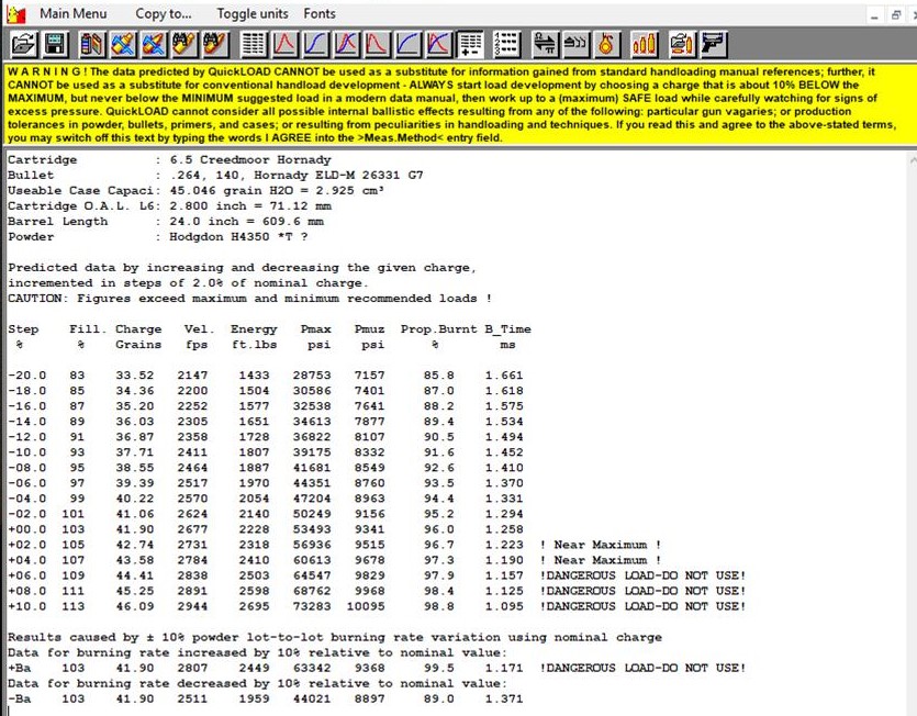

That powder seems a bit slow, but some of that might because you're loading with a long COAL??? Another issue might be the humidity you're loading in where if it's somewhat high humidity, the powder might have higher moisture content slowing down the burn rate . . . ??? Just a couple of thoughts that came to my mind.
Note that you've filled the cases pretty full if you're loading to a COAL of 2.800. See chart below that you might find of some help.
i like that chart. Where did you get it?

That chart is from the app called QuickLoad. It's a helpful tool for developing a load. Is something that helps reloaders get in the ballpark and can save time and components as one develops a load. There's a somewhat steep learning curve to get to using it correctly.
It's not free. :( You can look it up with a search.
