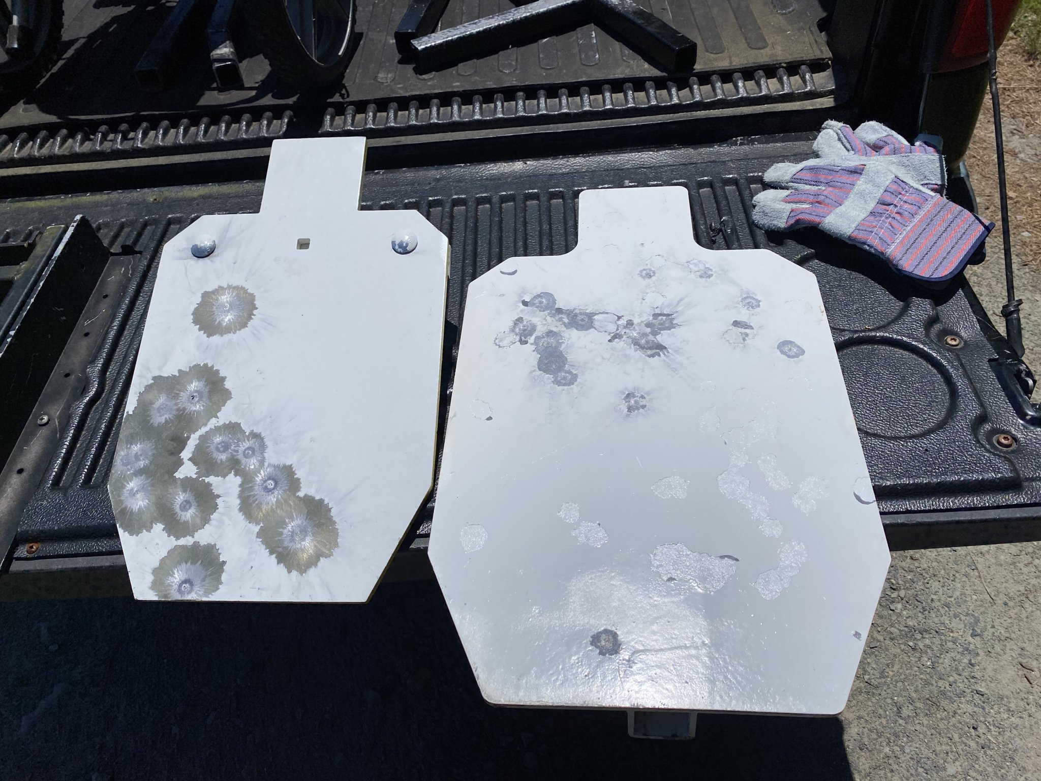

My LRI built 224 Valkyrie with a 6.5 twist 26” barrel and a 419 brake recoils like a popgun w/ 88.5 Hybrids.
Hits on steel are tougher to see at 1K but they’ll trip the flasher on the target, no problem.
These are hits on steel @700 (left 20X10 IPSA) and @1000 (right 25X15 IPSA) while I was truing my Kestrel for the 88.5 load.
