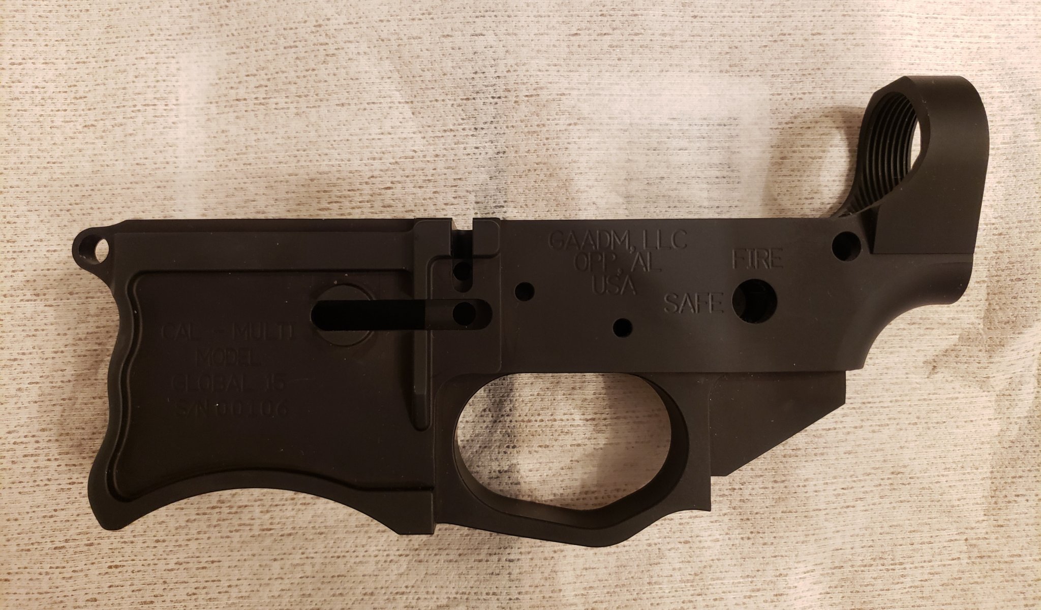

Today I was bored and decided to build out one of the lowers and an upper kit I ordered a couple weeks ago. Like a moron I forgot to test fit the upper and lower before I started building them. Fast forward a couple of hours later and I have a completed upper and lower. I go to put them together for a function test and SHIT!!!!! The lug areas for both the front and rear takedown pins are too narrow for the lugs to go in much less seat.
SORRY I FORGOT TO TAKE THE BEFORE PHOTOS
I tested all 10 that I ordered and all of them are too narrow. I contacted @THEIS and he was very helpful. It appears some of them fit just fine and some are too narrow just like the lot I ended up with.
I found that the left side of the pivot pin reciever had not been milled down to spec but the right side was correct. That was an easy fix and only required milling a bit off that side. I then milled a few thousandths off both sides of the receiver and that solved the fit problems. Fortunately, I have access to a milling machine at work and was able to fix those issues.
Move to the newly discovered issue. The magazine well is too tight to fit a GenM3 PMAG but will fit a standard metal magazine. However, the metal magazines are not activating the bolt holdopen. I haven't had time to mess with it more but will see if I can find a solution short of milling out the mag wells which I have no interest in doing.
Any ideas are much appreciated.

No problem. The milling wasn't too bad but this mag well issue is another monster on it's own.
UPDATE:
After some more jacking with the lowers. I went ahead and built out a couple more of them for testing purposes. I have found that the bolt catch will work with the metal mags. The one that is not functioning feels like there is a bit of drag or a stiffer spring in the bolt catch mechanism. I will disassemble that part and reassess it.

The only thing to figure out now is if it is possible to make the lowers PMAG compatible. I am not big on milling the magwells but may try it on one of them. Otherwise, I will just run the metal mags instead.
FWIW I have the same issue. Again no complaints about them or @THEIS. I just haven’t gotten around to doing any mill work yet. I bought these to make backup guns to pass out to neighbors when the shit hits the fun or just beat the shit out of.
Honestly, I am fortunate to have access to a milling machine and the milling was easy but the maxwell issue kinda sucks.
Just be aware that only the inside of the left side front post that holdsthe pivot pin need to be milled. But, both sides need to be milled in the rear takedown pin area. The rear area could easily be done using an 80% lower jig and the front post could be done with a flat file as a last resort.
I am thinking that I may can solve the magazine issue using a file easier than trying to get all the way through with the milling machine.
