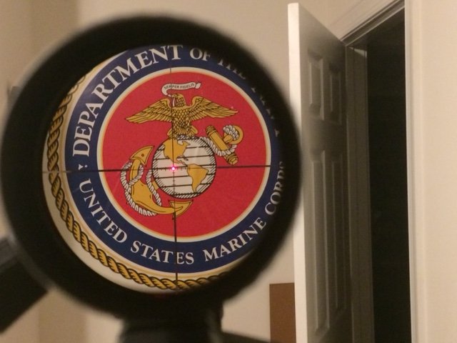

"Operators" don't have time to adjust parallax for those close "threats" coming at you! LOL
Seriously though here is a pic of the PST Gen II on 1x at about 10 feet across my room. I don't take good through the scope pics but gives an idea that the adjustment really isn't needed close in even at 10 feet.
