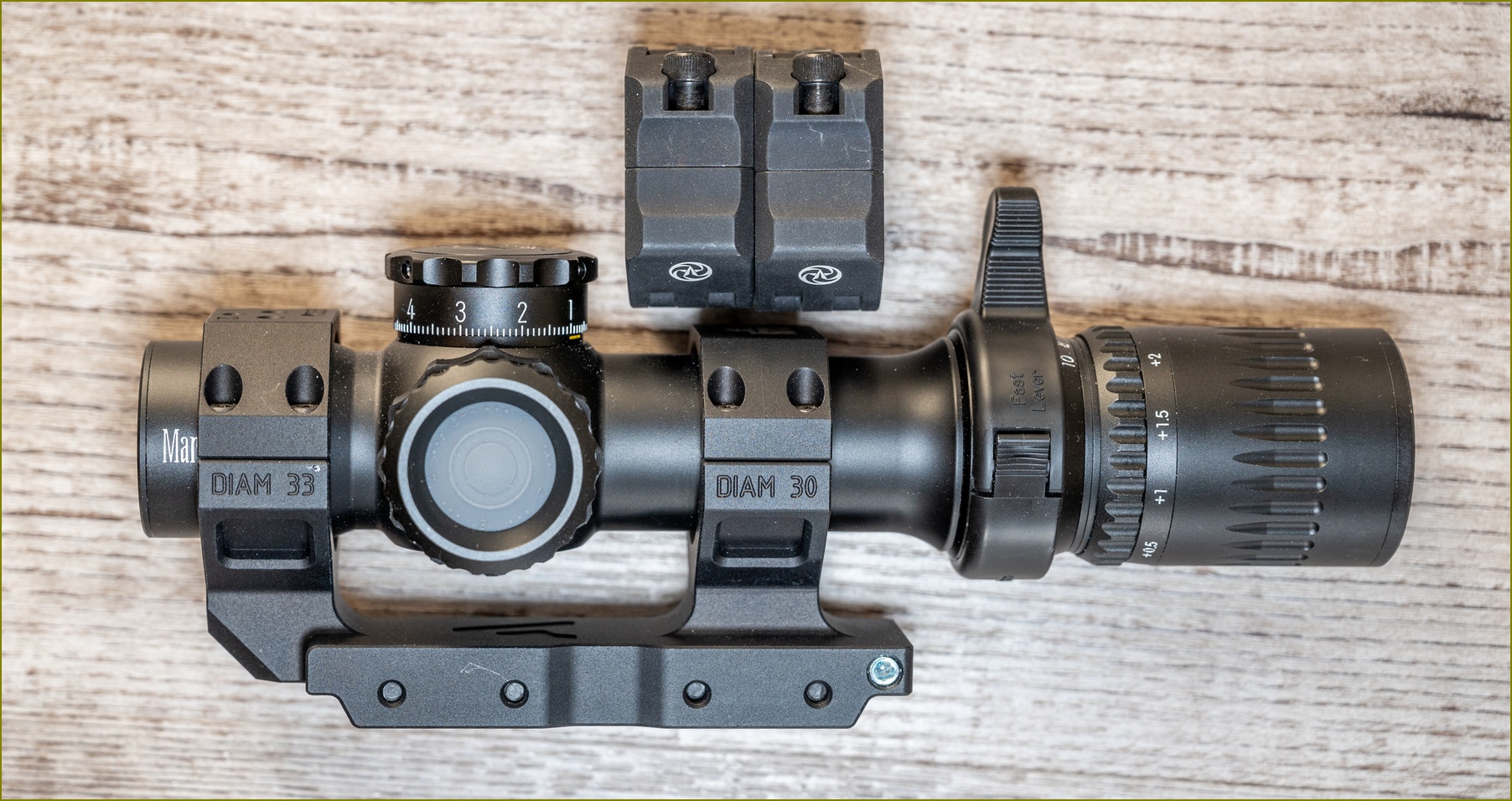

I just watched that video that W54/XM-388 posted and discovered that. Two things on that scope assuming glass is good 1) missing tree reticle 2) Why didn't they just make the tube 34mm? I mean how foolish was that to require some janky mount or two different sized rings.

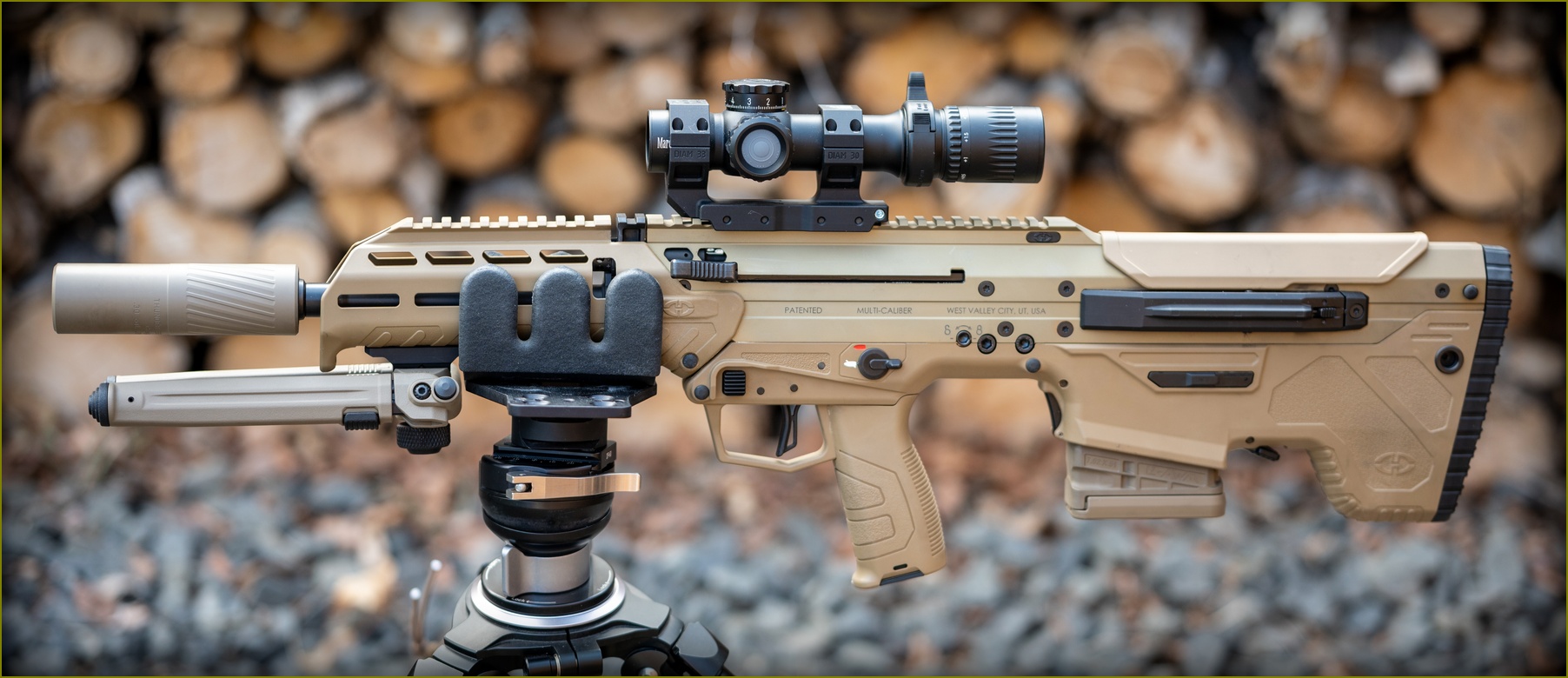

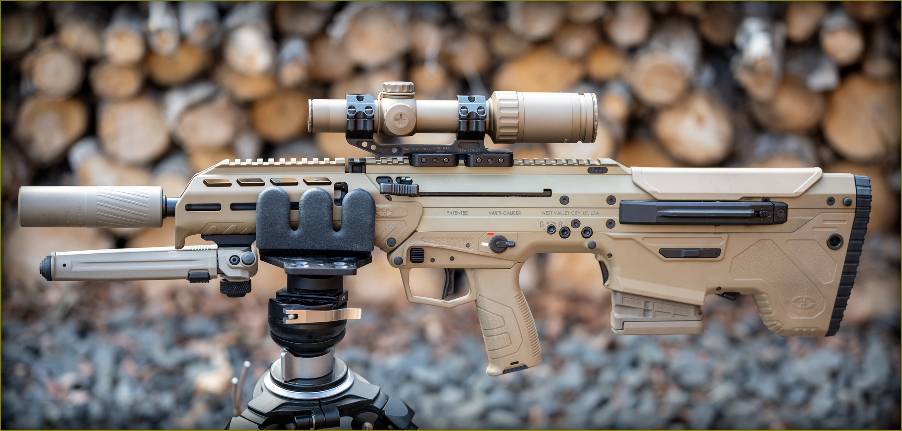

I have a "why" question for pretty much every manufacturer :) But I get what you're saying, if the objective bell and main tube were both 34mm a lot more mounts could potentially work. Typically you do not want to mount a ring on the bell; however, March made the structure of their bell strong enough to withstand the mounting torque and stress of firing, it is a decent setup and a compromise that may be worth it to many to have such a short scope. March is coming out with a tree reticle later this year or early next, but it will not be dual focal plane so we'll have to wait and see how bright it is. The Shorty is definitely geared more toward precision and long range with the parallax and exposed turrets. For fast acquisition and a nice blend between BDC and mil I am really liking the CX9001 reticle for the ATI SAI 6. For the best blend between both worlds, the Vortex Gen III 1-10x24 with mrad tree reticle is the ticket. If I could get the LPVO that I would like it would be the Vortex Gen III 1-10x24 illumination and sight picture, the March's parallax and turrets with the SAI 6's reticle ;)
With a bullpup design like my MDRx, there are not many options for a daytime scope and enough space in front for a clip on for NV; however, compared to the SAI 6 (bottom image) the shorty gives a lot more flexibility with what can go in front.
