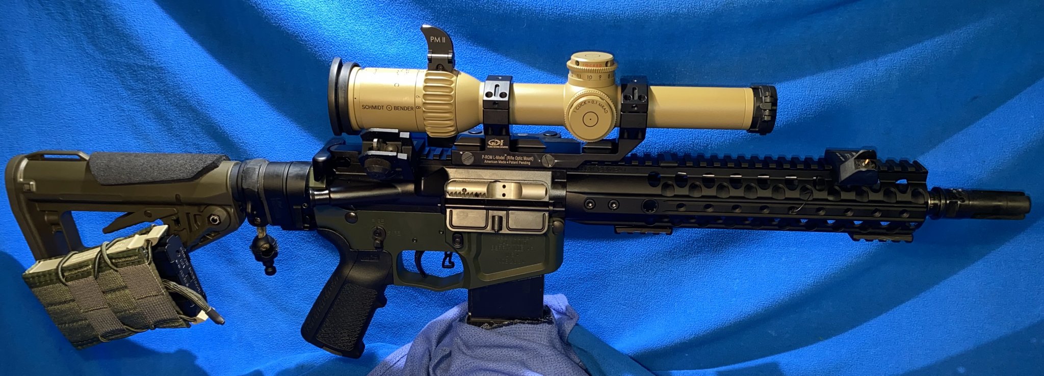

    I run offset red dots with a couple of my LPVOs as combination backup sights / quick transition 1x. I would argue that the primary issue with using a 2-12x or 3-18x with an offset red dot as the primary 1x solution is really practicality, at least if your use case involves being at 1x 75% or more of the time.
    Using the offset as your primary is, in my view, not a great experience. Your LPVO is blocking half your FOV. You're canting your rifle, which isn't comfortable for long periods of time (or for bringing up from a low ready), especially with 24-30oz of optic unbalancing it. Your compensator will probably not work right due to canting.
    Now if you're running at 12x-18x 75% of the time, sure, this makes more sense. But if that's the case, were you even really in the market for an LPVO to begin with?

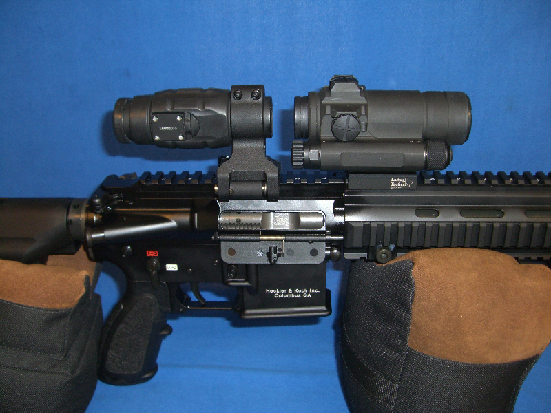

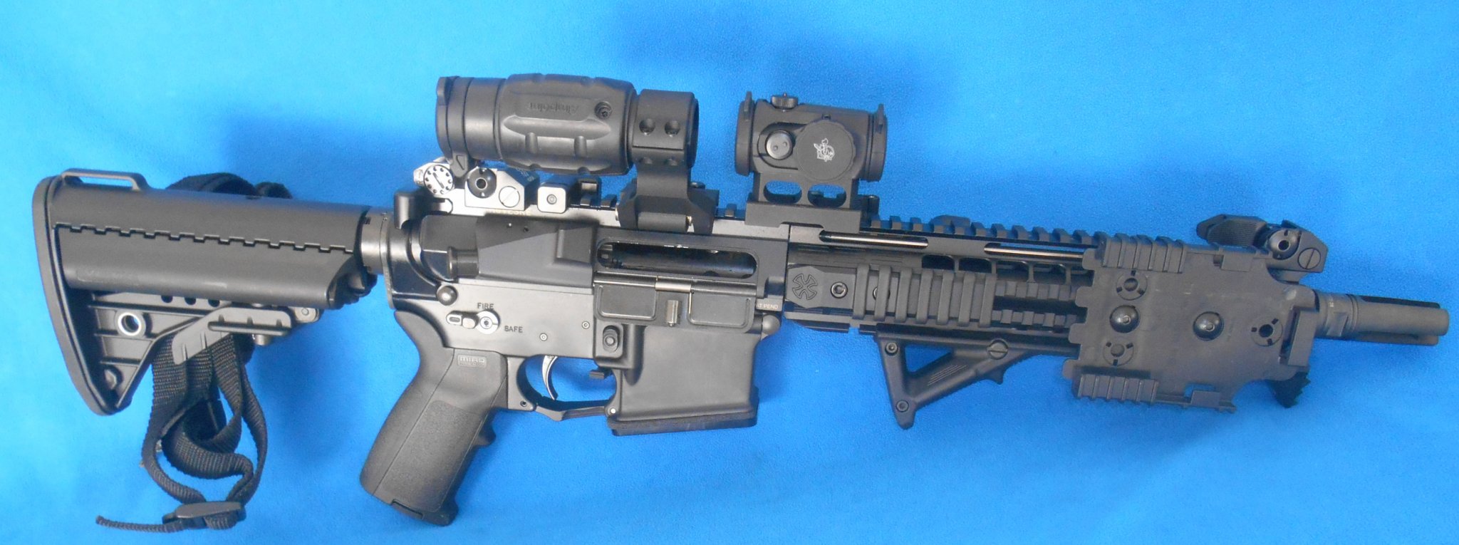

    Setup most of them with micro BUIS either offset (Barry Dueck's) or in-line, although the utility of BUIS is seemingly becoming obsolete concept with reliability of powered optics.
    QD mounts like GDI and LaRue are excellent choices for optic mounting in these situations.
    So there are LVPO optics with red dots integrated within, just have to get off the wallet to have the combination. The offset combination is generally due to prohibitive economics of purchasing the integrated optic system.

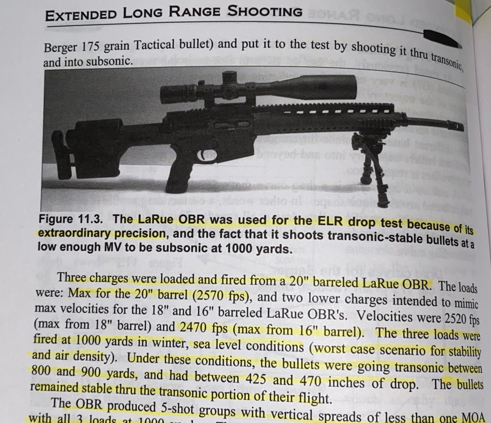

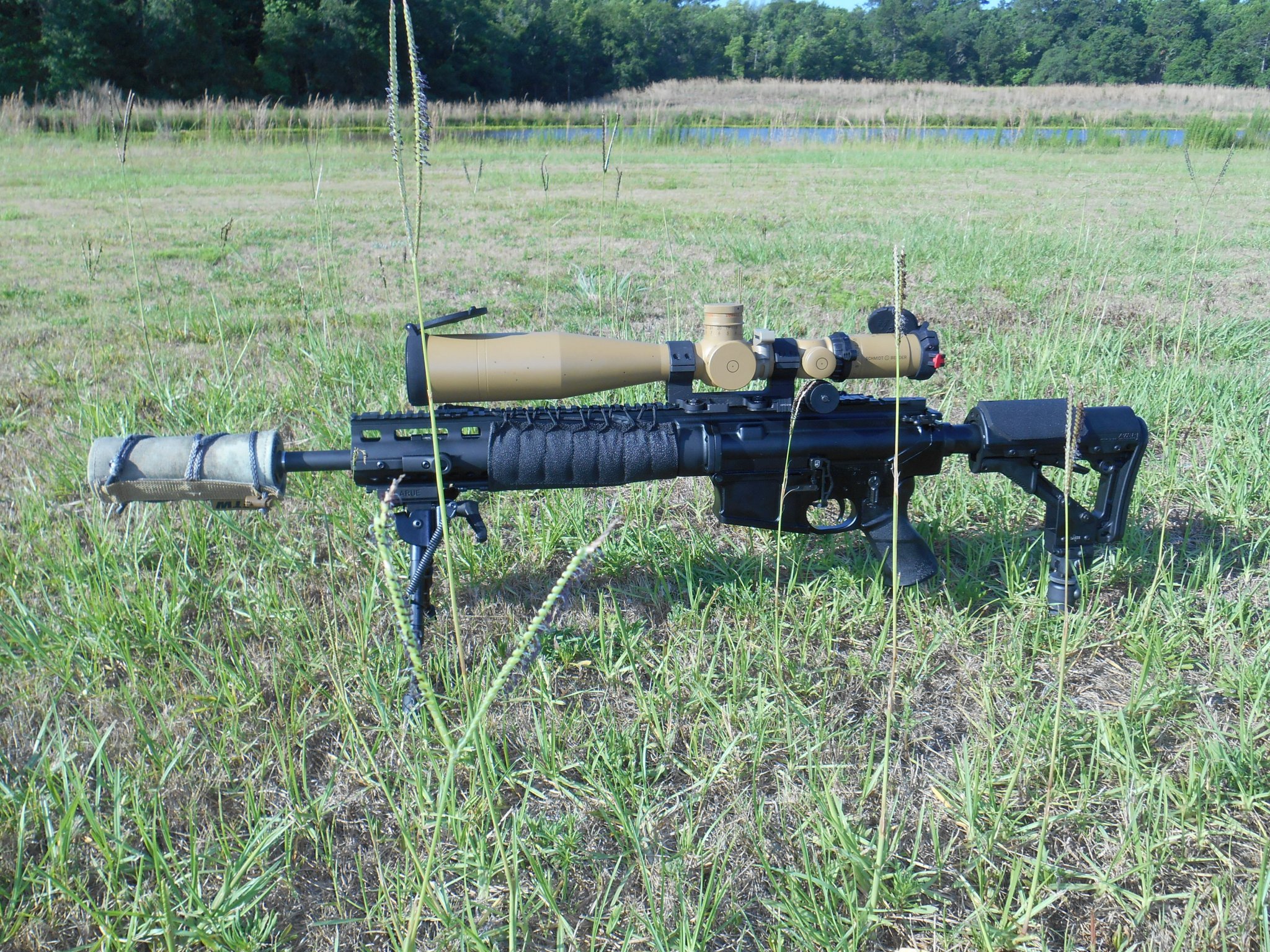

    When Army service members Giannelli & Homeyer won the 2010 International Sniper Competition using LaRue 16"-18" 7.62 OBR's with Night Force scopes (Horus 37 /58 reticles) and LaRue LT111 quick-disconnect mounts, it got the attention of the shooting community on a number of levels. They were getting 90% first round hits @ 800 -900 meters on 12" plates.
    I assembled a similar rifle system with a S&B 5-25x56 Horus H59 reticle that was able to easily replicate their results.
    Bryan Litz used the LaRue OBR rifle & mounts for his long range shooting data acquisition.
