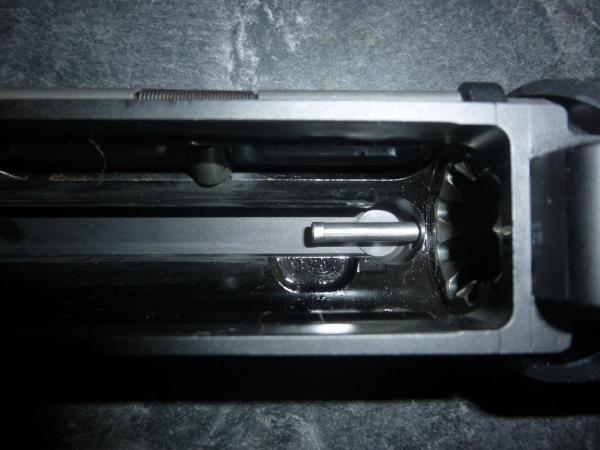

On the gas tube, make sure it comes out halfway of the cam pin cutout in the upper when installed-see attached pic.

Save yourself some grief. Make sure the buffer and buffer spring are correct (DPMS Rifle). Use only an adjustable gas block. Preferably a clamp on adjustable gas block. Pay attention to MTRMN's picture above. There is no standard for .308/6.5cm gas port locations for barrel manufactures. They use both AR gas length gas ports and Armalite gas port lengths. These two use different length gas tubes. Using the wrong gas tube will result in malfunctions that will drive you nuts. Criterion barrels are my first choice. Make sure and use a Aero Precision Extended Magazine Release/Catch Button and Aero Precision M5 .308 Bolt Catch. A typical AR 15 lower parts kit will come with a magazine catch that is short about 4 threads for use on a AR10. AR10's are fat unlike AR15's. That's why you need the AP extended mag button. It has the extra 4 threads you need to adjust it to work. Standard AR 15 bolt catches usually won't tip up far enough to catch the AR 10 BCG when the magazine is empty resulting in the BCG going forward on a empty chamber. The AP M5 Bolt Catch will tip up far enough to lock the BCG back on a empty magazine. VG6 muzzle brake's work great.
