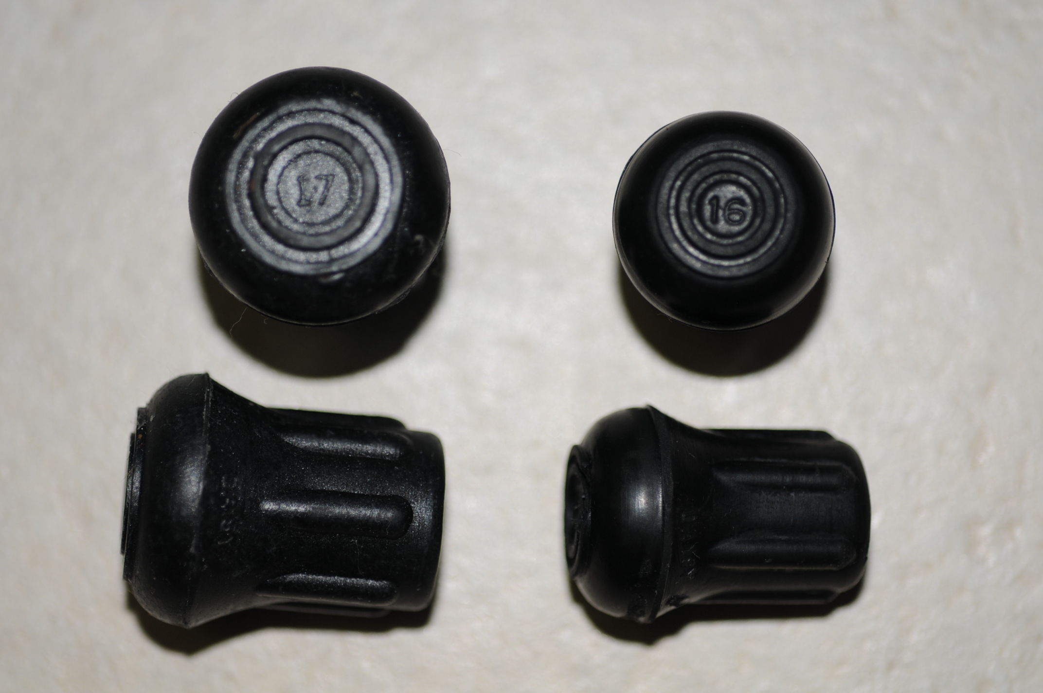

Tried in vain to get ahold of the LRA folks to order replacement rubber feet (website still down, not replying to email). Searched and searched the interwebs until I found the replacement rubber feet on (surprise) Amazon. If you need 'em:
Hecht Rubber Corp. Size 16 (Amazon.com - Herco Heavy Duty Black Rubber Tip (Size 16) - 8 pcs -) fit the Scout
Hecht Rubber Corp. Size 17 (Amazon.com - Herco Heavy Duty Black Rubber Tip (Size 17) - 8 pcs -) fits the F-Class and Light Tactical Bipods
Save the hard plastic insert from your old feet and spray a bit of silicone inside of the replacement feet before sliding them on to keep them from splitting.

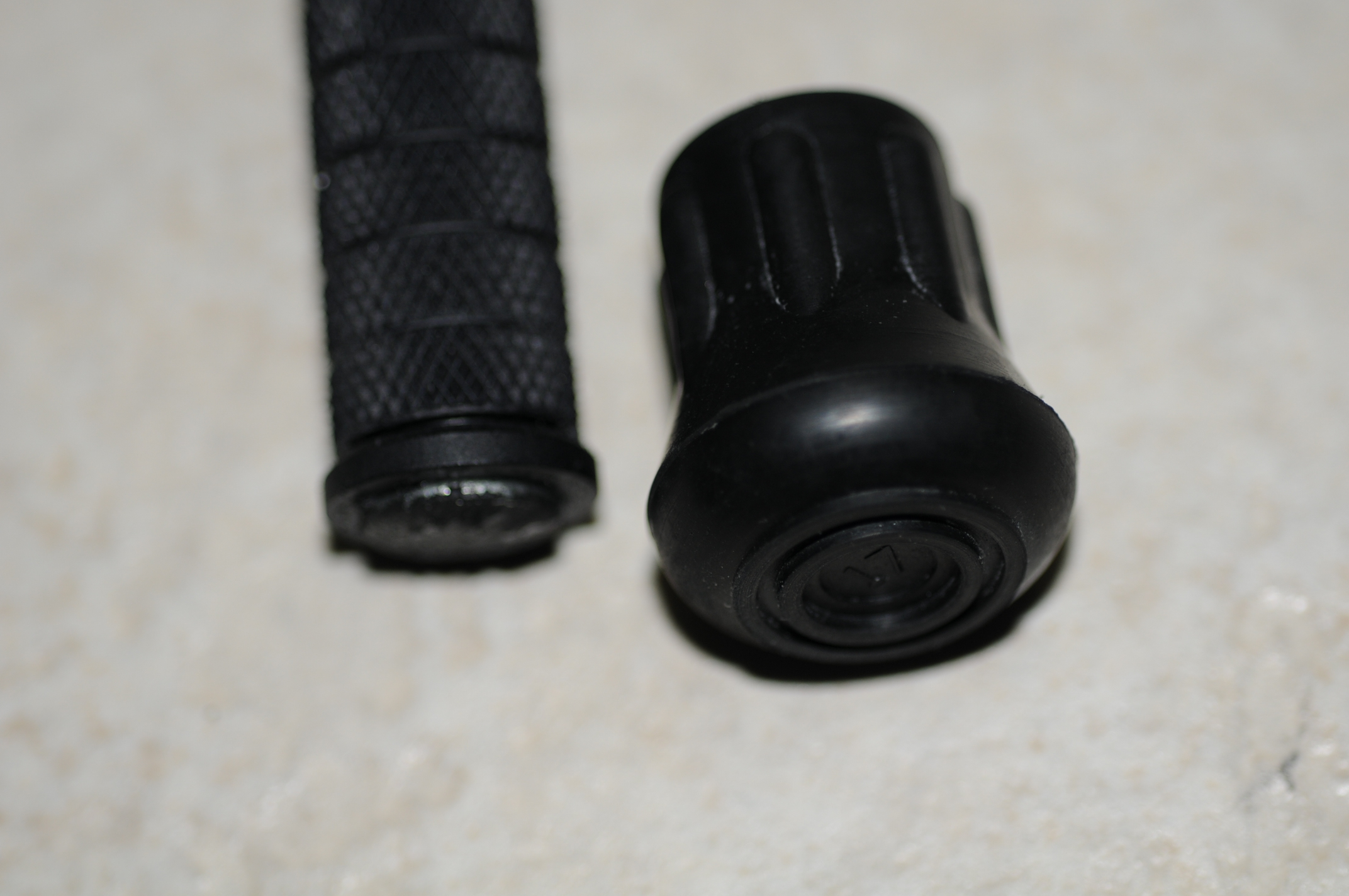

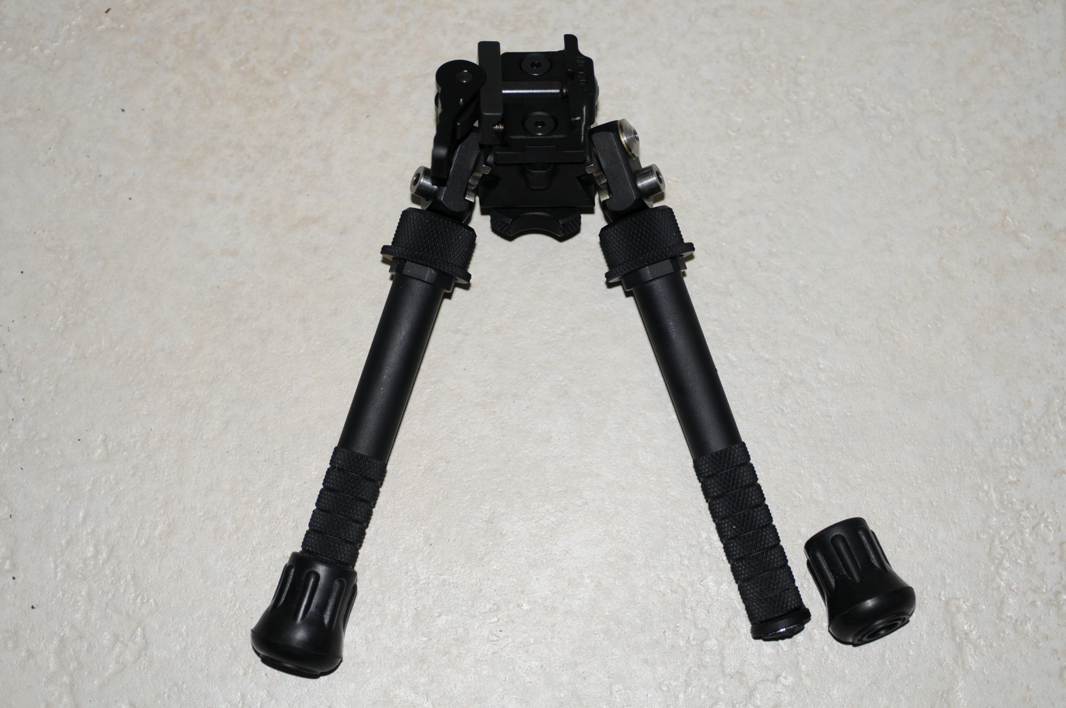

Found that the 17's will also fit an Atlas (blasphemous I know but the Atlas rubber feet were always a bit too squishy for me). You'll have to remove the rubber tips from the stock feet (grab the edge with pliers and rip 'em off) to reuse the aluminum feet base thingies. The extra width of those base thingies and the knurling on the legs make for a secure fit of the new feet.
