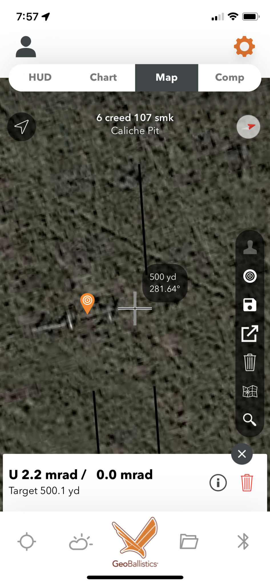

Ive found that in my relatively flat lands that the Geoballistics app works as well as my rangefinder. Satellite imagery so if you cant see the target on the web you have to know where the target is in general in order to drop a pin on it- right in front of this tree, behind this big exposed rock- and so on.
Now that my target stands are big enough and stay in one place long enough for a satelite to have captured them it matches what my rangefinder spits out down to the yard.

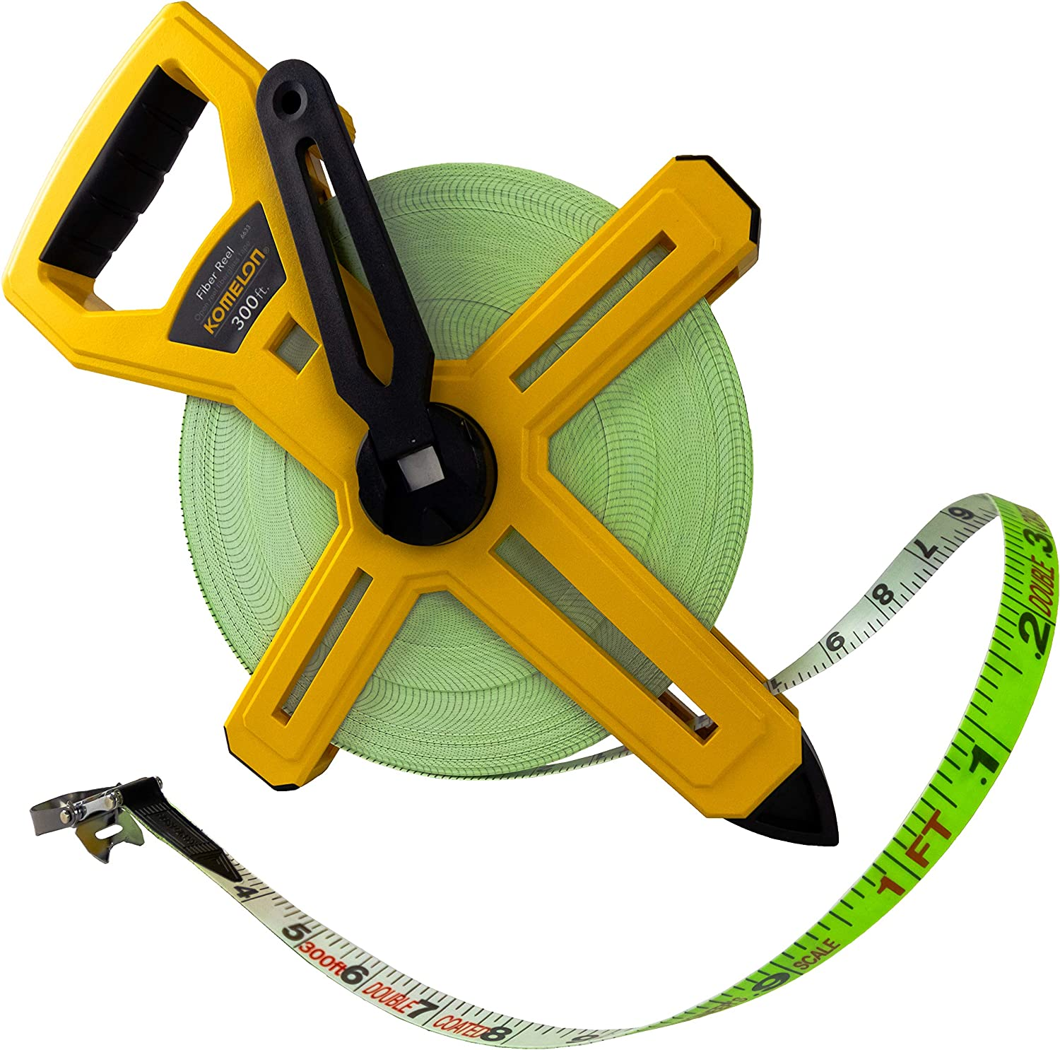

330 foot open reel tape measure, less than $20 at Harbor Freight. If eventually going to do scope click validation you'll need a tape anyway.
Reactions: pineoak
Just a reminder to anyone reading this in the future, need to get the 300ft/330ft version. 100ft version won't reach 100 yards.
Not trying to insult anyone's intelligence, just the kind of dumbass mistake I'd make personally.
