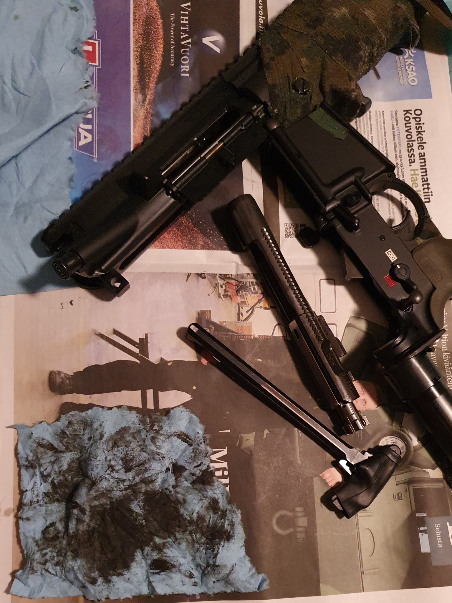

    I have used Castrol motor oil for my MR223 and it is perfect for it. But I read about how motor oils actually worked after seeing a video about coagulation/flocculants of water which diverted me to wikipedia, to read about motor oil additives.
    As ARs do not regurly have oil filters on them the flocculants that work in the motor oil collecting dirt to be picked up by the oil filter, just ends up running back and forth in the action with the bcg as sludge.
    In practice, when shooting MR223 breaked I do not think there are any parts getting dirty except the bolt head, that gets a light carbon layer to be wiped off. Very clean.
    But with the suppressor (Ase Utra SL5, legacy model, not a blow through) the gun gets rather dirty and when motor oiled the same way when breaked, the motor oil collects quite huge amounts of dirt.
    So last time I oiled the gun using CRC Power lube, a heavy duty / premium PTFE lube.
    I was originally going to add the PTFE to the motor oil but I decided to just try the thing solely.
    And the results look very good, after the last shooting session I could not tell difference in friction or feel when pulling the charging handle and I got the gun cleaned with a small piece of maintenance paper. Motor oiled gun took a lot more wipes, however I also added it slightly more. However, overall dirtiness is less and there was no sludgy stuff, but testing shall be continue, next I will try with the motor oil but keep the amount down.
    I shoot in the cold at the moment (though now it has been quite warm, 30F) so I would like to find a lube that works well in the cold, is plentiful, not harmful and does not have a ridiculous price tag.
    I'd like to know how everybody else is doing suppressed?
    Do you lube like you normally do? Or has running suppressed changed your lubing routine?
