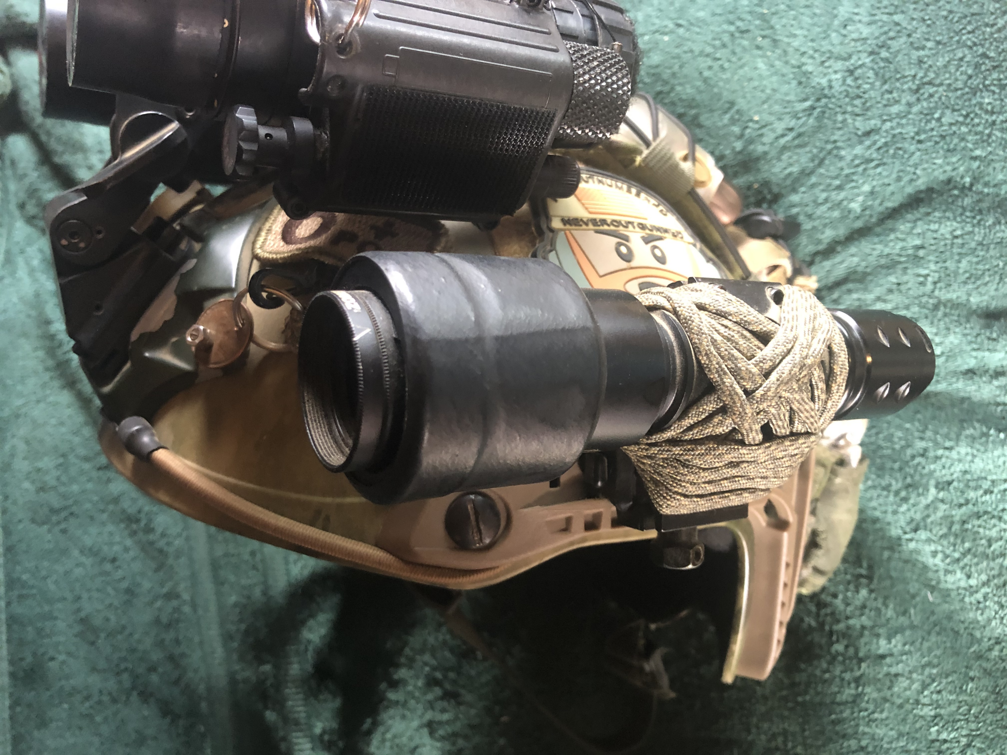

I also take low cost Evolva T20 and take a PVS14 slip on magnifier adapter which will slip right into the front of the Evlova then take a piece of bicycle intertube and put over the outside to add further retention. Now you can screw a Zomei 30mm Optical Glass Infrared Infra-Red Filter 950nm IR in to the treads of the slip on magnifier adapter.
This setup of the Evolva will give you a very strong unit that produces ZERO RED GLOW. On dark nights with the 950 pass filter in it will get you a good beam out to about 200 yards that a Gen 3 device can see very well. You can light up any animal you want and it will not spook them even as close as 15 yards. The Evolva has 3 power settings you control via pushing the tailcap button. Low, Medium & High. This light also serves to give an excellent navigation light in very dark environments that emits no visible signature.

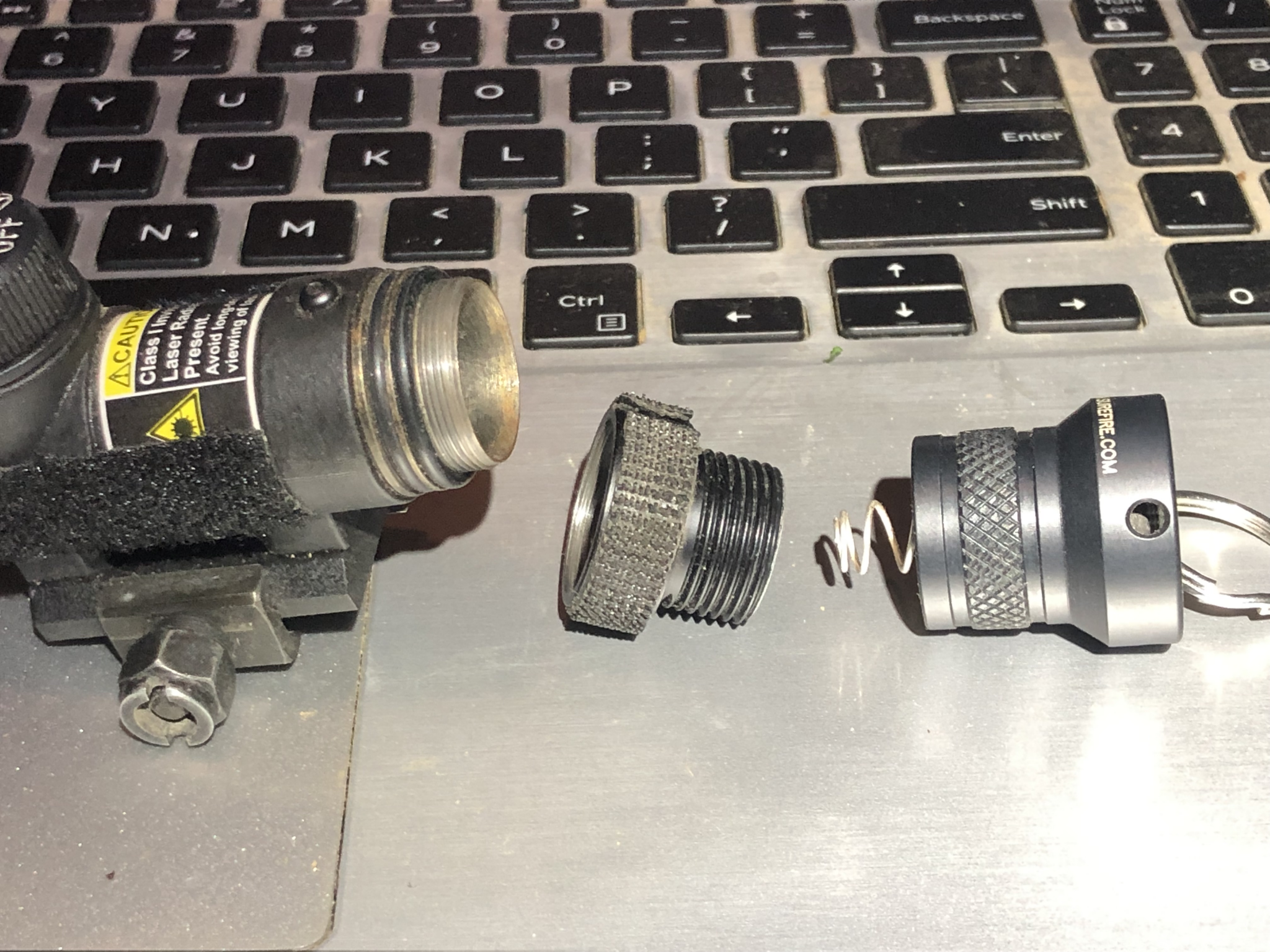

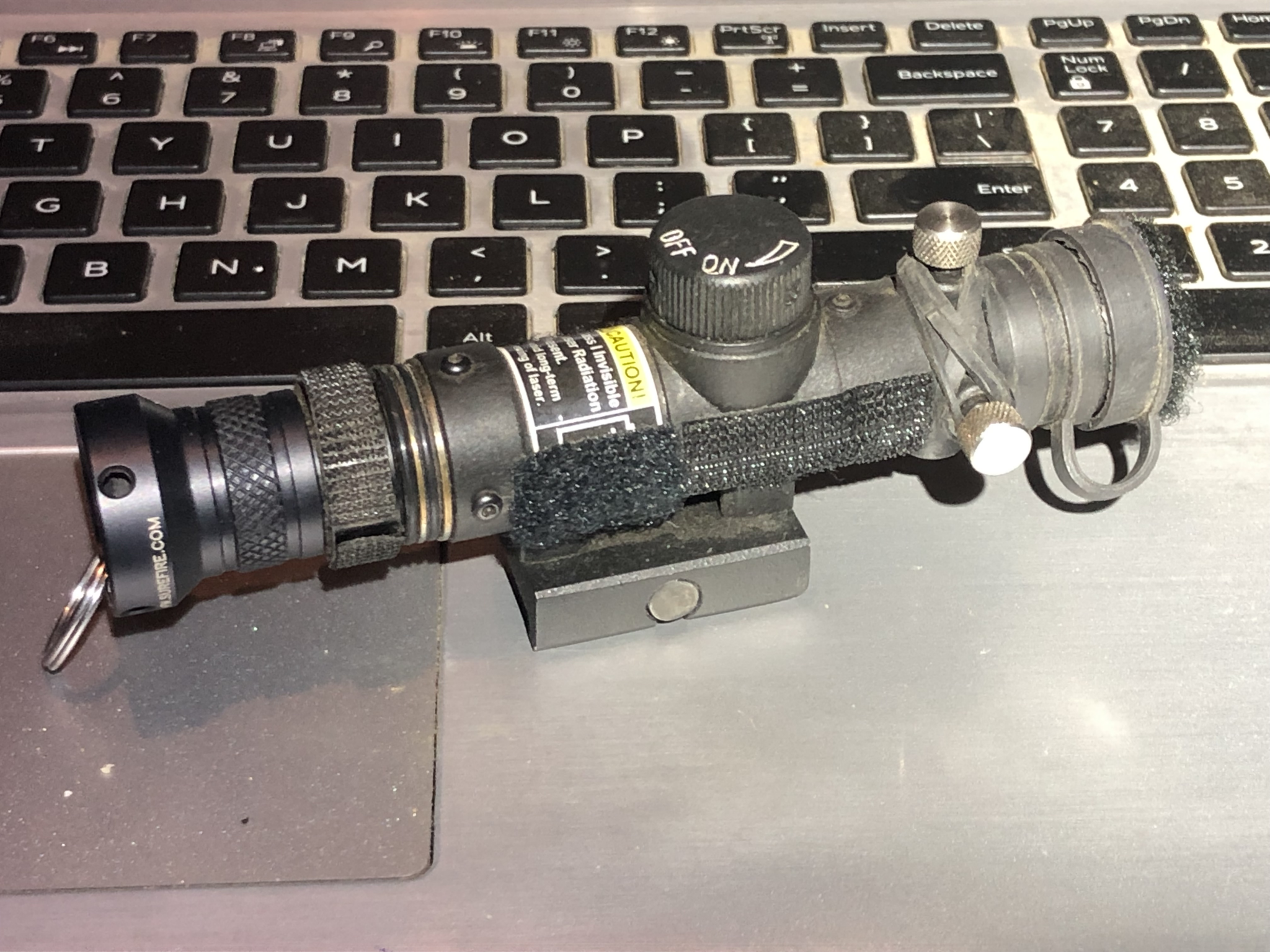

@Bravo6niner Here is you a picture of the Luna with the Thumbscrews in it that will make adjusting it to center with you PVS 27 very fast. I also cut a couple of small ranger bands from bicycle intertube and twist around them to add extra retaining tension.
Here is a link to the Thumbscrews.
303 Stainless Steel Thumb Screw, Plain Finish, Knurled Head, 8mm Length, Fully Threaded, M3-0.5 Metric Coarse Threads, Made in US (Pack of 5)
I also put 2 tiny O rings on each shaft of the Thumbscrews to add watertight protection and tension to the screws.
O Rings
https://www.amazon.com/gp/product/B01GRGL2IE/ref=ppx_yo_dt_b_asin_title_o01_s00?ie=UTF8&psc=1

For others that have questions about setting up the Luna's here is some additional information.
You will need to get the Luna/Surefire Adapter to run Surefire Tailcaps. Get up with Jay (Surgeonshooter) here on the Hide and he can get them for you. He owns Sureshot NV
I do stretch out the Surefire Tailcap spring a bit to make heavy contact with the battery.

Here is my luna, gonna try and find the receipt before I go to work, talking with my bud I might be off a year, might be closer to 2013ish when I bought it.

@Vicarious Yes sir, you have one of the older thermoplastic models which probably had the laser diode that throws out probably !0% of the visible glow that the later versions are putting out. But still the later versions and current versions are great Illuminator's and don't put out anywhere near the glow of the typical LED Diode based Illuminators.

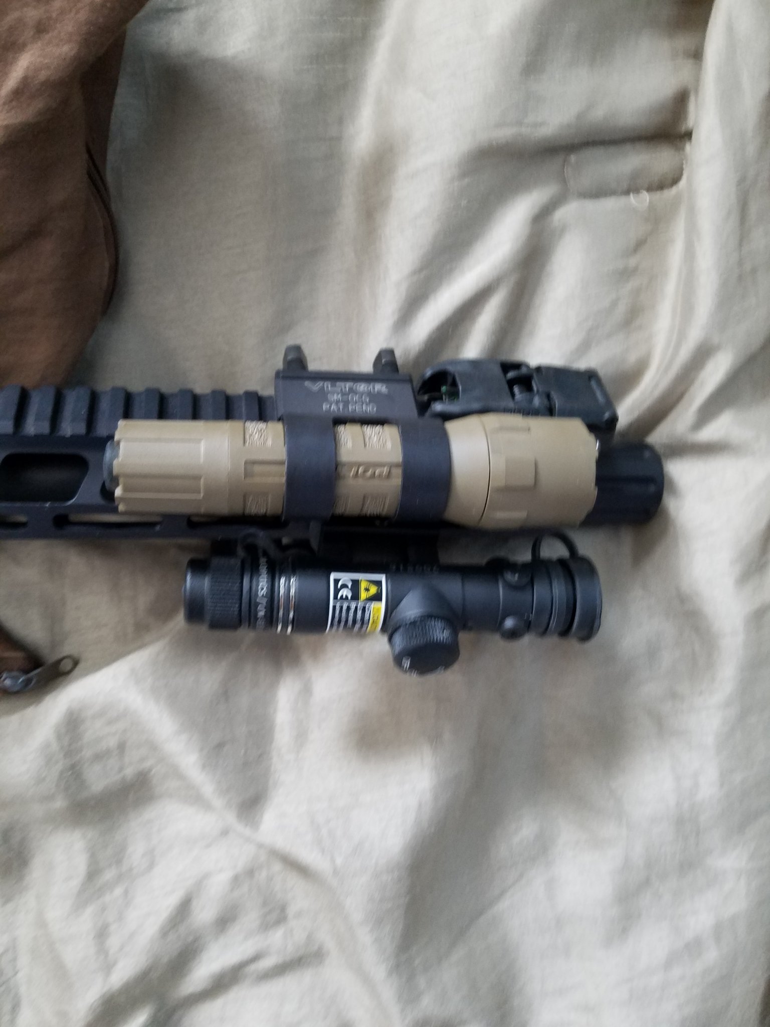

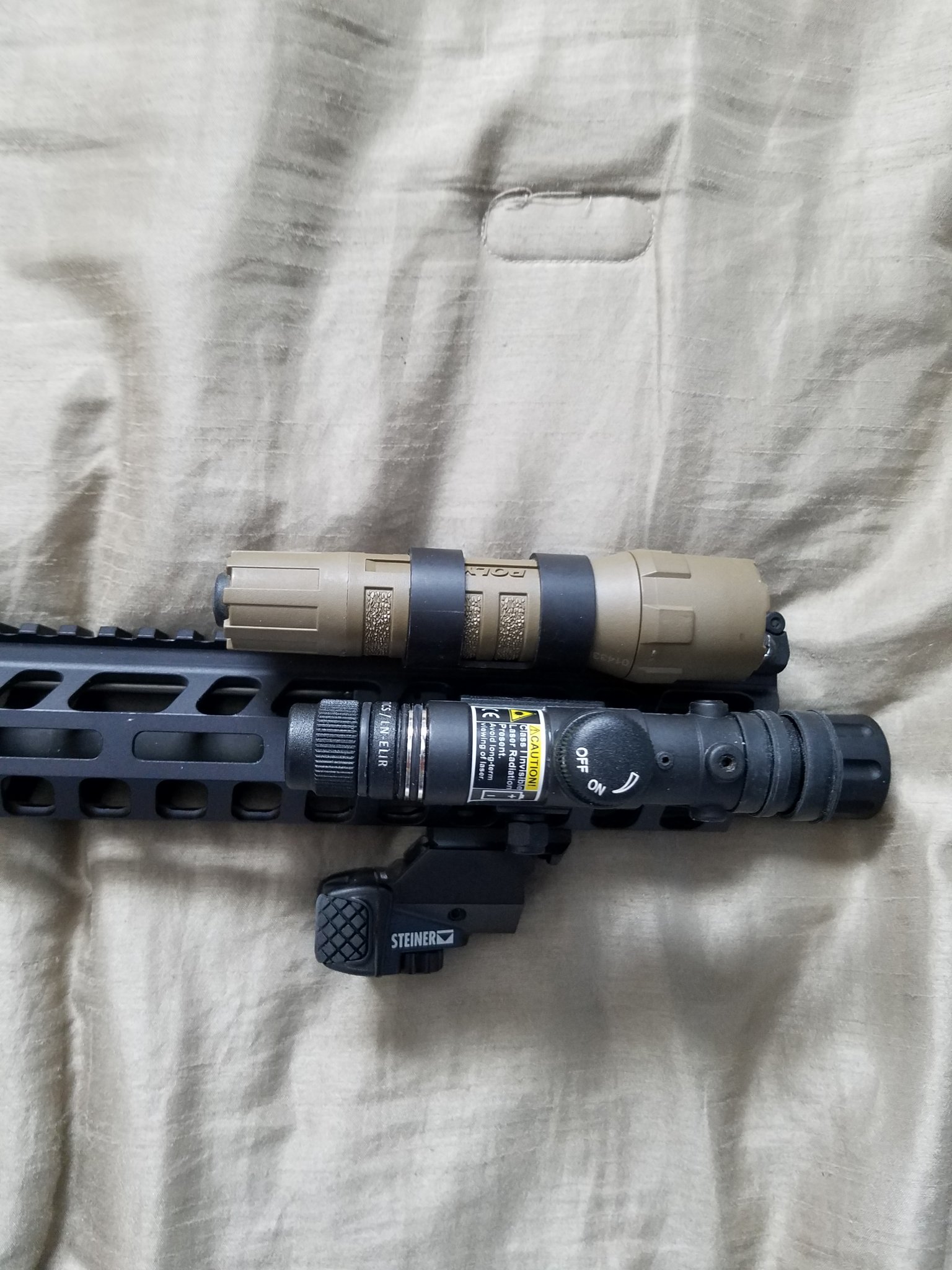

My 10.5 " bbl 556 pistol set up for coyotes..... it's kinda clunky looking, not real ergonomic with the Stiener TOR at 6 o'clock and with the m-lock to picatinny adapter, the Luna won't center on the pointer. The TOR is set with the Sig Romeo rds at 50 yds. I'm going to give it a try next week if POA and POI are in sync.
May swap TOR at 12w/light at 3 Luna at 6?
