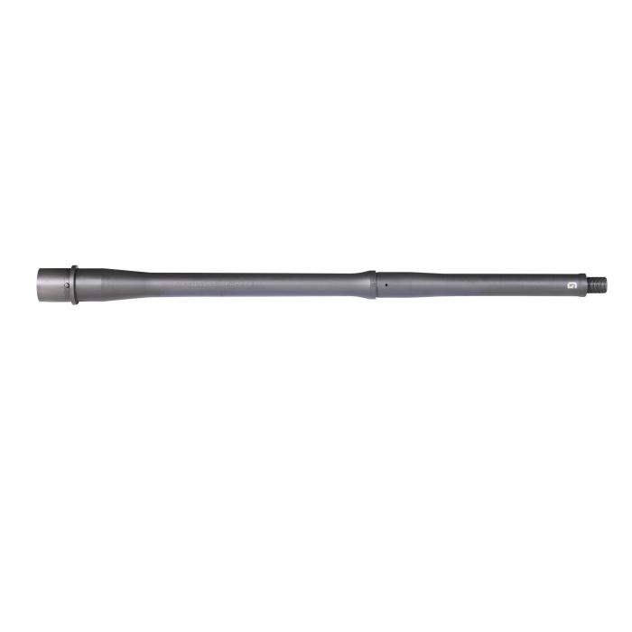

I’m gonna get flamed here, but Faxon pencil profile barrels shoot pretty well if you need a lightweight barrel and will keep it inside 100 yards or so. For a lightweight build upper, you’re probably not gonna find one much lighter for any given length, and at their price point it’s not a bad choice.
I’d SBR the lower and run a 9” or so 300 BLK barrel for shorter range stuff myself, but a pinned 13.9 (use a NOX or similar), or a pinned 14.5” 5.56 with almost any muzzle device and you’ll be gtg too.

If ultra lightweight, without going carbon fiber is the goal, pick a barrel with a .625 gas block journal.
I can't say that you won't get good results with a Faxon, but I can say that I had horrible results with Faxon. I don't know if it was due to improper or inadequate stress relieving or what, but mine had a serious wandering zero as the barrel heats up.
Another concern is barrel flex. A long skinny barrel may get you a pretty good point of impact shift going from suppressed to unsuppressed. I do, however, have a pencilish Ballistic Advantage Hanson 11.5 and shift hasn't been a problem.
