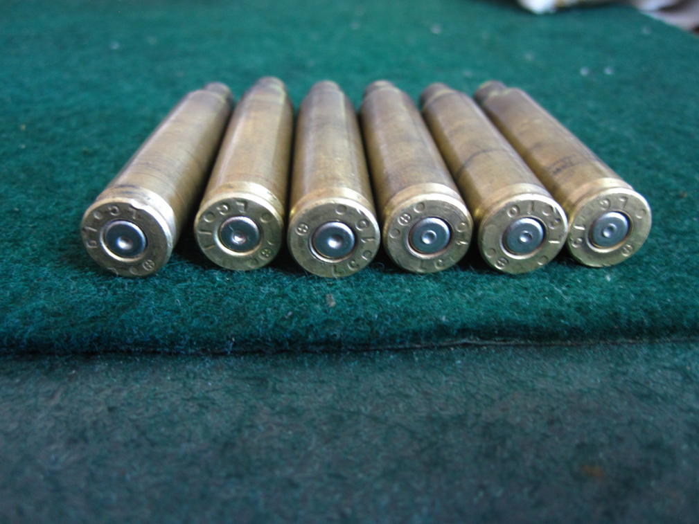

Thank you RollingThunder51. I appreciate the time with your assistance. Here is a photo of the rounds that are (maybe) being cooked on the right and the regular rounds on the left:
The primers on the right are slightly bulged and you can see firing pin cupping.
I will contact the manufacturer on Monday to discuss. I hope it is not round cook off.
