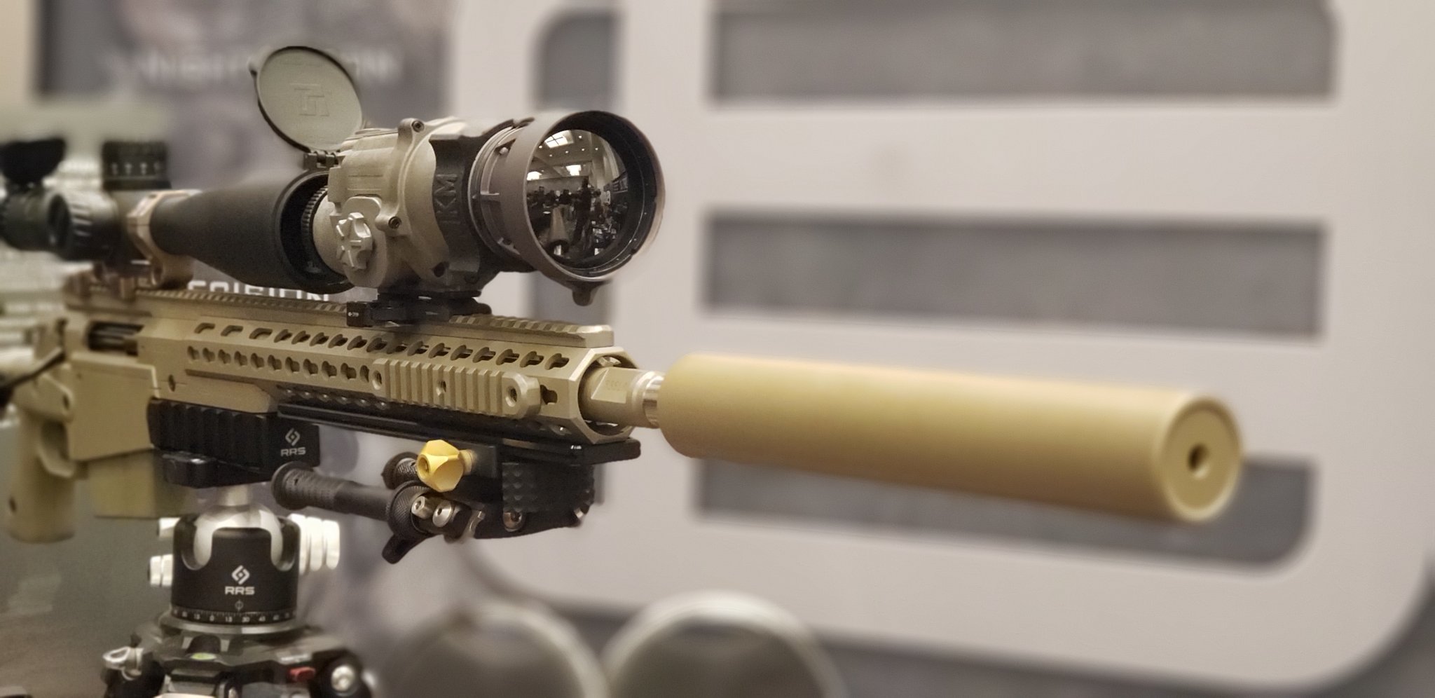

I am interested in hearing from anyone who has actual time behind a Lwts-lr..
....How the Lwts-lr performs in the field.
What day optic was tried in tandem with it, and did it hold zero on various optical
magnifications?
Cant seem to find anyone discussing this.

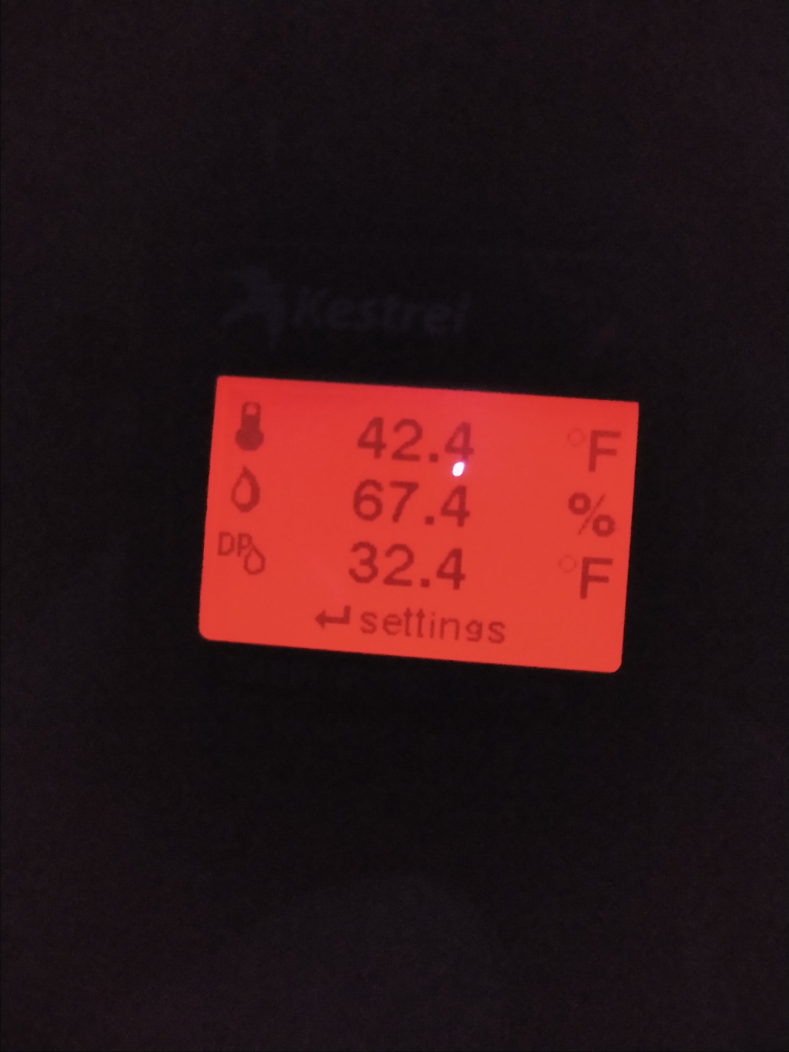

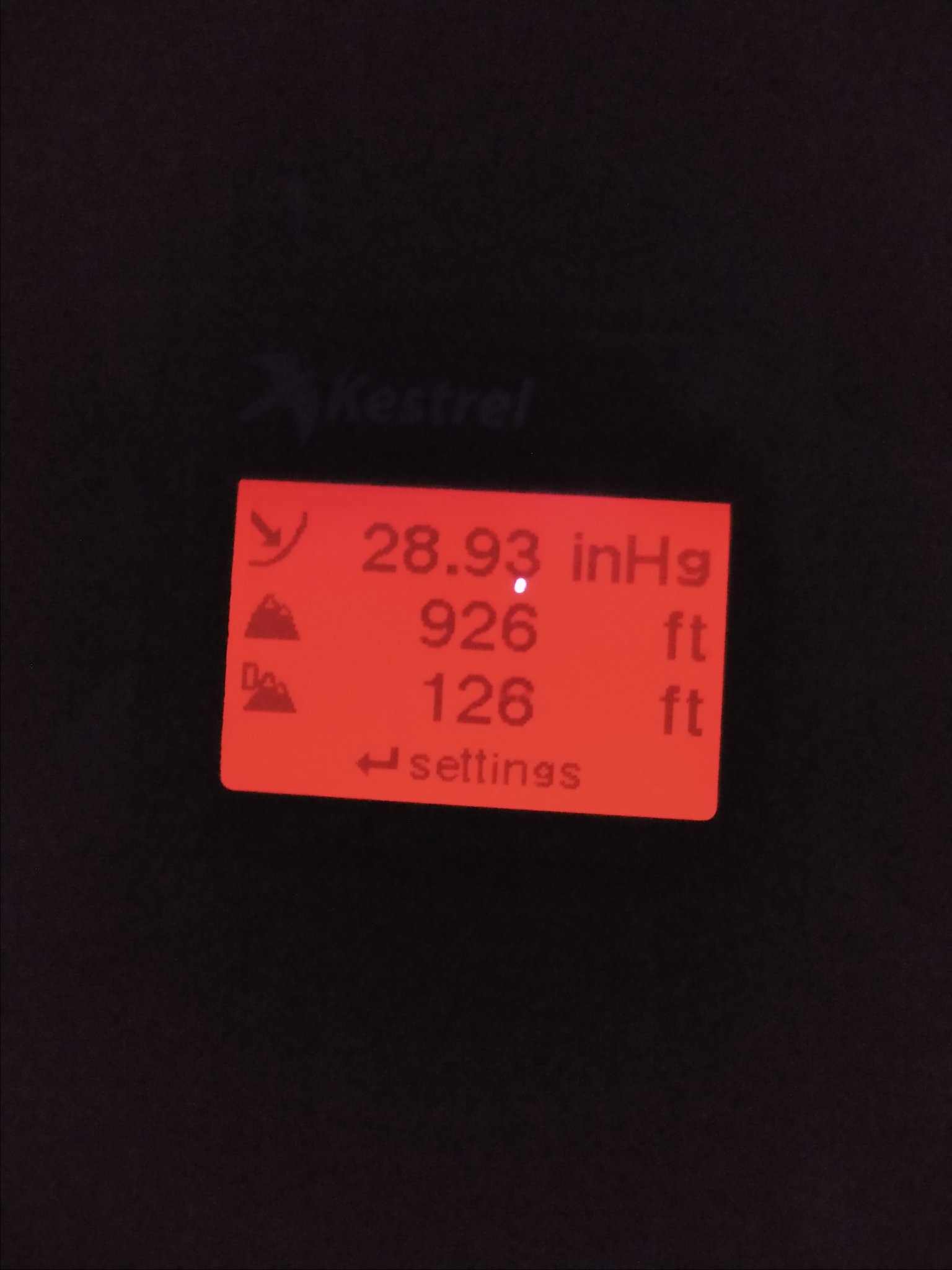

Conditions were Friday morning 0800 temp 75F,humidity 60%,wind 8 o’clock 5 to 7 mph, SP 29.45.
Gun was GAP 6.5 Creedmoore AR, 130 gr Berger AR, 43gr H4350, 2810fps.
Range 600yds 3.5mls, 750yds 5.05 mils,1000yds 8.5 mils. A little wind correction which progressed the further we went out. All stayed within a 10 in group.

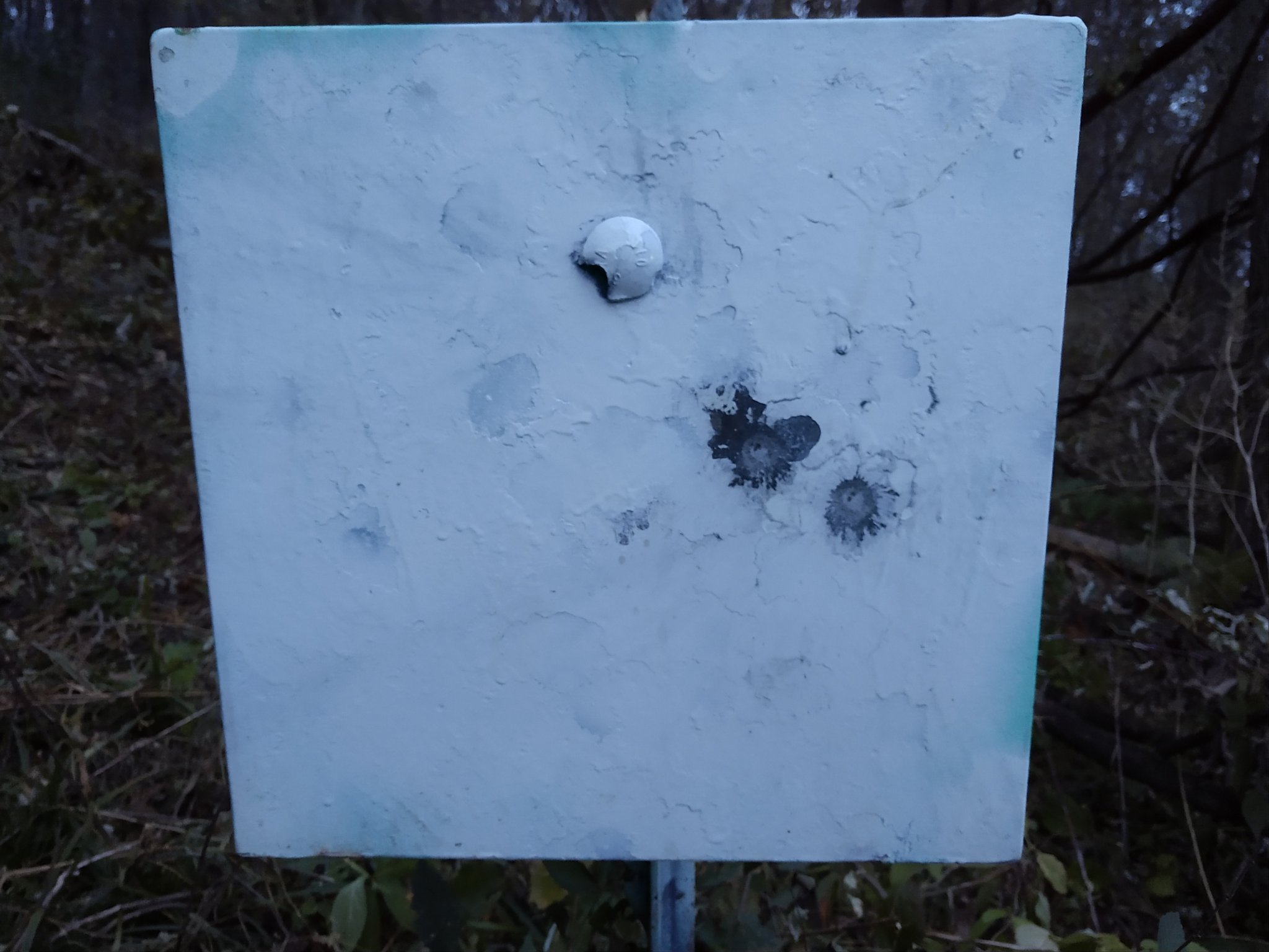

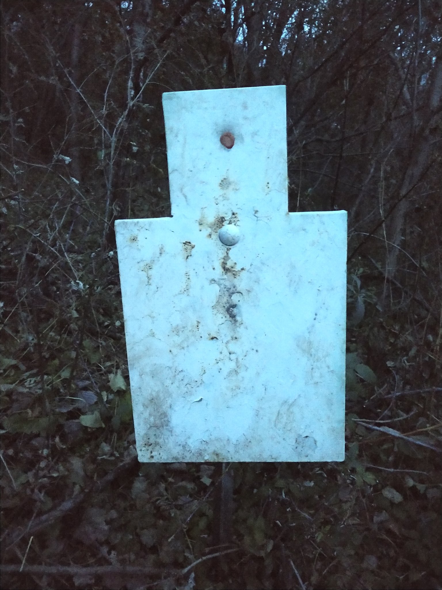

POI testing.
150 yard 4"steel (far right got heated)
Far left first shot --Day optic only (ZCO 420)
Far right second shot --with LWTS-LR in clipon mode
Then pulled clip-on off, took one shot at 12" steel @ 300 yards. Then placed clip-on back on and took second shot at same steel.

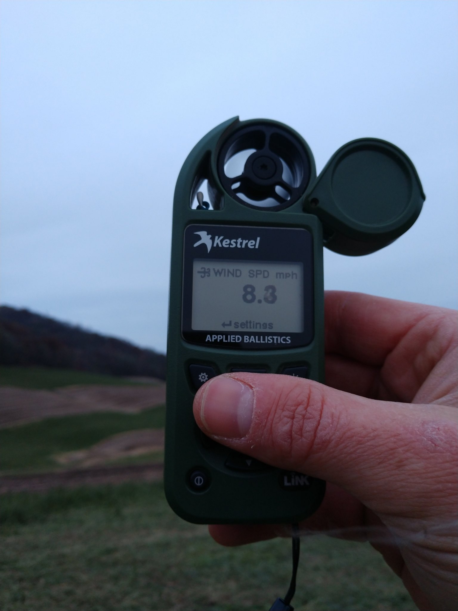

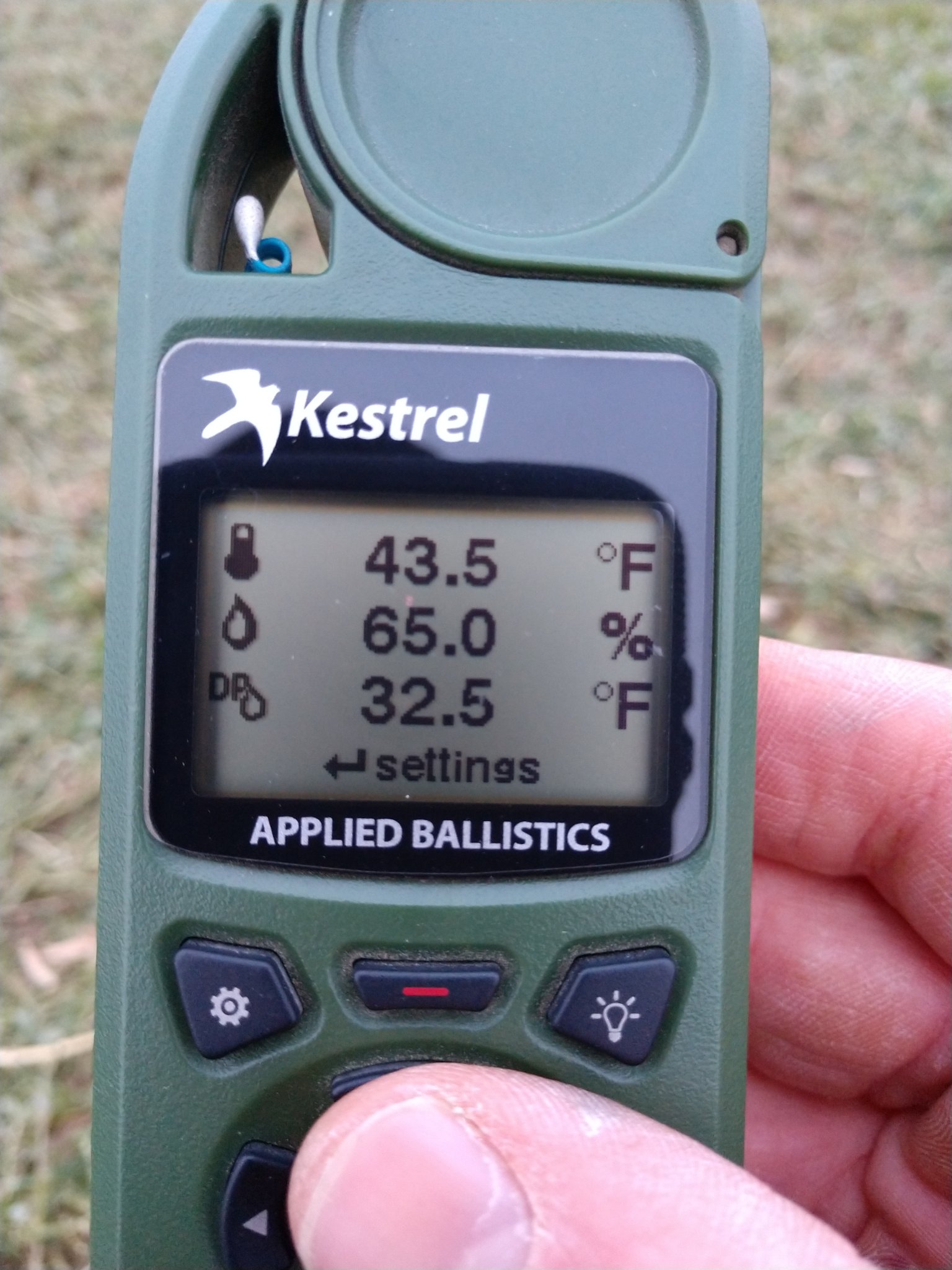

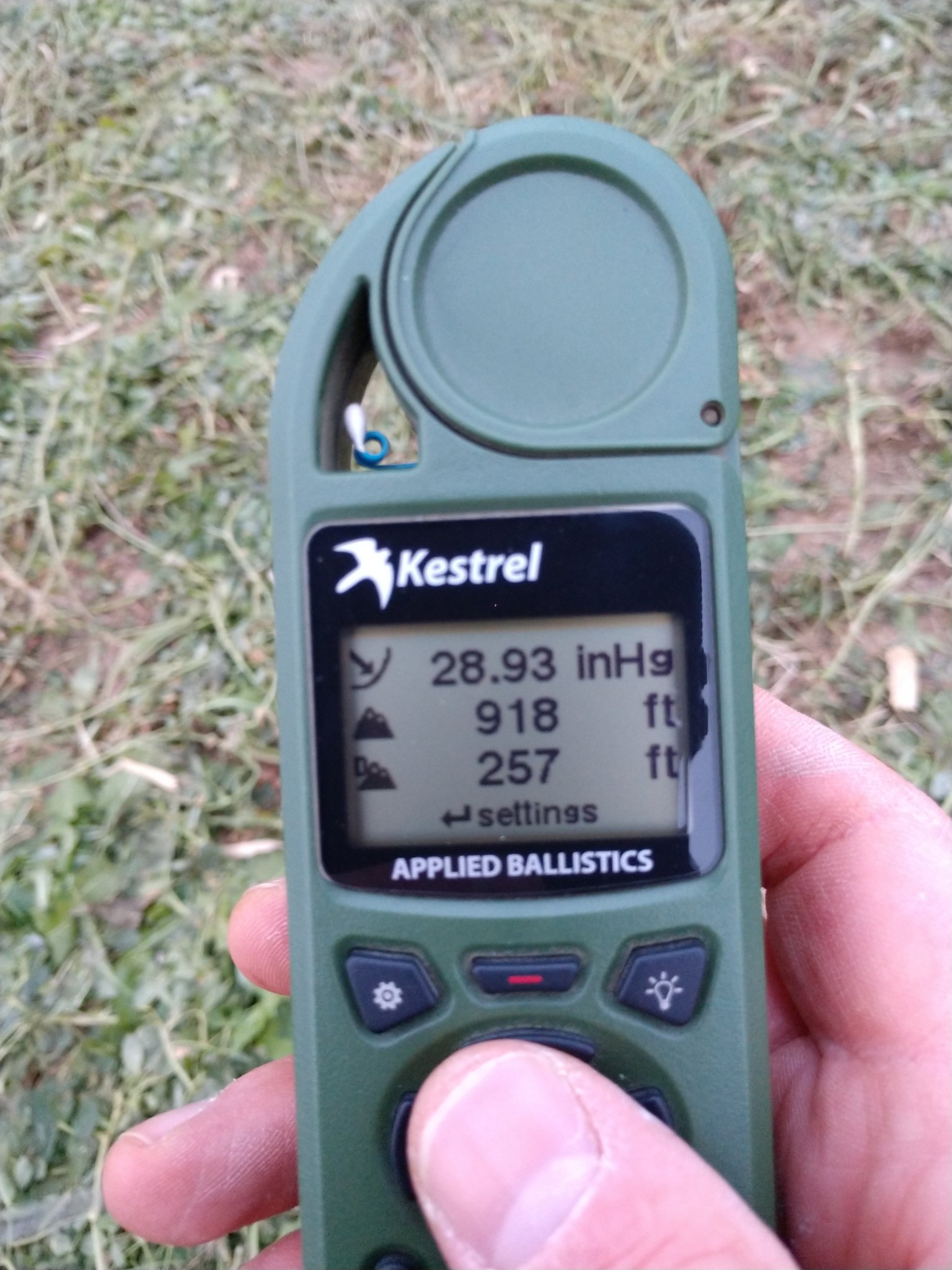

Conditions: Wind from 3 at 150yd and 2:30 at 300yd. See Kestrel for speed and atmosphere
Reactions: deersniper

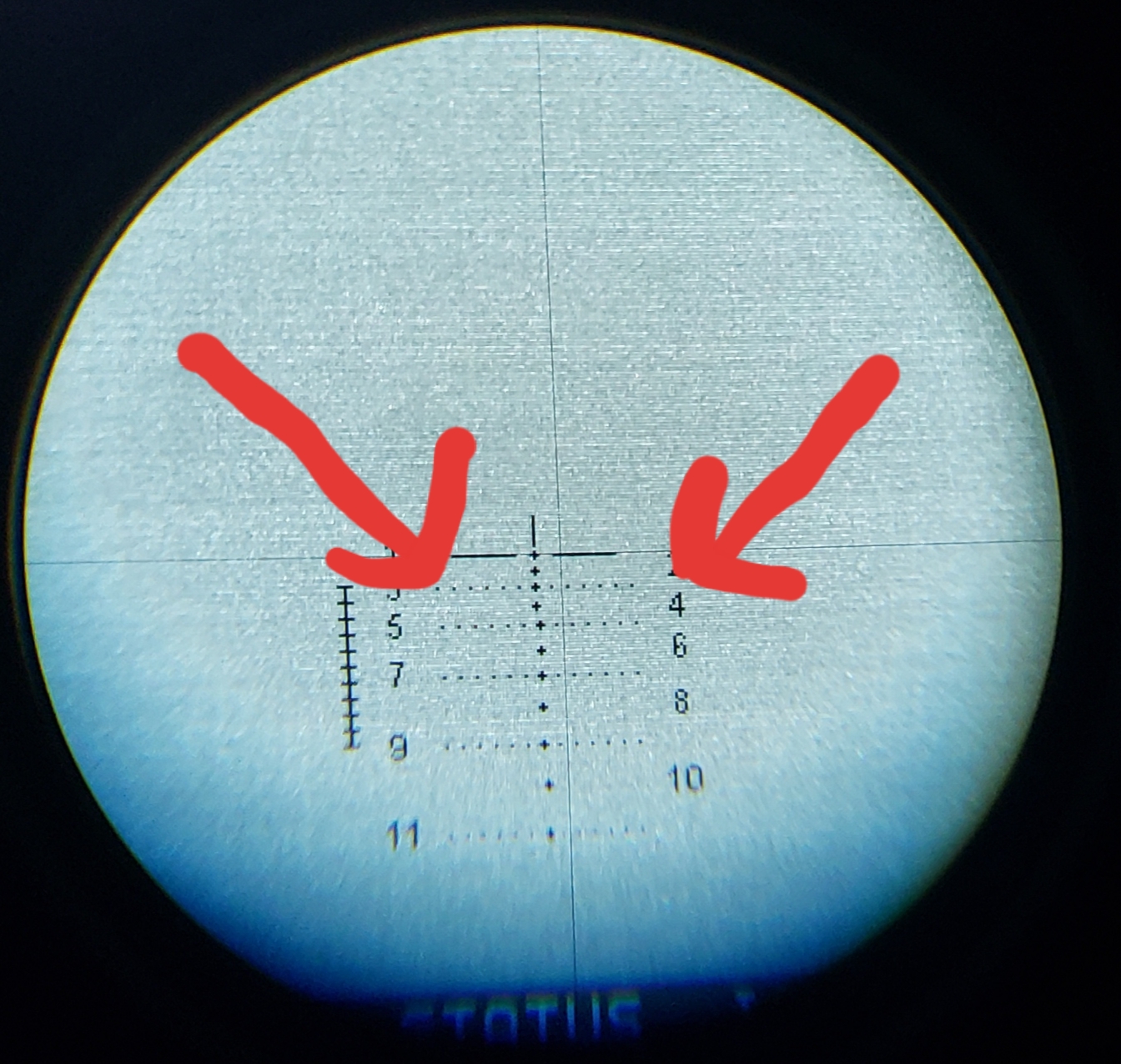

Do you have access to spec sheets for the standalone reticles? That’s show the distance between dots etc?
It’s a shame they are all bdc reticles. A simple mil reticle like mil c or even a mil dot would have been nice to include.
