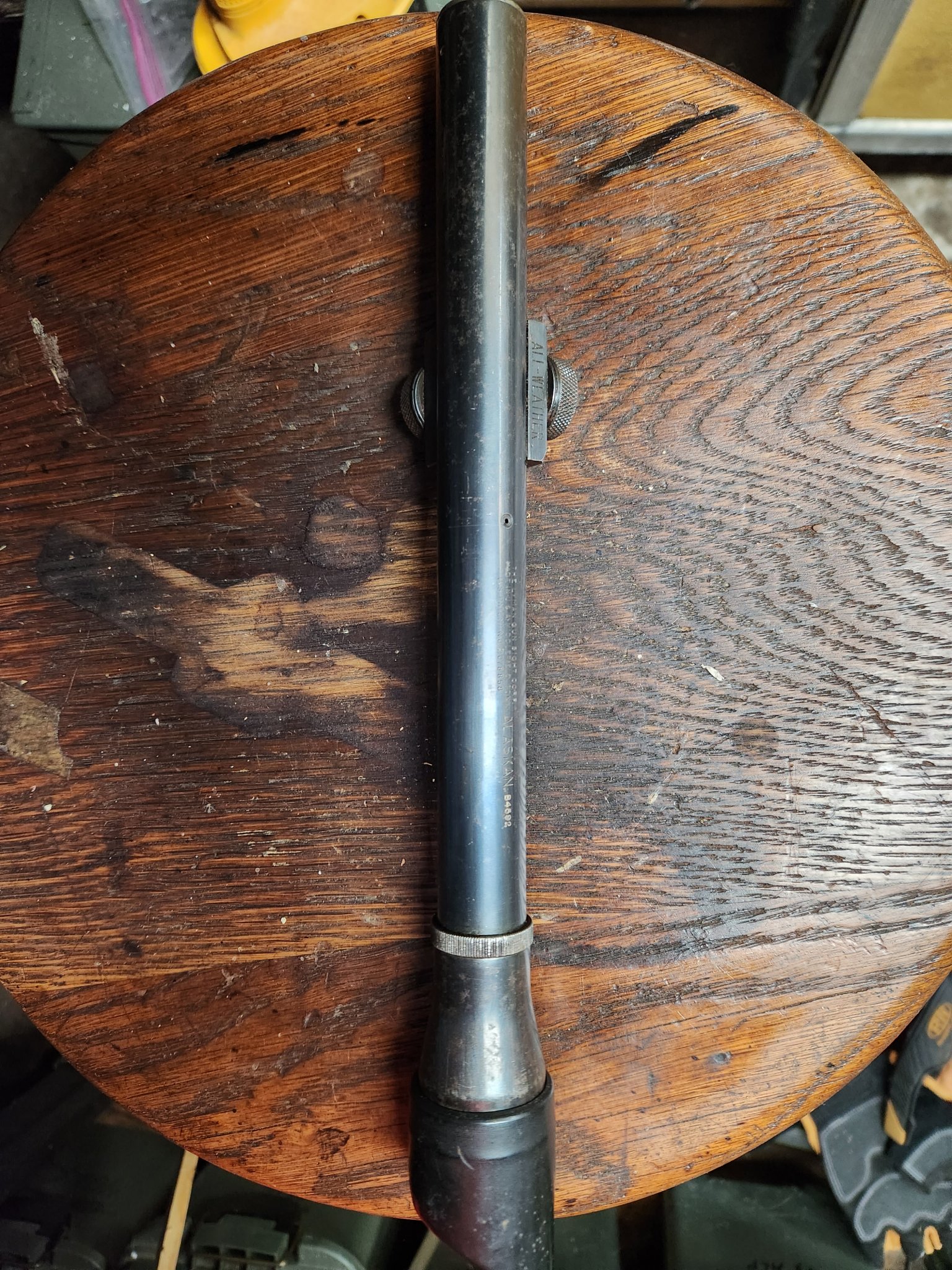

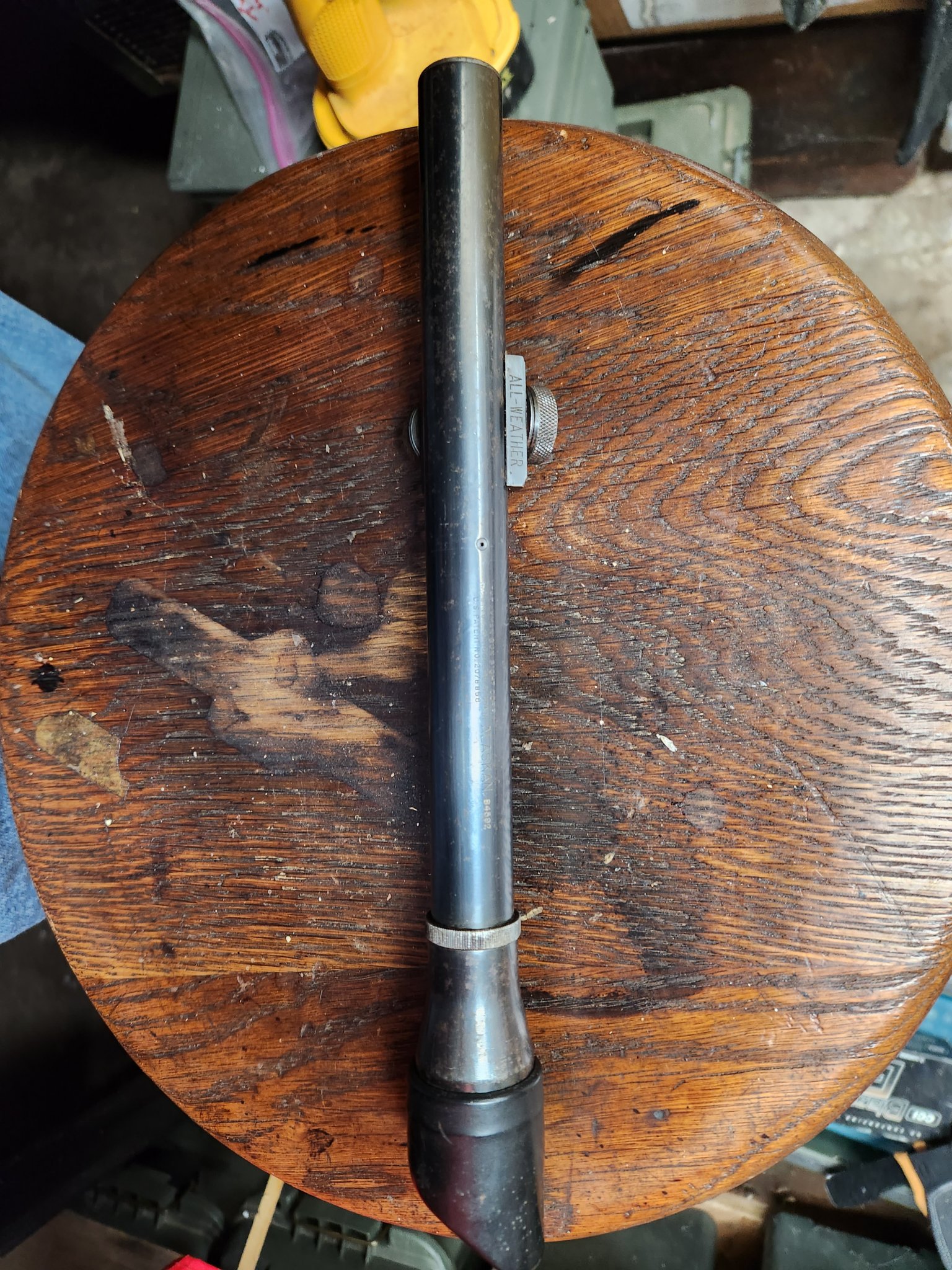

The other day I won an auction for Lyman Alaskan. It looked pretty rough in the pictures so I got it cheap.
When it got here the blueing was pretty freckled with rust. I started carefully cleaning it and found that instead of the serial number being 84592, it is B4592.
I remembered reading that the B Series Alaskans were military, but I don't find any markings to indicate that it is.
My question is; What is the REAL story on the B Series Alaskans?

It has a rubber eye shield on it that looks like it has seen LOTS of use
I'll try to get pictures tonight

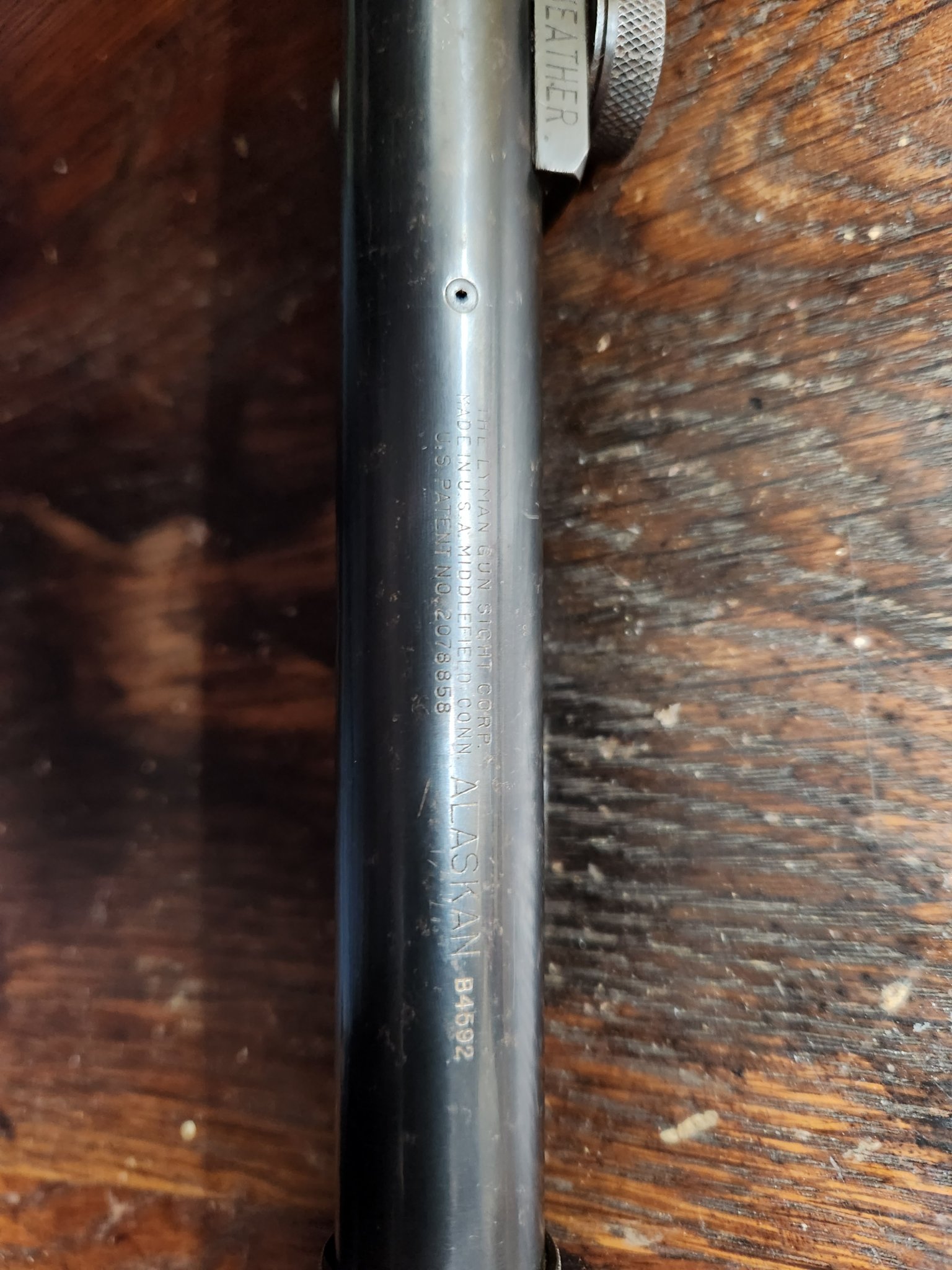

The B prefix Lyman Alaskan's are believed to have been procured under a military contract. They are discussed some in this thread, see post #8:
There is no question that at least part of them were procured under a military contract. Several have turned up with receipts through the CMP. I have one that has an Army Depot receipt.
The less resolved question is whether ALL of the B prefix scopes were part of the government contract, since there are higher serial numbers than the 3,000 shown in the letter. There could have been a second follow-on order that hasn't been found yet.
Observed serial numbers indicate about 5,000 B-prefix scopes.

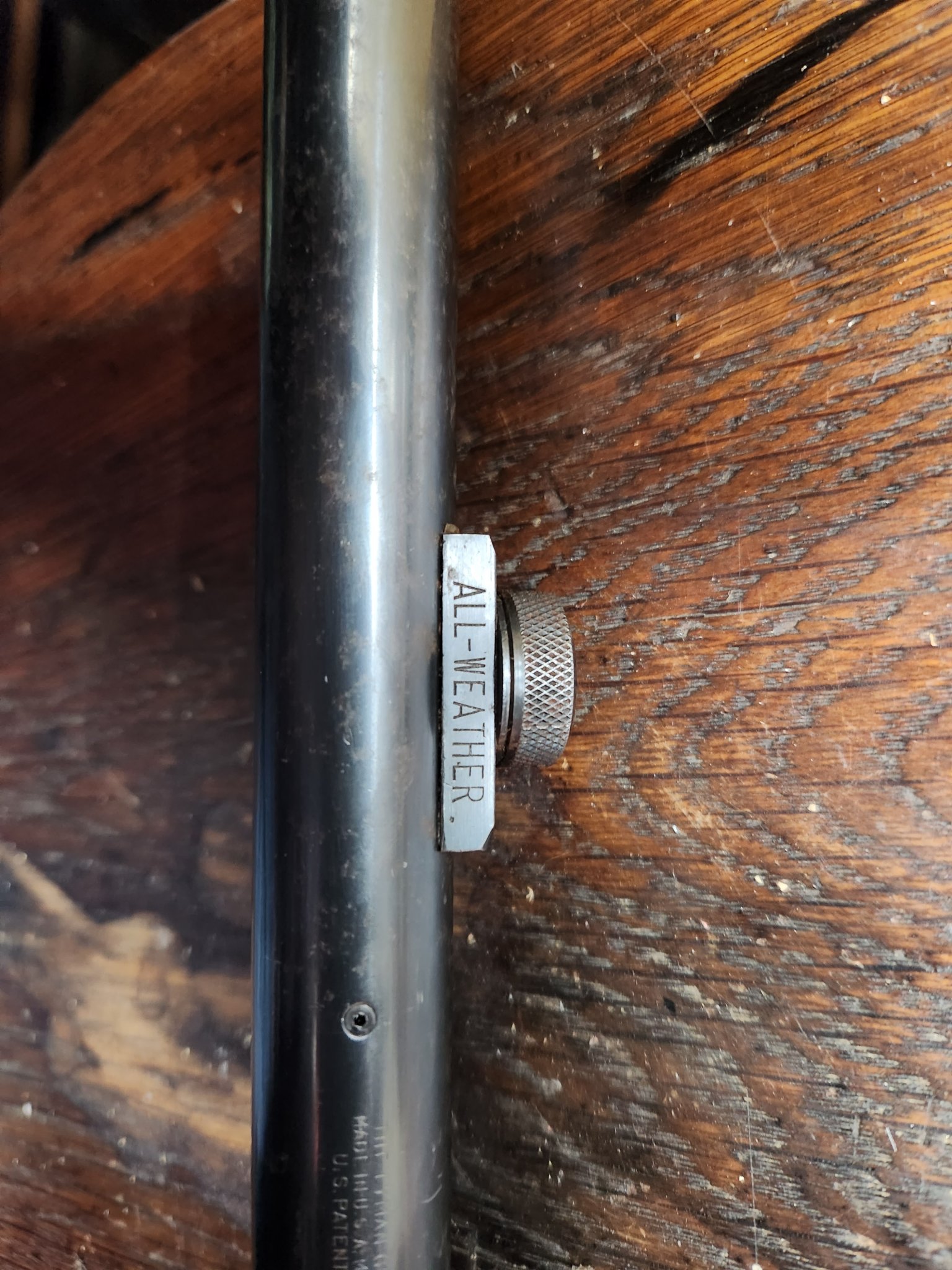

So what I'm understanding is that a "B" series with a serial number in such close proximity to a known sniper scope (4373) is pretty likely to be a military scope in spite of not having any military markings?
My opinion is that it's a commercial scope, probably made after 1951. (The military M82 scopes seem to have the sunshade as a standard item).
Why? It has the "ALL WEATHER" marking, which is associated with a commercial Lyman scope

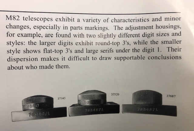

If one see's a "B" prefix Alaskan with "7634671" on the adjustment housing - it's definitely a military scope. (The other give away are 5-digit part numbers on the turret covers, as seen here, but I think that might be more of a 1944-45 production characteristic - but not 100% sure):
As noted in the 2004 GCA article "Alaskan scopes without military stamping and marked "ALL-WEATHER" on the adjustment housings are almost always commercial scope."
One caveat, I have seen one low number B-prefix Alaskan that lacked any markings on the adjustment body, and my guess is that one might have been a military scope given it had the sunshade, but its wasn't clear to it's origins. Perhaps they forgot to stamp it or perhaps it was an early scope from 1951 diverted to the military order (for 3k scopes). At least that is what the collector thought about his Alaskan scope that lacked any marking on the adjustment housing, but it had the correct sunshade and rubber eye piece. I can't recall what serial range it was, but I think it was an early B-prefix. Again, the markings (or lack there of) on that order from 1951 are a bit of a enigma, but in general. "ALL-WEATHER" = commercial scope.
(Note: The US Army doesn't like vendors to include "marketing" stuff on their items, like "ALL-WEATHER", hence Lyman removed that from military scopes. Also, the boxes the military scopes were shipped in also lacked all the fancy graphics/marketing of the commercial Lyman scopes - they were just plain brown boxes. I wish I would have taken a picture of that collector's original Lyman military shipping box, but he moved away from this area years ago.)
No. It's not proximity, but because numerous examples of B prefix Lyman Alaskan's have been observed with solid documentation of military ownership. They had to come into military ownership and the time period and number of scopes observed (based on serial number ranges) corresponds to the procurement mentioned in the 23 May 51 letter from the archives that cplnorton posted in the other thread I linked above.
The B prefix Lyman Alaskan's were exactly the same as the commercial scopes Lyman was producing at that time. They have cross hair reticles and typically do not have the military features like the sun shade, numbered parts, or M81/M82 nomenclature. The only difference from the commercial production at the time is the B prefix serial number range.
It is believed that the military accepted the B prefix Lyman Alaskan scopes without requiring the military features and nomenclature in order to expedite the procurement of additional scopes for the Korean War.
I have seen a few B prefix scopes with some military numbered parts. I believe those examples are due to exchange of parts while in use. Those are the exception rather than the typical.
As I noted in the reply to pitspitr, above, numerous examples of B prefix Lyman Alaskan's have been observed with solid documentation of military ownership. Those examples are found throughout the B prefix serial number range, so there are reasons to believe that all B prefix Lyman Alaskans were procured as part of the military contract referenced in the 23 May 51 letter from the archives that cplnorton posted in the other thread I linked above.

Thank you so much for your input. I believe that reading your back and forth cleared up my understanding of the military purchases of the Lyman Alaskan "B" Series.
What I hear you saying is that while it is quite possible that mine was a part of a military purchase there isn't any way to prove it conclusively. Therefore, IF or when I decide to sell it, I should just sell it as a Lyman Alaskan "B" Series and let the buyer decide what that means. In the meantime, I "bought the scope, not the story" and I should enjoy it for what it is, a good old scope that I bought cheap.

Correct. There is a very high probability that they were all part of the military purchase, but no conclusive link tying the B prefix Lyman Alaskan's directly to the order referenced in the documents. cplnorton has stated that he has found further documents that may provide further proof. See the link below:
