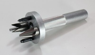

    I have the Lyman Case Prep Multi-Tool. I just took off the camfer and deburr parts and my drill holds them fine.
