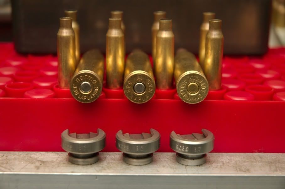

What brand of brass are you using? Norma and Lapua have different dimensions at the groove and require different shell holders. I can't speak to Jamesion, Hornady, or Pivi.

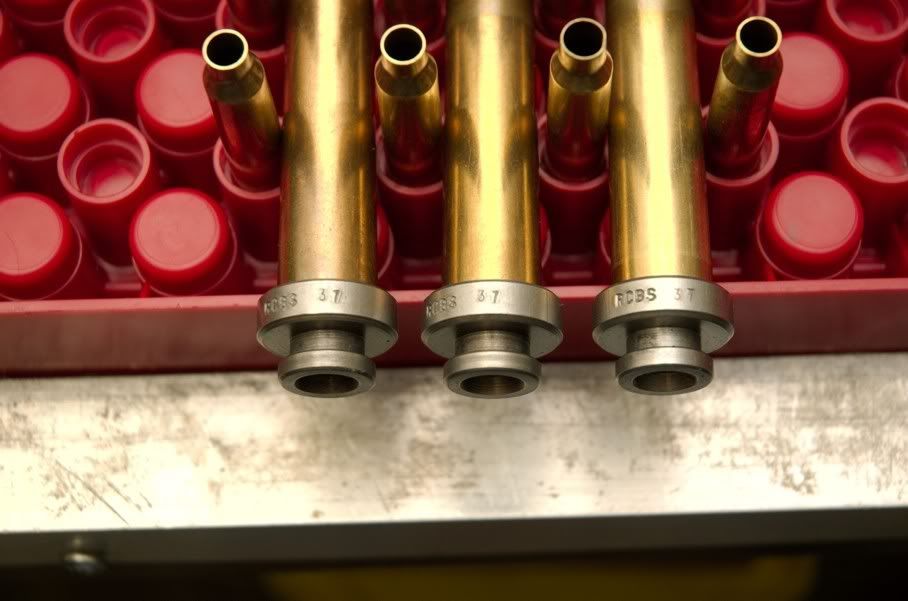

phreak, I have the RCBS #37 and the #14. RCBS says 37 is for Norma and 14 is for Lapua brass in 338.
BOTH don't seem to fit well.
I then got a Redding #35 and then I got another (one for the RCBS hand primer)
If you want to quit trying to find one that works and actually fits Lapua brand 338LM brass, then Redding is the way to go.
madd0c
Re: Lyman Shellholder for 338 Lapua Really tight?
Don't know what to tell you. The 37s work fine for me, casings slide right in with minimal play.
