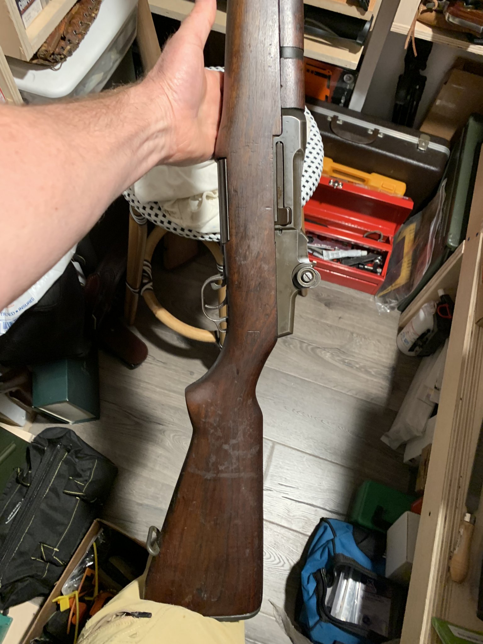

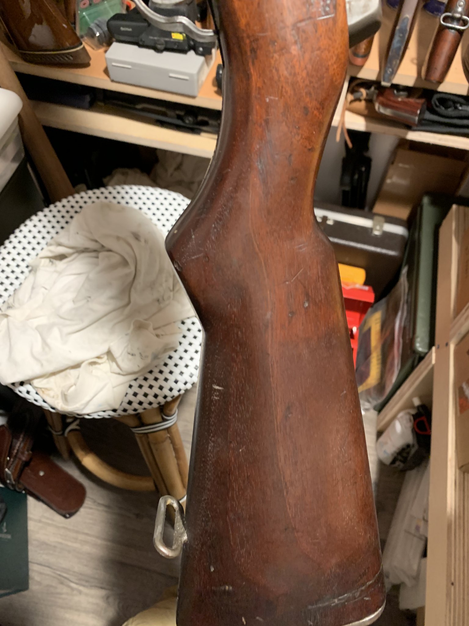

    After spending hours looking at M14 forum and the CMP forum on stock cleaning a finishing, I’ve come to the conclusion that’s there’s about as many different ideas as to how to do it correctly as there are on what exactly belongs in Texas chili ingredient wise. I have two M1 Garands I got from the CMP over 10 years ago that I’ve done nothing with. It’s time to change that. I just want to clean up the stocks the hit them with BLO or Tung, not strip them. Seems people use mineral spirits, naphtha, or a 50/50 mix of BLO or Tung and turpentine or mineral spirits for that.
    Looking at the pictures below, what do you all suggest? I’m leaning towards first wiping them down with naphtha then trying the 50/50 mix of BLO/turpentine.

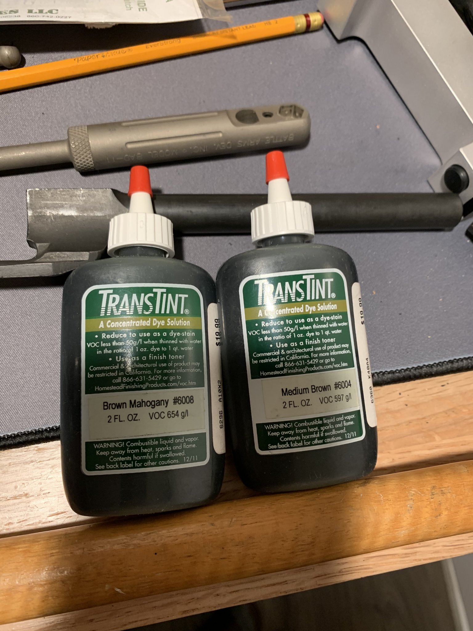

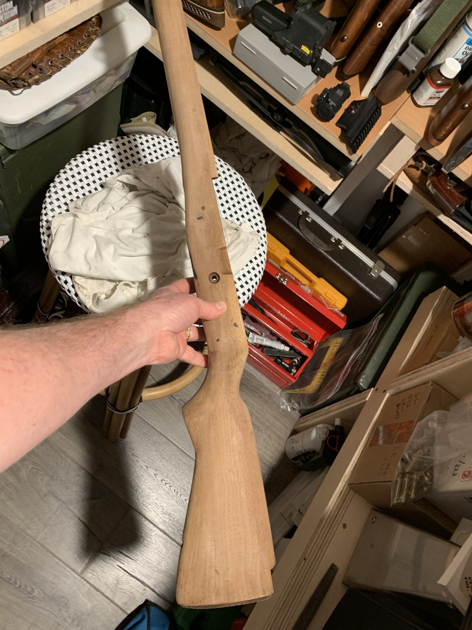

    The stripped M14 stock will need some stain. I have the two Transtint dyes I might mix with denatured alcohol and try in the barrel channel first. Seems about 90 drops of dye with a 1/4 cup of solvent for the mix. I’ll probably go with BLO or Tung after that. Tru-Oil, while more waterproof and durable, leaves too much gloss for me, even after steel wooling it.
    I would appreciate any thoughts, ideas, pictures, etc, especially if my proposed methods are flawed.

    The way I refinish military oil finished stocks is fairly simple and works well. It will make your wife happy because you will get to wash the bathtub afterwards and you might as well clean the rest of the bathroom while you are at it.
    You will need to take all of the metal off of the stock.
    Do not sand the wood at all.
    Run a tub of water as hot as you can stand to put your hands in. Soak the stock, then scrub it with a blue kitchen sponge and liquid dish soap, over and over. The amount of time it takes to do this depends on how much oil is in the wood. Sometimes it's really quick, sometimes not.
    Once you have all of the oil out of the wood, use a heat gun to steam the areas where dents or dings are to raise them. Let the stock air dry. Once the stock is dry use FFF steel wool to whisker it.
    The finish you put on depends on whether you want an original look and something glossy. If you want an original finish use BLO cut 50/50 with odorless mineral spirits. If you use straight BLO it will not soak into the wood very well and it takes forever to dry. You may have to apply 3 or 4 coats over a couple pf days. If you want to darken the wood add a very small amount of walnut colored penetrating stain to the BLO.

    90 drops of dye in 2 oz (1/4 cup) will be incredibly strong.
    I don’t know what you mean by you don’t want to strip it? I’m assuming you just want to wipe all the years of gunk off?
    What does the stripped stock look like when wet?
    I think @pmclaine prefers desert sand Krylon for his walnut stocks.
    Reactions: KYAggie
    I have no personal experience with this ratio, I got this ratio off the CMP forum from a post about 15 years ago. Thats why I posted this thread. What would you recommend?
    Yes, I just want to clean the Garand stocks up, I do not want to mess up the stain.
    Lol, I knew you were going to ask this. I don’t know, I’ll have to test it. I won’t be home until late Thursday night, so I’ll have to do it this weekend.

    The dye is strong. In 2 oz of solvent you’d be best to start with 5 drops and work up. Test often. I don’t even know if there are 90 drops in a bottle of dye, lol.
    I’d also use distilled water as the carrier. It will raise grain, but a 3m pad will cut it back without impacting the dye or dimensions. Write down your ratios as you go so you can scale up once you find the color you like.
    Also depends on what coloration you’re looking for. The world is your oyster with dyes. You can make it blue if you want, lol.
    Reactions: KYAggie
    Everclear and denatured alcohol are ok, and won’t raise grain, but flash off really fast. I prefer water. You can adjust color better/easier because it will actually sit on it for longer.
    Experiment and see which you prefer.
    A base coat I use for walnut is dye made from Osage Orange. It’s a really good tertiary yellow-orange, and not overpowering to either color. When using kiln dried walnut I’ll put a wash coat of that down and let it sit a minute before wiping. Then a wash coat of dark brown to near black to accentuate the more porous grain, but wipe it off pretty quick to prevent a full grain reversal. Then you can hit it with a brown glaze. I find the water/alcohol soluble dyes compatible with top coats of oil based stains and finishes as long as you let them fully dry.

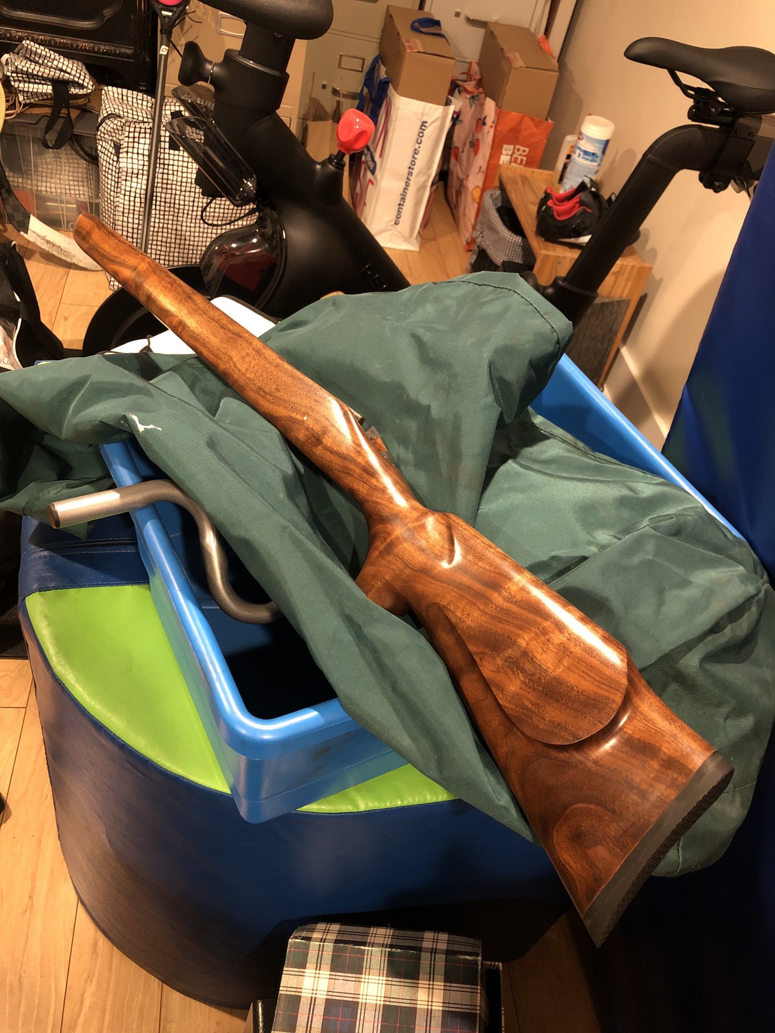

    This was a special it doesn’t count. I sanded the crap out of it down to jewelers rouge. It’s pure tung oil…
    This was the first coat or so with 450 or so grit paper applying the oil….

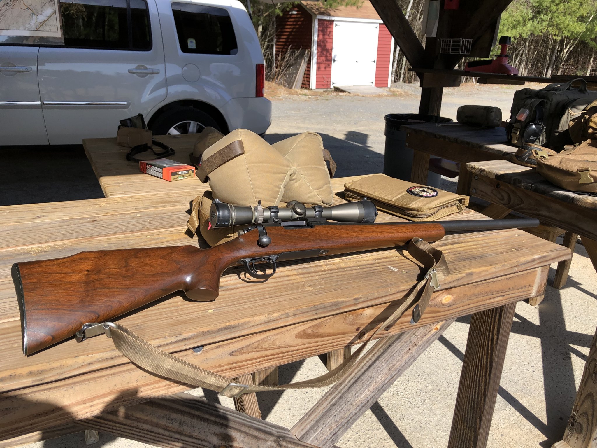

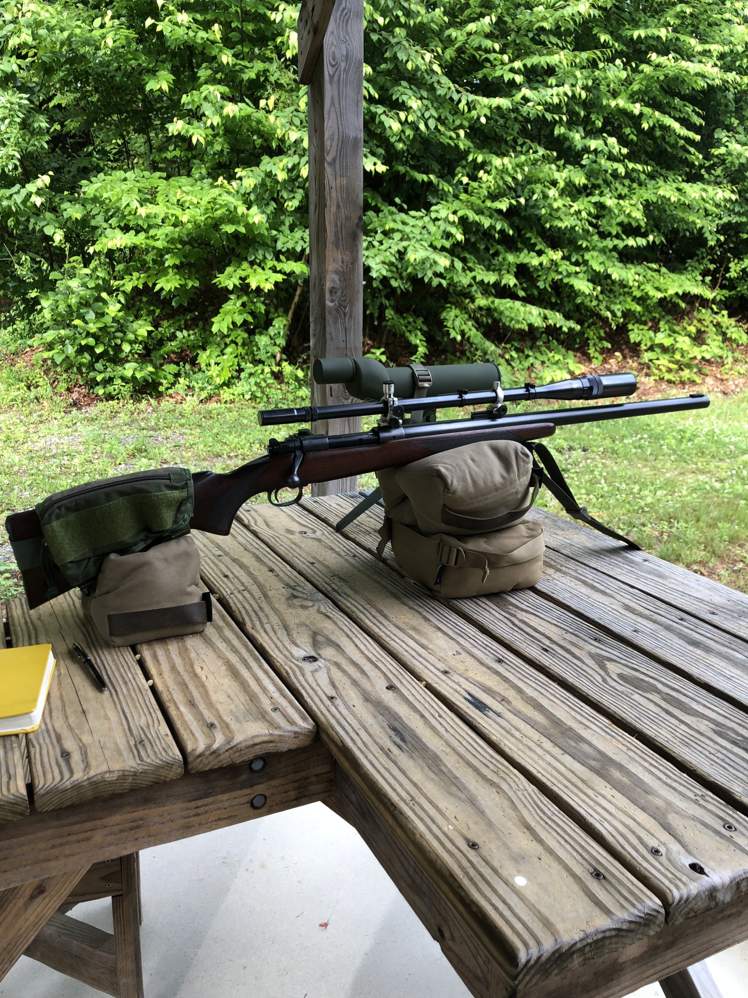

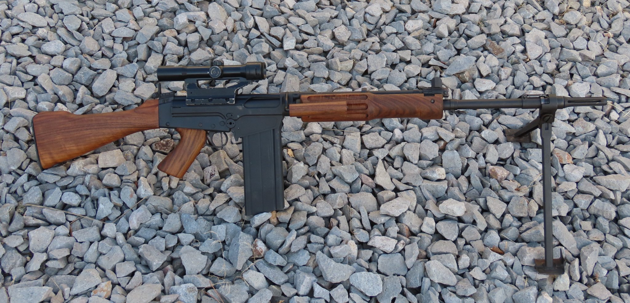

    My M70 tgat gets only linseed oil…
    My M40 that I did with pure tung oil, is about 7-8 years old and has had a few coats of oil…

    Those stocks look great! How do you decide which to use between raw linseed oil and pure tung? Also, my understanding with both of those is that the risk of spontaneous combustion, while still present, is less because they do not contain any driers which create heat more rapidly in BLO and Tung mixes due to the shortened drying time. Raw linseed and pure tung take much longer to dry.
    If you have a stock that is older like your Garand and you add linseed it will just feed the wood and the color should remain as is.
    On stocks that were stripped and fresh....the linseed can look dark and will take time to mellow and turn red.
    My .223 caliber M40 is cold pressed linseed and it started real dark, but is now turning redder and mellowing....there are pictures in the vintage section search ".223 M40".
    Older rifles you can use the oils interchangeably. Tung oil is slightly more weather protectant.
    For the last rifle I did it had a lot of grain so I used the Tung oil and wanted to see the grain. Tung oil wont go as dark at the start.
