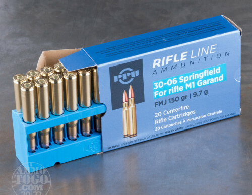

    There's a lot of discussion about bent op rods and using ammo that is specifically for the garand which is why I'm asking.
    If you shoot that PPU Garand ammo you will be fine.
