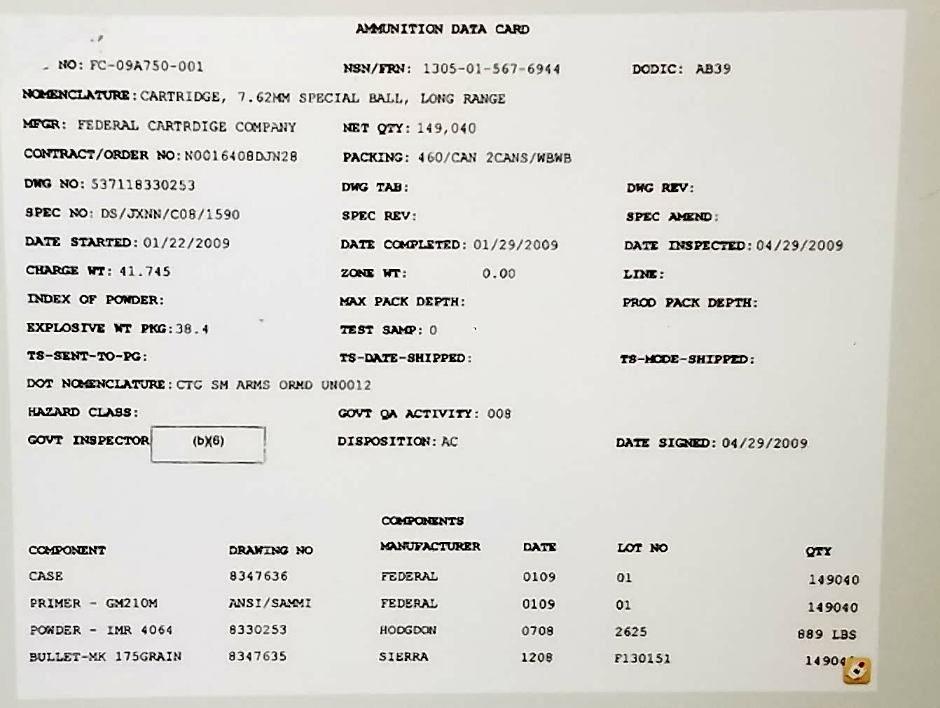

Mk 316 Mod 0 is 41.75gr according to the spec sheet, but a mate of mine pulled a bullet for me and found 43gr in there?

What "spec sheet" are you referencing?
The Alpha Bravo uses a low flash, low temp sensitivity powder. (Not an off the shelf powder) I believe it is sourced from General Dynamics / St. Marks out of Florida
Regarding the M118LR, there has been more than one iteration of it with slight tweaks but all still the same basic performance specs and definitely not in the same league as AB39.
There are no branch specific variants of M118LR although some branches/units have gotten screwed over by getting tons of one lot and not being allowed to move to anything different until their existing inventory was depleted which could take years.
To reiterate what Terry said above and I quote....
"The powder used in the AB ammo isn't available to the general public."
I've asked the question directly as we make the ammunition test barrels most of the time.

So as some have pointed out.... you have variables.
One is the ammo and lot to lot variations whatever those all are. Again the powder they might be using might not be available to you from the commercial market.
I've seen and have chronographed box ammo for 20 rounds that had extra velocity spreads of 60+ fps. Even seeing up to a 100fps is possible. Keep in mind...the barrel is a variable..... keep reading....
Then you have barrel variations. The ammo tested and being loaded is being tested in a ammunition test barrel. Those spec's for the barrel are held pretty good. I know...we make the test barrels.
Then you have the barrel that's on your gun and or what is being put on the spec. sniper rifles etc....what tolerance and spec's that that given barrel maker and or factory like Remington is making and holding they're dimensions to....is another variable. I can pretty much guarantee your going to see a large variable here vs the ammunition test barrels. Not just bore and groove dimensions but chamber dimensions. Yes there are min spec. chambers and what is called production spec chambers which can be +.002" bigger over Saami min spec.
Here is an example of some test data on 308win box match ammo. These are all 10 shot groups for 100 rounds fired out of an ammunition pressure test barrel that we made for the ammo maker....these are SD numbers per 10 rounds.
SD = 17, 10, 11, 19, 17, 16, 13, 15, 18, and 13. That's a average SD of 14.9. So your probably looking at an extreme spread average of velocity or about 30fps or a tad more than that. For box match ammo....it doesn't get any better than that most of the time. Keep in mind a 5 shot group for an average SD is going to be different than a 10 shot group let alone a 100 shots fired.
To start seeing a standard deviation under 10 your extreme spread in velocities are going to have be be under 20fps for a given group.
So not only is a barrel a variable with the chamber etc....but...
You also have to consider if the brass is new/virgin brass vs once fired brass. When you are checking velocities. Usually once fired brass will result in lower SDs. Not all the time but usually.
And.... is the barrel clean? When are you cleaning it in between the number of rounds fired? How good are you cleaning it?
