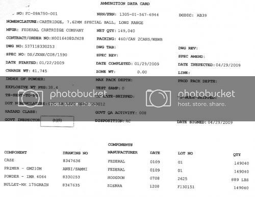

Got this from my buddy a few days ago...thought you guys might want to see it
Reactions: reubenski
Re: m118LR deadringer
<div class="ubbcode-block"><div class="ubbcode-header">Originally Posted By: Oldsmobiler</div><div class="ubbcode-body">Got this from my buddy a few days ago...thought you guys might want to see it
</div></div>
NICE!!!
The data sheet is for Mark 316.
M118LR is made at Lake City Army Ammunition Plant for the Army and uses Reloader 15. Mark 316 is loaded at Federal Anoka for USSOCOM with IMR 4064.
Same 175-grain Sierra Match King but different assembly lines, different powders, and different quality control.
