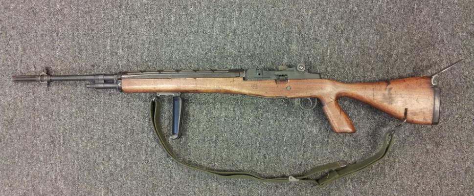

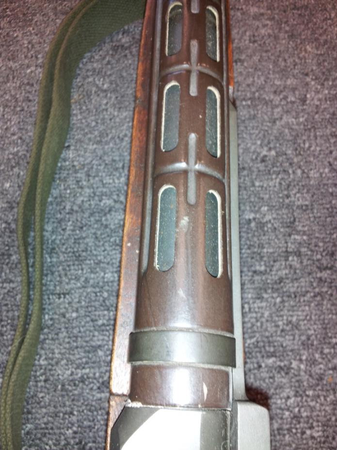

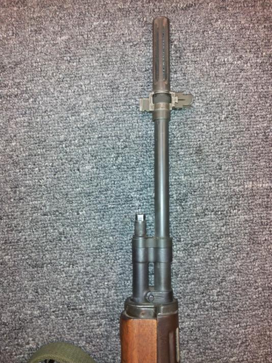

Hi guys, new to the forum, from Greenville, SC. Been collecting military weapons for years, and recently opened a shop here in town. Looking for a little help here.
This is now mine, came into the shop today. I have never owned an M14 before, actually first time I have seen one !!! Not exactly sure what I have either, so help me out here guys. Came with several boxes of ammo, 3 mags, 3 handguards, and a bayonet with markings on the blade I have not seen before either.
Help me out with some comments please, this rifle may be a keeper.

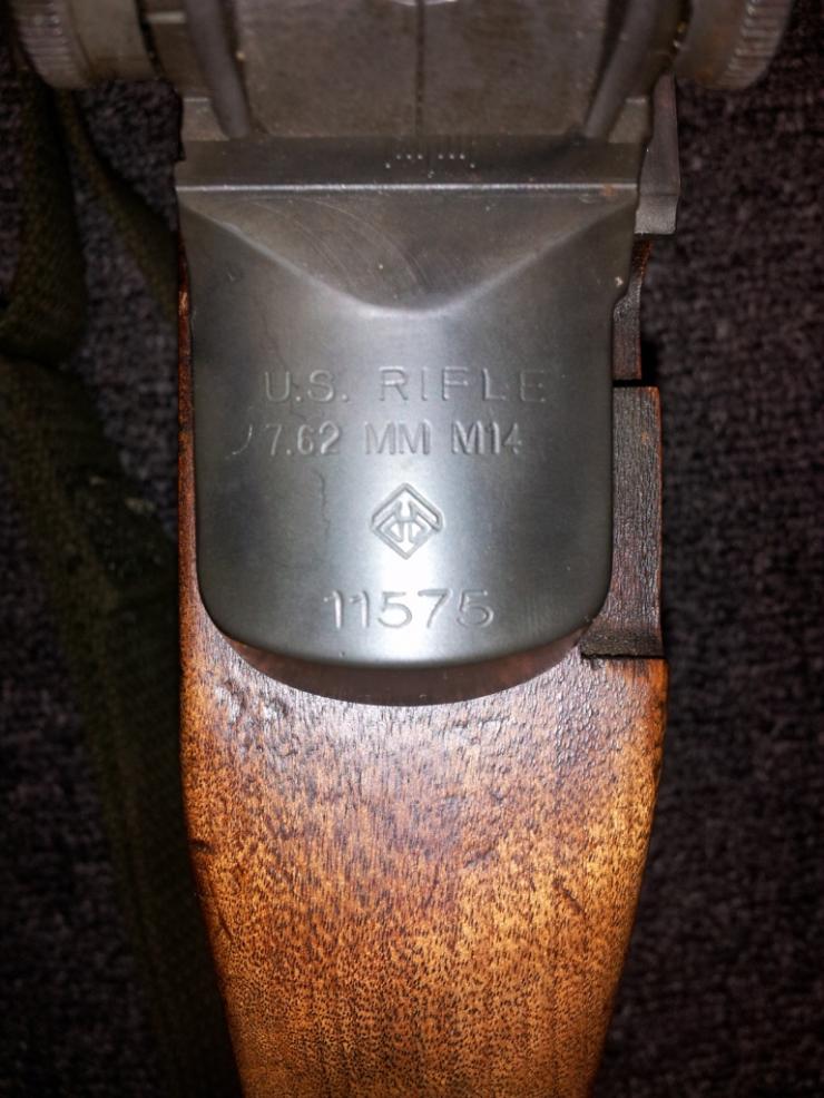

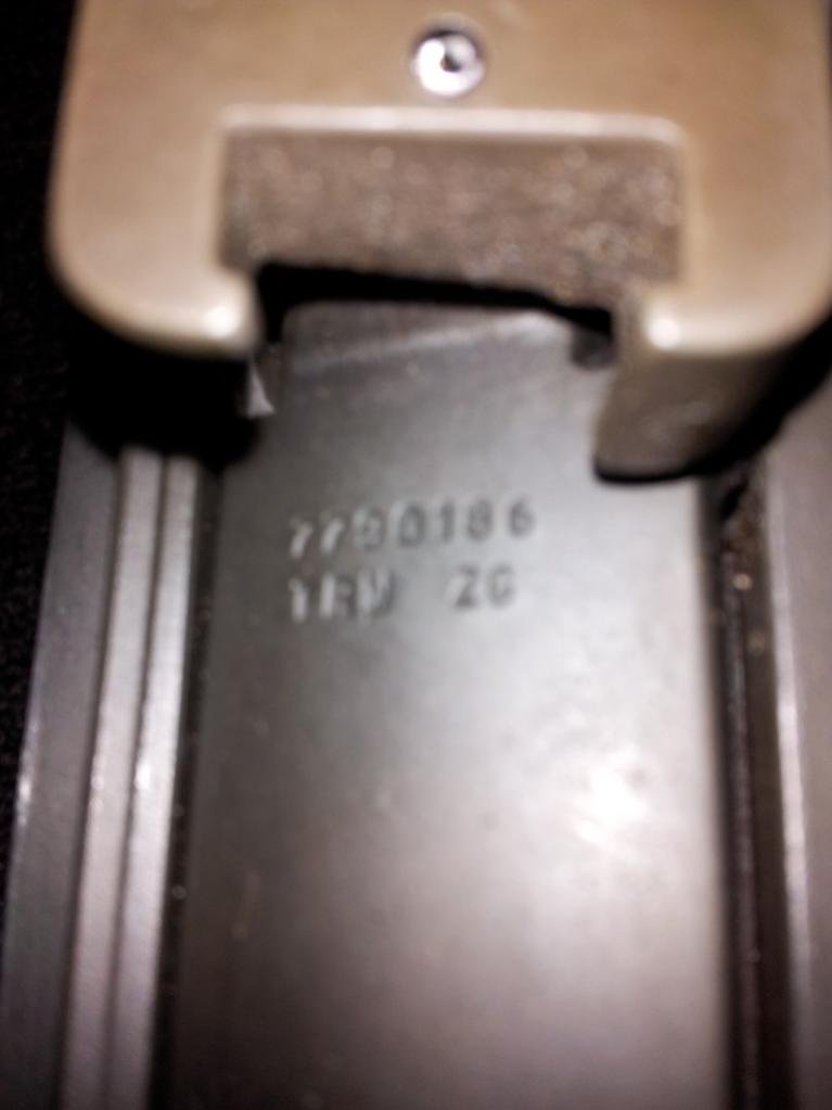

Nice! What do the marks on the receiver heel say? The barrel marks are visible after you lock the oprod back. The trigger group has marks as well. Pull oprod back to make sure the hammer is reset. To pull the trigger group out pull the trigger guard up and out toward the barrel, it swings. Then lift up. Is it a class 3?

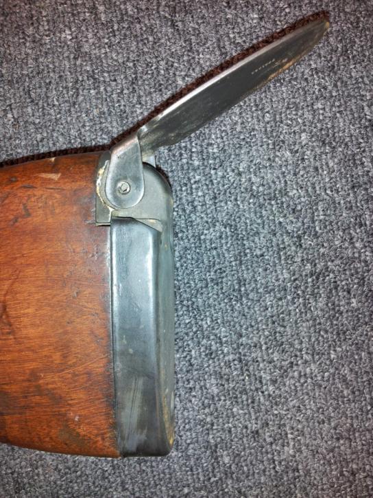

From the pictures you have an E2 version, with the correct butt pad pistol grip and forward grip.
The Big question is what receiver is this built on? Can you supply a picture of the receiver?
If you are concerned cover the last three digits when photographing. Not only is the manufacture
of the receiver vital to the price, but also S/N range.

From the pictures, you have a very nice piece. As my screen name suggests, I know a little bit about the M1A.
The stock alone is worth a couple of hundred bucks. It is an M14E2 stock, one of the versions that was developed to help with recoil under fully automatic firing and is also better suited to shooting in general due to the elevated stock comb. The stock in the picture is particularly valuable because it has all of the hardware, although it does look like it has seen use.
Many of the remaining M14E2 stocks are missing pieces of the front grip, so you have hit a jackpot on that one. You could easily replace the stock with a wood stock or a fiberglass GI stock and sell the M14E2 separately for a nice profit.
Your flash hider still has a bayonet lug, which is also a plus. This means it is a real USGI part. The vented hand guards are nice, but they were known to crack at times and they will allow a bit more mirage to rise off the barrel due to heat more easily escaping the area. Not all M1A's have vented hand guards, and I have never installed any.
If you are interested in adding an immaculate and finely refinished stock, PM me. I have a friend who is an FFL and also refinishes stocks for the M14/M1A and I would love to put you guys in touch. You would gasp at the quality of his work.
In summary, you may also wish to not sell that rifle. In my opinion, it is the finest battle rifle in existence. If you do sell it, go shoot it first and I think you will see what I mean. They are expensive for a reason - they are accurate to about 1-1.5 MOA out of the box, and with a little tweaking, they can become sub-minute rifles.
I would forgo any modifications such as bedding to the stock. M14's are notorious for eating their bedding and the bedding can require frequent touch ups every thousand rounds or so. Also, you would want to keep that stock in really good condition because they are sought after by collectors, especially with all the hardware.
If that were mine, I would try very hard to keep it.

Go to M14 Forum - M14 Forum for M14 M1A Rifles, everything you could ever want to know is there. Again you have an Arms corps receiver. I had one that was fantastic, some have issues with them. Get a smith that knows the m14 or m1 to look at it first before you try to shoot it. The m14/m1 garand have specific idiosyncrasies that if not looked at specifically could result in injury or at least a blown up rifle. Watch this video on how to disassemble:

God he posted a pic of the heel like I asked which shows an ARMSCORPS receiver which is semi only. Also in the pic you can see there is no disconnect link, and only sai calls their clone m1a. Every other company making a clone receiver calls it m14. Put the tin foil hats away and like our parents told us if you can't say anything nice get the f out! If you know nothing about m14s and an armscorps came in with its heel marked "m14" you wouldn't know that there myriad of copies, most casual gun guys don't even know that the real one is class 3.

1. Armscorp M14
2. After market
3. Depending the task yes and no
4. Can't help you with that at all

Most of your questions have already been answered.
Civilian receiver
Aftermarket receiver, USGI bolt, and I'll hazard a guess that the other major parts are USGI.
Do not do anything to that stock, not any part of it. That is what makes this piece interesting. Otherwise it's just another Armscorp with USGI parts.
Take it to a M14 smith. Some Armscorp have had problems.
Go to m14forum.com
Value is going to be dependent upon the condition. Armscorp aren't the most popular receivers, but not the worst either.
